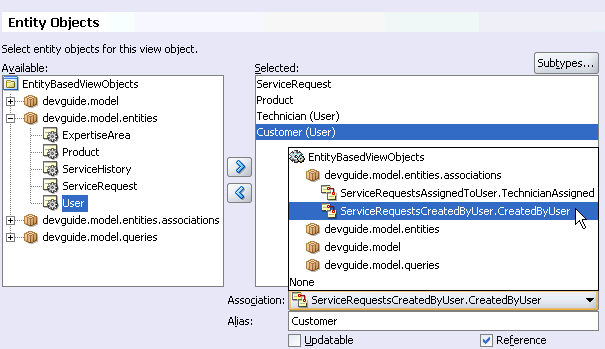

7.3.1.1 Adding Additional Reference Entity Usages to the View Object
Figure 7-8 shows the result of adding three additional reference entity usages to the existing ServiceRequests view object: one for the Product and two separate usages of the User entity. When you click on an entity usage in the Selected list, the state of the Reference checkbox indicates that the second and subsequent entity usages added to a view object are marked as reference information by default. Similarly, the secondary entity usages default to being not updatable, as the unchecked state of their Updatable checkbox confirms.
When adding secondary entity usages, they default to having their Updatable flag false and their Reference flag true. This is by far the most common usage pattern. In Section 27.9, "Creating a View Object with Multiple Updatable Entities", you'll explore the less common, yet still useful, situation of having a join view object with multiple, updatable entity usages.
The Association dropdown list shows you the name of the association that relates the selected entity usage to the primary one. The Alias field allows you to give a more meaningful name to the entity usage when the default name is not clear. For example, after shuttling two entity usages for the User entity object into the Selected list, initially the alias for the usages was User1 and User2. You can see in the figure that renaming these to be Technician and Customer instead greatly clarifies what reference information they are contributing to the view object. Importantly, the figure also illustrates that when you add multiple entity usages for the same entity, you need to use the Association dropdown list to select which association represents that usage's relationship to the primary entity usage. For the Technician entity usage select the ServiceRequestsAssignedToUser association, and for the Customer entity usage select the ServiceRequestsCreatedByUser association.
Figure 7-8 Indicating Correct Associations for Multiple Reference Entity Usages

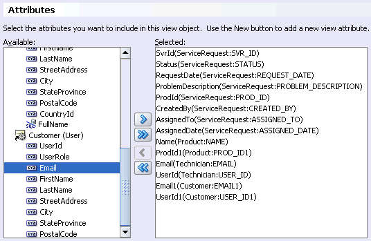

7.3.1.2 Selecting Additional Attributes from Reference Entity Usages
After adding these secondary entity usages, switch to the Attributes page of the View Object Editor and select the specific, additional attributes from these new usages that you want to include in the view object. Figure 7-9 illustrates the result of shuttling the following extra attributes into the Selected list:
  • The Name attribute from the Product entity usage
  • The Email attribute from the Technician entity usage
  • The Email attribute from the Customer entity usage
Notice that even if you didn't intend to include them, JDeveloper automatically verifies that the primary key attribute from each entity usage is part of the Selected list. If it's not already present in the list, JDeveloper adds it for you.
Figure 7-9 Selecting Additional Reference Entity Attributes to Include in the View Object
Images of shuttling extra attributes to the Selected list
Selecting the SQL Statement page, you can see that JDeveloper has included the new columns in the SELECT statement and has updated the Where field to include the appropriate join clauses of:
((ServiceRequest.PROD_ID = Product.PROD_ID) AND
 (ServiceRequest.ASSIGNED_TO = Technician.USER_ID)) AND
 (ServiceRequest.CREATED_BY = Customer.USER_ID)

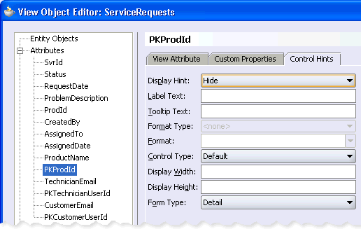

7.3.1.5 Hiding the Primary Key Attributes from Reference Entity Usages
Since you generally won't want to display the primary key attributes that were automatically added to the view object, you can set their Display Hint property on the UI Control Hints page to Hide as shown in Figure 7-10.
Figure 7-10 Setting an Attribute Control Hint to Hide Primary Key Attributes from Reference Entity Usages
Image of View Object Editor for ServiceRequests
Click OK to save your changes to the view object.

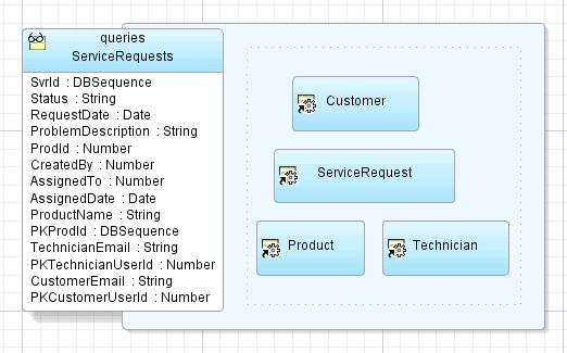

7.3.3.1 Showing View Objects in a Business Components Diagram
Section 6.4, "Creating an Entity Diagram for Your Business Layer" explained how to create a Business Components Diagram to visualize your business domain layer. In addition to supporting entity objects, JDeveloper's UML diagramming support allows you to drop view objects onto diagram as well to visualize their structure and entity usages. If you create a new Business Components Diagram named SRService Data Model in the devguide.model.design package, and drag the ServiceRequests view object from the Application Navigator onto the diagram, you'll see what's shown in Figure 7-11. When viewed as an expanded node, the diagram shows a compartment containing the view objects entity usages.
Figure 7-11 View Object and Its Entity Usages in a Business Components Diagram
Image of business components diagram for object usages
