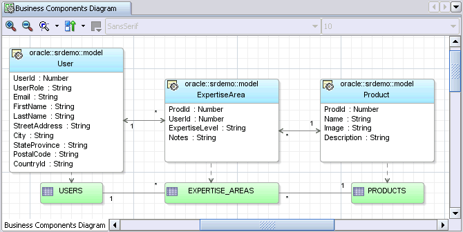

To create a business components diagram, open the New Gallery and select Business Components Diagram. After creating a new diagram, just drop the tables from the Connection Navigator onto the diagram surface to create entity objects for them. By default, the entity objects get named Users
, ExpertiseAreas
, and Products
based on the names of the tables. Since an entity object represents a single element of business domain data, it's best practice to name them with singular names. You can use the diagram's in-place editing support to rename the entity objects to User
, ExpertiseArea
, and Product
. JDeveloper has extensive support for refactoring to automate changing any related files to use the new names. In addition to the entity objects that were created, the tool also created associations that reflect the foreign keys relating the underlying tables. To help communicate how your entity objects are related to the tables, you can add the tables themselves to the same diagram and draw dependency lines between them, as shown in Figure 2-6.

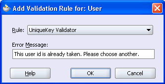

entity object in the diagram, you can access the Entity Object Editor to define declarative validation rules for users. Open the Validation page of the editor to add validation rules. Click New to add a new rule, and add a UniqueKey Validator that will ensure that the primary key for new User
rows is unique. As shown in Figure 2-7, you can enter a validation error message that the manager will see if she enters a new user whose ID is already taken. JDeveloper saves the error message in a standard Java message bundle to simplify localizing it for different languages.

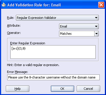

Next, you could add a regular expression validator on the Email
attribute to ensure that managers only enter email address in the expected 8-character, lowercase format. Selecting the Email
attribute in the Declarared Validation Rules tree and clicking New again, you can add a Regular Expression Validator. Figure 2-8 shows the regular expression to match from three to eight lowercase characters, and the error message that will appear if the manager enters an email in the wrong format.

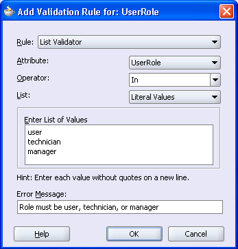

Select the UserRole
attribute and click New to add a List Validator as shown in Figure 2-9 to ensure that the role of a new user can only be user
, technician
, or manager
. Again, you can enter the error message the manager will see if she enters the data incorrectly.

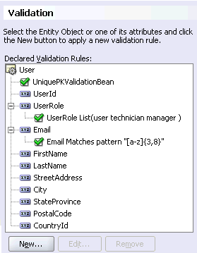

After doing this, you can see, as shown in Figure 2-10, that all the validation rules in effect are summarized on the Validation page of the Entity Object Editor.
