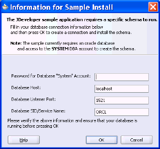

JDeveloper displays the SRDemo Application Schema Install dialog to identify the database to use for the sample data.
If you want to install the sample data and have access to a SYSTEM DBA account, enter the connection information in the Sample Install dialog.
Note: The connection information you provide may be for either a local or a remote database, and that database may be installed with or without an existing SRDemo schema.

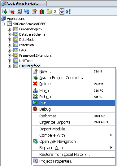

Run the application in JDeveloper by selecting the UserInterface project in the Application Navigator and choosing Run from the context menu, as shown in Figure 3-3.
Tip: The UserInterface project definesindex.jspx to be the default run target. This information appears in the Runner page of the Project Properties dialog for the UserInterface project. This allows you to simply click the Run icon in the JDeveloper toolbar when this project is active, or right-click the project and choose Run. To see the project's properties, select the project in the navigator, right-click, and choose Property Properties. |

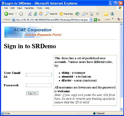

Running the index.jspx page from inside JDeveloper will start the embedded Oracle Application Server 10g Oracle Containers for J2EE (OC4J) server, launch your default browser, and cause it to request the following URL:
http://130.35.103.198:8988/SRDemoADFBC/faces/app/SRWelcome.jspx
If everything is working correctly, the index.jspx page's simple scriptlet response.sendRedirect("faces/app/SRWelcome.jspx"), will redirect to display the login page of the SRDemo application, as shown in Figure 3-4.
Tip: If your machine uses DHCP to get an automatically-assigned IP address, then after JDeveloper launches your default browser and starts embedded OC4J you may see an HTTP error stating that the web page does not exist. To correct this issue, you can specify the host name, localhost. Choose Embedded OC4J Preferences from the Tools menu and on the Startup tab set the Host Name or IP Address Used to Refer to the Embedded OC4J preference to use the Specify Host Name option, and enter the valuelocalhost. Then, edit the URL above to use localhost instead of 130.35.103.198. |
