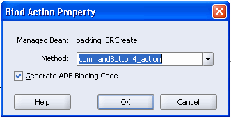

    In the Bind Action Property dialog, identify the backing bean and the method to which you want to bind the component using one of the following techniques:
    • If auto-binding has been enabled on the page, the backing bean is already selected for you, as shown in Figure 17-4.
      Figure 17-4 Bind Action Property Dialog for a Page with Auto-Binding Enabled
      Bind Actin Property Dialog for a Page Using Auto-binding

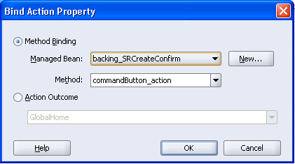

    • If the page is not using auto-binding, you can select from an existing backing bean or create a new one, as shown in Figure 17-5. For more information about auto-binding, see Section 11.5.4, "How to Use the Automatic Component Binding Feature".
      Figure 17-5 Bind Action Property Dialog for a Page with Auto-Binding Disabled
      Bind Action Property dialog for page not using auto-binding
      • Click New to create a new backing bean. The Create Managed Bean dialog is displayed. Use this dialog to name the bean and the class, and set the bean's scope.
        OR
      • Select an existing backing bean and method from the dropdown lists.
