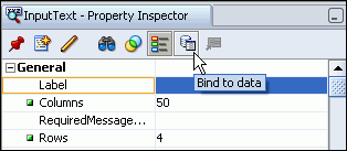

To open the Expression Builder from the Property Inspector:
Select a UI component in the Structure window or the visual editor and open the Property Inspector.
In the Property Inspector, take one of the following actions to display the Expression Builder:
Click the ellipses next to an existing binding expression.
OR
Select a property to which you want to add a binding, and click the Bind to data button, as shown in Figure 12-5.
(JDeveloper activates the Bind to data button only if it is valid to add a binding expression to the selected property.)

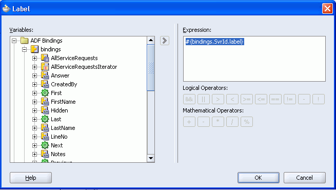

To use the Expression Builder:
In the Expression Builder, open the: ADF Bindings > bindings node to display the ADF binding objects for the current page, as shown in Figure 12-6.
Use the Expression Builder to edit or create ADF binding expressions using the following features:
Use the Variables tree to select items that you want to include in the binding expression. The tree contains a hierarchical representation of the binding objects. Each icon in the tree represents various types of binding objects that you can use in an expression (see Table 12-2 for a description of each icon). Select an item in the tree and click the shuttle button to move it to the Expression box.
If you are creating a new expression, begin typing the expression in the Expression box. JDeveloper provides Code Insight in the Expression Builder. To invoke Code Insight, type the leading characters of an EL expression (for example, #{) or a period separator. Code Insight displays a list of valid items for each segment of the expression from which you can select the one you want.
Use the operator buttons under the expression to add logical or mathematical operators to the expression.
