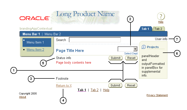

Most of the SRDemo pages use the ADF Faces panelPage component to lay out the entire page. The panelPage component lets you define specific areas on the page for branding images, navigation menus and buttons, and page-level or application-level text, ensuring that all web pages in the application will have a consistent look and feel. Figure 11-5 shows an example of a page created by using a panelPage component.
Figure 11-5 Page Layout Created with a PanelPage Component
Page layout showing menu tabs and bar, and global buttons

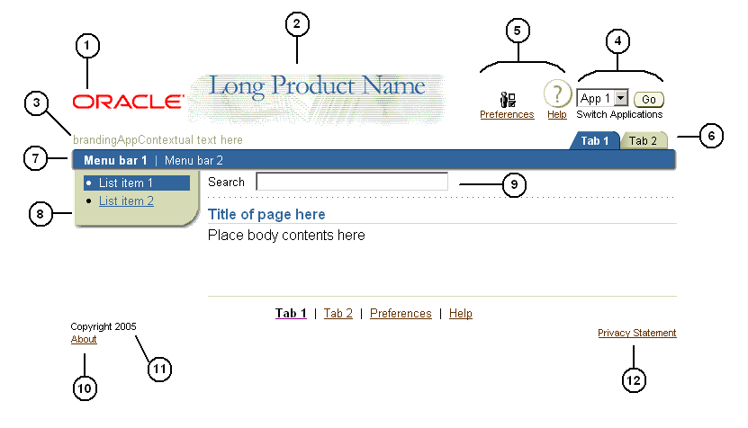

11.4.4.1 PanelPage Facets
Figure 11-7 shows panelPage facets (numbered 1 to 12) for laying out branding images, global buttons, menu tabs, bars, and lists, and application-level text.
Figure 11-7 Basic Page Layout with Branding Images, Navigation Menus, and Application-Level Text
Page layout. See Table 4-3 for descriptions.
Table 11-3 shows the panelPage facets (as numbered in Figure 11-7), and the preferred children components that you could use in them. In JDeveloper, when you right-click a facet in the Structure window, the Insert inside context menu shows the preferred component to use, if any.
Table 11-3 PanelPage Facets for Branding Images, Navigation Menus, and Application-Level Text
No. Facet Description
1
branding
For a corporate logo or organization branding using objectImage. Renders its child component at the top left corner of the page.
2
brandingApp
For an application logo or product branding using objectImage. Renders its child component after a branding image, if used. If chromeType on panelPage is set to "expanded", the brandingApp image is placed below the branding image.
3
brandingAppContextual
Typically use with outputFormatted text to show the application's current branding context. Set the styleUsage attribute on outputFormatted to inContextBranding.
4
menuSwitch
For a menuChoice component that allows the user to switch to another application from any active page. Renders its child component at the top right corner of the page. The menuChoice component can be bound to a menu model object.
5
menuGlobal
For a menuButtons component that lays out a series of menu items as global buttons. Global buttons are buttons that are always available from any active page in the application (for example a Help button). Renders its children components at the top right corner of the page, before a menuSwitch child if used. A text link version of a global button is automatically repeated at the bottom of the page. The menuButtons component can be bound to a menu model object.
6
menu1
For a menuTabs component that lays out a series of menu items as tabs. Renders its children components (right justified) at the top of the page, beneath any branding images, menu buttons, or menu switch. A text link version of a tab is automatically repeated at the bottom of the page. Menu tab text links are rendered before the text link versions of global buttons. Both types of text links are centered in the page. The menuTabs component can be bound to a menu model object.
7
menu2
For a menuBar component that lays out a series of menu items in a horizontal bar, beneath the menu tabs. The children components are left justified in the bar, and separated by vertical lines. The menuBar component can be bound to a menu model object.
8
menu3
For a menuList component that lays out a bulleted list of menu items. Renders the children components in an area offset by color on the left side of a page, beneath a menu bar. The menuList component can be bound to a menu model object.
9
search
For a search area using an inputText component. Renders its child component beneath the horizontal menu bar. A dotted line separates it from the page title below.
10
appAbout
For a link to more information about the application using commandLink. The link text appears at the bottom left corner of the page.
11
appCopyright
For copyright text using outputText. The text appears above the appAbout link.
12
appPrivacy
For a link to a privacy policy statement for the application using commandLink. The link text appears at the bottom right corner of the page.
Tip:

Figure 11-8 shows panelPage facets (numbered 1 to 7) for laying out page-level actions and text.
Figure 11-8 Basic Page Layout with Page-Level Actions and Informational Text
Page layout. See Table 4-4 for descriptions.
Table 11-4 shows the panelPage facets (as numbered in Figure 11-8), and the preferred children components that you could use in them.
Table 11-4 PanelPage Facets for Page-Level Actions and Informational Text
1
actions
For page-level actions that operate on the page content. Typically use with a panelButtonBar to lay out a series of buttons, a processChoiceBar, or a selectOneChoice. Renders its children components below the page title, right-justified. The children components are also automatically repeated near the bottom of the page (above any text link versions of menu tabs and global buttons) on certain devices and skins.
2
contextSwitcher
A context switcher lets the user change the contents of the page based on the context. For example, when a user is viewing company assets for a department, the user can use the context switcher to switch to the assets of another department. All the pages will then change to the selected context. Typically use with a selectOneChoice component. The facet renders its child component on the same level as the page title, right-justified.
3
infoFootnote
For page-level information that is ancillary to the task at hand. Typically use with an outputFormatted component, with styleClass or styleUsage set to an appropriate value. The facet renders its child component near the bottom of the page, left-justified and above the infoReturn link.
4
infoReturn
For a "Return to X" link using commandLink. For the user to move quickly back to the default page of the active menu tab. The facet renders its child component near the bottom of the page, left-justified and above the text link versions of menu tabs and global buttons.
5
infoStatus
For page-level status information about the task at hand. Could also use to provide a key notation. A key notation is a legend used to define icons, elements, or terms used within the page contents. Typically use with an outputFormatted component, with styleClass or styleUsage set to an appropriate value. The facet renders its child component below the page title, left-justified.
6
infoSupplemental
For any other additional information. Typically use with a panelBox to show the information in an area offset by color. In the panelBox you could use for example panelList or outputFormatted text to provide additional information that might help the user, but is not required for completing a task. The facet renders its children components on the right side of the page, below the infoUser facet child component.
7
infoUser
For presenting user login and connection information. Typically use with an outputFormatted component, with styleClass or styleUsage set to an appropriate value. The facet renders its child component on the right side of the page, immediately below the menu bars.
