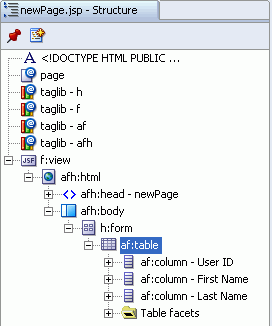

In the Design page of the visual editor, select the UI component to which you want to add ADF bindings.
The component must be one of the tags listed in Table 21-1. When you select a component in the visual editor, JDeveloper simultaneously selects that component tag in the Structure window, as shown in Figure 21-1. Use the Structure window to verify that you have selected the correct component. If the incorrect component is selected, make the adjustment in the Structure window.

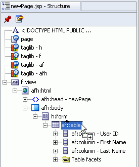

Drag the appropriate data control object from the Data Control Palette to the Structure window and drop it on the selected UI component. (For information about the nodes on the Data Control Palette, see Section 12.2.1, "How to Understand the Items on the Data Control Palette".)
Tip: As you position the data control object over the UI component in the Structure window, a horizontal line with an embedded up or down arrow appears at the top or bottom of the component, as shown in Figure 21-2. Whenever either of these lines appears, you can drop the data control object: in this case, it does not matter which direction the arrow is pointing. |
