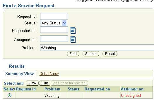

18.3.4 About Creating Search and Results on the Same Page
As stated above, when you place the iterator into Find mode, it is in Find mode for all associated bindings. When you drop the same collection as a table to display the search results, that table's binding uses the same iterator as the search form. Because that means the table component would be bound to an iterator binding in Find mode, it will display the current query-by-example view criteria rows, as shown in Figure 18-4, instead of the actual data until you hit Execute and the iterator is taken out of Find mode.
Figure 18-4 The Table Displays the Criteria Rows When in Find Mode
Criteria are displayed in the rows of the table
To avoid this, you must create a second iterator for the table that is not in Find mode, but instead displays the collection of data that meets the search criteria.
