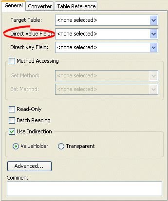

Configuring Direct Value Field
The direct value field in the reference table stores the primitive data value of the map value. If the value's object value and database value are different types, use a converter (see "Configuring Value Converters").
Using TopLink Workbench
  1. Select the mapped attribute in the Navigator. Its properties appear in the Editor.
  2. Click the General tab. The General tab appears.
    Figure 44-1 General Tab, Direct Value Field
    Description of Figure 44-1 follows
    Description of "Figure 44-1 General Tab, Direct Value Field"
Use the Direct Value Field list to select the field from the Target Table table that contains the object of the direct map mapping.

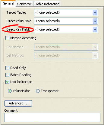

Configuring Direct Key Field
The direct key field in the reference table stores the primitive data value of the map key. If the key's object value and database value are different types, use a converter (see "Configuring Key Converters").
To specify the direct key field in the reference table, use this procedure.
    Figure 44-2 General Tab, Direct Key Field
    Description of Figure 44-2 follows
    Description of "Figure 44-2 General Tab, Direct Key Field"
Use the Direct Key Field list to select the key from the Target Table table that contains the object of the direct map mapping.

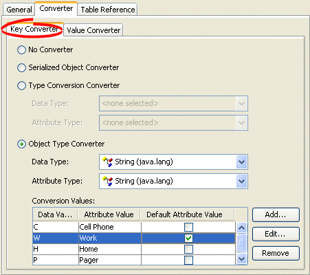

If the key's object value and database value are different types, use a converter. TopLink supports the following key converters:
Use this procedure to specify the converter for a direct map mapping key:
  2. Click the Converter tab. The Converter tab appears.
  3. Click the Key Converter tab. The Key Converter tab appears.
    Figure 44-3 Converter Tab, Key Converter Subtab
    Description of Figure 44-3 follows
    Description of "Figure 44-3 Converter Tab, Key Converter Subtab"
Converter Description
No Converter Do not use a Key Converter for this mapping.
Serialized Object Converter See "Configuring a Serialized Object Converter".
Type Conversion Converter See "Configuring a Type Conversion Converter".
Object Type Converter See "Configuring an Object Type Converter".

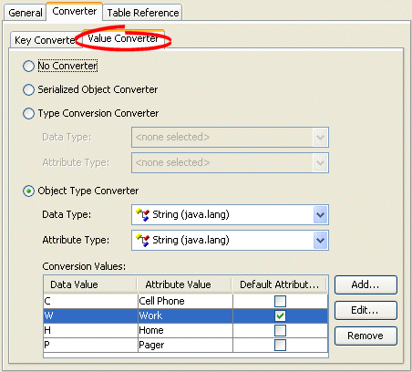

If the value's object value and database value are different types, use a converter. TopLink supports the following value converters:
  3. Click the Value Converter tab. The Value Converter tab appears.
    Figure 44-4 Converter Tab, Value Converter Subtab
    Description of Figure 44-4 follows
    Description of "Figure 44-4 Converter Tab, Value Converter Subtab"
No Converter Do not use a Value Converter for this mapping.
