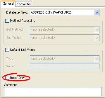

To specify a mapping as read-only, use this procedure:
  1. Select the mapped attribute in the Navigator. Its properties appear in the Editor.
  2. Click the General tab. The General tab appears.
    Figure 32-1 General Tab, Read-Only Option
    Description of Figure 32-1 follows
    Description of "Figure 32-1 General Tab, Read-Only Option"
Select the Read-Only option to set the mapping to be read-only and not affected during update and delete operations.

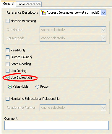

Using TopLink Workbench
To complete the indirection options on a mapping's General tab use this procedure:
    Figure 32-2 General Tab, Indirection Options
    Description of Figure 32-2 follows
    Description of "Figure 32-2 General Tab, Indirection Options"
Use the following information to complete the Indirection fields on the tab:
Field Description
Use Indirection Specify if this mapping uses indirection.
    ValueHolder Specify that the mapping uses Value Holder indirection. See "Value Holder Indirection" for more information.
    Proxy Specify that the mapping uses Proxy indirection. See "Proxy Indirection" for more information.

Using proxy indirection does not change how you instantiate your own domain objects for an insert operation. You still use the following code:
Employee emp = new EmployeeImpl("John Smith");
Address add = new AddressImpl("123 Main St.");
emp.setAddress(add);

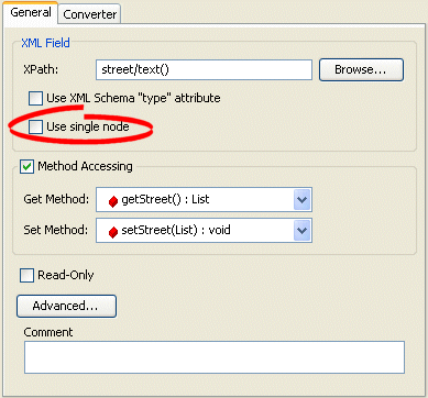

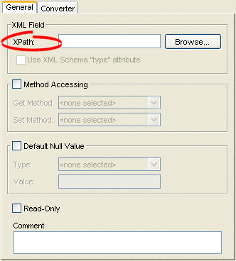

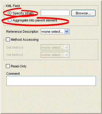

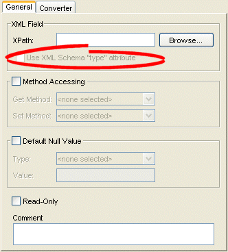

Configuring XPath
TopLink uses XPath statements to map the attributes of a Java object to locations in an XML document. When you create an XML mapping or EIS mapping using XML records, you can specify the XPath based on any of the following:
Table 32-5 summarizes which mappings support this option.
Footnote 1 When used with XML records only (see "Configuring Record Format").
Footnote 2 Supports the self XPath (".") so that the TopLink runtime performs all read and write operations in the parent's element and not an element nested within it (see "Mappings and the jaxb:class Customization").
Before you can select an XPath for a mapping, you must associate the descriptor with a schema context (see "Configuring Schema Context for an EIS Descriptor" or "Configuring Schema Context for an XML Descriptor").
For more information, see "Mappings and XPath".
Use this table to select the XPath for an XMl mapping or EIS mapping using XML records:
  2. If necessary, click the General tab. The General tab appears.
    Figure 32-3 General Tab, XPath Options
    Description of Figure 32-3 follows
    Description of "Figure 32-3 General Tab, XPath Options"
    Figure 32-4 XPath Options for Composite Object Mappings
    Description of Figure 32-4 follows
    Description of "Figure 32-4 XPath Options for Composite Object Mappings"
Click Browse and select the XPath to map to this attribute (see "Choosing the XPath").

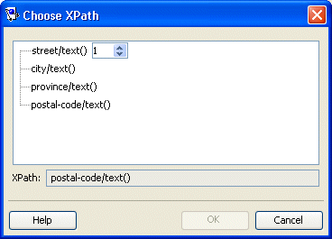

For an EIS composite object mapping using XML records or an XML composite object mapping, you can choose one of the following:
Choosing the XPath
From the Choose XPath dialog box, select the XPath and click OK. TopLink Workbench builds the complete XPath name.
Figure 32-5 Choose XPath Dialog Box
Description of Figure 32-5 follows
Description of "Figure 32-5 Choose XPath Dialog Box"

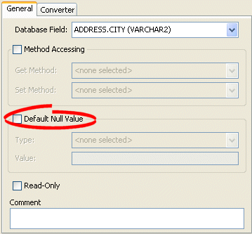

Configuring a Default Null Value at the Mapping Level
A default null value is the Java Object type and value that TopLink uses instead of null when TopLink reads a null value from a data source.
When you configure a default null value at the mapping level, TopLink uses it to translate in two directions:
Table 32-6 summarizes which mappings support this option.
A default null value must be an Object. To specify a primitive value (such as int), you must use the corresponding Object wrapper (such as Integer).
You can also use TopLink to set a default null value for all mappings used in a session (see "Configuring a Default Null Value at the Login Level").
To configure a default null value for a mapping, use this procedure.
    Figure 32-6 General Tab, Default Null Value Options
    Description of Figure 32-6 follows
    Description of "Figure 32-6 General Tab, Default Null Value Options"
Use the following information to complete the Default Null Value fields on the tab:
Field Description
Default Null Value Specify if this mapping contains a default value in the event that the data source is null. If selected, you must enter both the Type and Value of the default.
    Type Select the Java type of the default value.
    Value Enter the default value.
Using Java
To configure a mapping null value using Java API, use the AbstractDirectMapping method setNullValue.
For example:
// Defaults a null salary to 0
salaryMapping.setNullValue(new Integer(0));
Configuring Method Accessing
By default, TopLink uses direct access to access public attributes. Alternatively, you can use getter and setter methods to access object attributes when writing the attributes of the object to the database, or reading the attributes of the object from the database. This is known as method access.
The attribute's visibility (public, protected, private, or package visibility) and the supported version of JDK may restrict the type of access that you can use.
Using private, protected or package variable or method access requires you to enable the Java reflect security setting. This is enabled by default in most application servers (see "Security Permissions"), but may need to be enabled explicitly in certain JVM configurations. If necessary, use the java.policy file to grant ReflectPermission to the entire application or the application's code base. For example:
grant{
     permission java.lang.reflect.ReflectPermission;
Oracle recommends using direct access whenever possible to improve performance and avoid executing any application-specific behavior while building objects.
Table 32-7 summarizes which mappings support this option.
For information on configuring method accessing at the project level, see "Configuring Mapped Field Access at the Project Level".

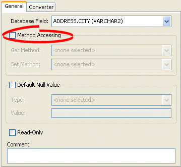

To complete the field access method for a mapping, use this procedure:
    Figure 32-7 General Tab, Method Accessing Options
    Description of Figure 32-7 follows
    Description of "Figure 32-7 General Tab, Method Accessing Options"
Use the following information to complete the Method Accessing fields on this tab:
Field Description
Method Accessing Specify if this mapping uses specific accessor methods instead directly accessing public attributes. By default, this option is not selected (that is, the mapping uses direct access).
    Get Method Select a specific get method.
    Set Method Select a specific set method.
To change the default access type used by all new mappings, use the Defaults tab on the project Editor window. See "Configuring Mapped Field Access at the Project Level" for more information.

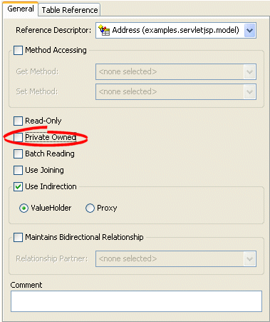

Configuring Private or Independent Relationships
In TopLink, object relationships can be either private or independent:
Tip:
TopLink automatically manages private relationships. Whenever an object is written to the database, any private objects it owns are also written to the database. When an object is removed from the database, any private objects it owns are also removed. Be aware of this when creating new systems, since it may affect both the behavior and the performance of your application.
Table 32-8 summarizes which mappings support this option.
To create a privately owned mapping, use this procedure:
    Figure 32-8 General Tab, Private Owned option
    Description of Figure 32-8 follows
    Description of "Figure 32-8 General Tab, Private Owned option"
To create private ownership, select the Private Owned option.
Using Java
For mappings not supported in TopLink Workbench, use the independentRelationship (default), privateOwnedRelationship, and setIsPrivateOwned methods.
Example 32-9 shows how to use these methods with a class that has a privately owned attribute, phones, in a mapping.
Example 32-10 Configuring Access Method in Java
// Map the phones attribute
phonesMapping.setAttributeName("phones");
// Specify as privately owned
phonesMapping.privateOwnedRelationship();

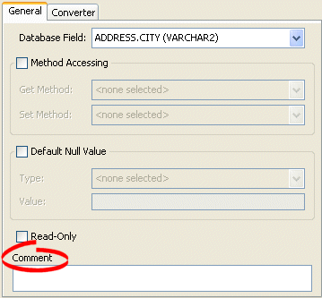

Configuring Mapping Comments
You can define a free-form textual comment for each mapping. You can use these comments however you whish: for example, to record important project implementation details such as the purpose or importance of a mapping.
Comments are stored in the TopLink Workbench project, in the TopLink deployment XML file. There is no Java API for this feature.
Table 32-9 summarizes which mappings support this option.
Table 32-9 Mapping Support for Comments
Mapping Using TopLink Workbench
Using Java
Relational Mappings
Supported.
Unsupported
EIS Mappings
Supported.
Unsupported
XML Mappings
Supported.
Unsupported
To add a comment for a mapping, use this procedure.
    Figure 32-9 General Tab, Comment
    Description of Figure 32-9 follows
    Description of "Figure 32-9 General Tab, Comment"
Enter a comment that describes this mapping.

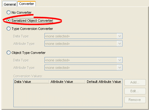

Configuring a Serialized Object Converter
A serialized object converter can be used to store an arbitrary object or set of objects into a data source binary large object (BLOB) field. It uses the Java serializer so the target must be serializable.
For more information about the serialized object converter, see "Serialized Object Converter".
Table 32-10 summarizes which mappings support this option.
To create an serialized object direct mapping, use this procedure:
  2. Click the Converter tab. The Converter tab appears.
    Figure 32-10 Converter Tab, Serialized Object Converter Option
    Description of Figure 32-10 follows
    Description of "Figure 32-10 Converter Tab, Serialized Object Converter Option"
To specify a serialized object converter, select the Serialized Object Converter option.

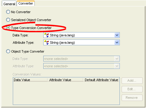

Configuring a Type Conversion Converter
A type conversion converter is used to explicitly map a data source type to a Java type.
For more information about the type conversion converter, see "Type Conversion Converter".
Table 32-11 summarizes which mappings support this option.
To create an type conversion direct mapping, use this procedure:
  3. Select the Type Conversion Converter option.
    Figure 32-11 Converter Tab, Type Conversion Converter Option
    Description of Figure 32-11 follows
    Description of "Figure 32-11 Converter Tab, Type Conversion Converter Option"
Use the following information to complete the Type Conversion Converter fields on the Converter tab:
Field Description
Data Type Select the Java type of the data in the data source.
Attribute Type Select the Java type of the attribute in the Java class.

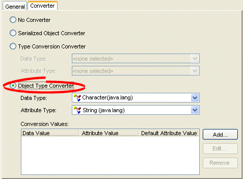

Configuring an Object Type Converter
An object type converter is used to match a fixed number of data source data values to Java object values. It can be used when the values in the data source and in Java differ.
For more information about the object type converter, see "Object Type Converter".
Table 32-12 summarizes which mappings support this option.
To add an object type converter to a direct mapping, use this procedure:
  1. Select the mapping in the Navigator. Its properties appear in the Editor.
  3. Figure 32-12 Converter Tab, Object Type Converter
    Description of Figure 32-12 follows
    Description of "Figure 32-12 Converter Tab, Object Type Converter"
Use the following fields on the mapping's Converter tab to specify the object type converter options:
Field Description
Conversion Values Click Add to add a new conversion value. Click Edit to modify an existing conversion value. Click Remove to delete an existing conversion value.
Use to specify the selected value as the default value. If TopLink retrieves a value from the database that is not mapped as a valid Conversion Value, the default value will be used.
    Data Value Specify the value of the attribute in the data source.
    Attribute Value Specify the value of the attribute in the Java class
    Default Attribute Value Specify whether or not to use the selected value as the default value. If TopLink retrieves a value from the database that is not mapped as a valid Conversion Value, the default value will be used.

    Figure 32-13 General Tab, Use XML Schema "type" Attribute Option
    Description of Figure 32-13 follows
    Description of "Figure 32-13 General Tab, Use XML Schema "type" Attribute Option"
Select the Field Uses XML Schema "type" attribute field to qualify elements from the XML schema.

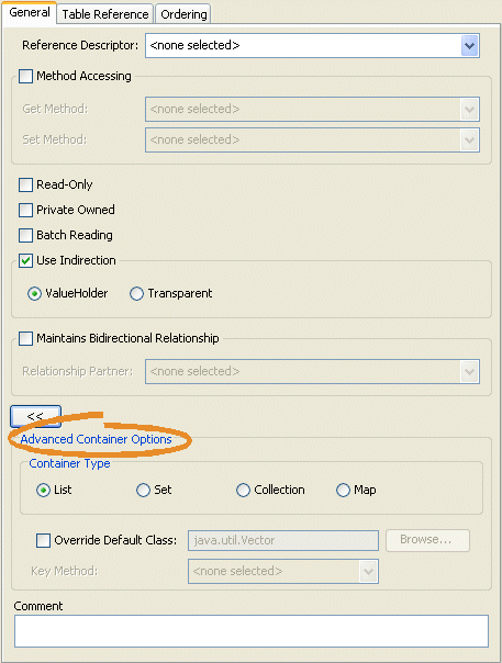

Configuring Container Policy
Collection mapping container policy specifies the concrete class TopLink should use when reading target objects from the database.
Collection mappings can use any concrete class that implements the java.util.List, java.util.Set, java.util.Collection, or java.util.Map interface. You can map object attributes declared as List, Set, Collection, Map, or any subinterface of these interfaces, or as a class that implements one of these interfaces.
By default, the TopLink runtime uses the following concrete classes from the oracle.toplink.indirection package for each of these container types:
Alternatively, you can specify in the mapping the concrete container class to be used. When TopLink reads objects from the database that contain an attribute mapped with a collection mapping, the attribute is set with an instance of the concrete class specified. For example, TopLink does not sort in memory. If you want to sort in memory, override the default Set type (IndirectList) with java.util.TreeSet as the concrete collection type. By default, a collection mapping's container class is java.util.Vector.
If you are using TopLink Workbench and you override the default Collection class with a custom Collection class of your own, you must put your custom Collection class on the TopLink Workbench classpath (see "Configuring the TopLink Workbench Environment").
Table 32-15 summarizes which mappings support this option.
To specify a mapping's container policy, use this procedure:
  3. Click the Advanced button. The Advanced Container Options appear on the General tab.
    Figure 32-14 General Tab, Advanced Container Options
    Description of Figure 32-14 follows
    Description of "Figure 32-14 General Tab, Advanced Container Options"
Use the following Advanced Container Options fields on the General tab to specify the container options:

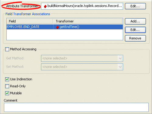

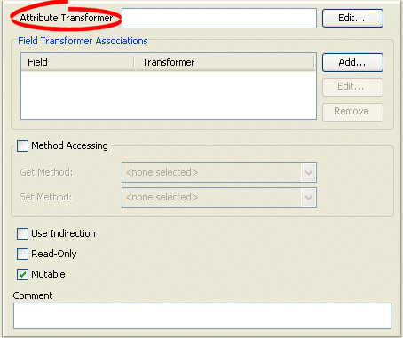

Configuring Attribute Transformer
A transformation mapping is made up of an attribute transformer for field-to-attribute transformation at read (unmarshall) time and one or more field transformers for attribute-to-field transformation at write (marshall) time (see "Configuring Field Transformer Associations").
This section describes how to configure the attribute transformer that a transformation mapping uses to perform the field-to-attribute transformation at read (unmarshal) time.
You can do this using either a method or class-based transformer.
A method-based transformer must map to a method in the domain object.
A class-based transformer allows you to place the transformation code in another class, making this approach non-intrusive: that is, your domain object does not need to implement a TopLink interface or provide a special transformation method
Table 32-16 summarizes which mappings support this option.
To specify a mapping's attribute transformer, use this procedure:
  1. Select the transformation mapping in the Navigator. Its properties appear in the Editor.
    Figure 32-15 Transformation Mapping, Attribute Transformer Field
    Description of Figure 32-15 follows
    Description of "Figure 32-15 Transformation Mapping, Attribute Transformer Field"

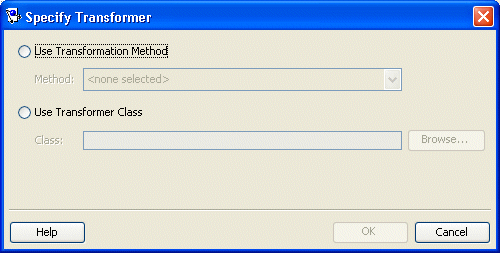

  2. Click Edit. The Specify Transformer dialog box appears.
    Figure 32-16 Specify Transformer Dialog Box
    Description of Figure 32-16 follows
    Description of "Figure 32-16 Specify Transformer Dialog Box"
Use the following information to enter data in each field of the dialog box and click OK:
Field Description
Use Transformation Method Select a specific method to control the transformation. A method based transformer must map to a method in the domain object.
Use Transformer Class Select a specific class to control the transformation. The class must be available on the TopLink Workbench application classpath.
Using Java
You can configure a method-based attribute transformer using AbstractTransformationMapping method setAttributeTransformation, passing in the name of the domain object method to use.
You can configure a class-based attribute transformer using AbstractTransformationMapping method setAttributeTransformer, passing in an instance of oracle.toplink.mappings.Transfomers.AttributeTransformer.
A convenient way to create an AttributeTransformer is to extend AttributeTransformerAdapter.

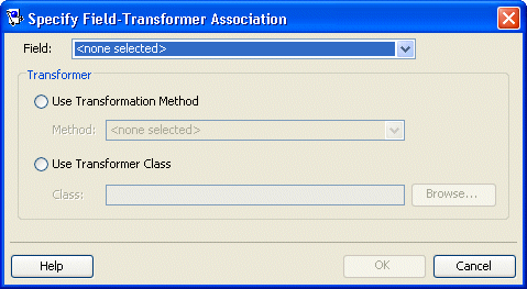

Specifying Field-to-Transformer Associations
To specify the actual transformation method or class used for the field of a transformation mapping, use this procedure.
  1. From the Transformation Mapping, Field Transformer Associations, click Add or Edit. The Specify Field-Transformer Association dialog box appears.
    Figure 32-18 Specify Field-Transformer Association Dialog Box
    Description of Figure 32-18 follows
    Description of "Figure 32-18 Specify Field-Transformer Association Dialog Box"
Use the following information to complete each field on the dialog box:
Field Description
Field Select the database field (from the descriptor's associated table) for this transformation.
Transformer Select one of the following methods to control the transformation:
    Use Transformer Class Select a specific class to control the transformation. The class must be available on TopLink Workbench application classpath.

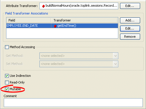

    Figure 32-19 Transformation Mapping, Mutable Option
    Description of Figure 32-19 follows
    Description of "Figure 32-19 Transformation Mapping, Mutable Option"
By default, the IsMutable option is selected in all transformation mappings. If the mapping maps to a simple atomic value, unselect this option.

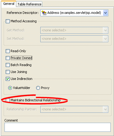

To maintain a bidirectional relationship for a mapping, use this procedure:
    Figure 32-20 General tab, Maintains Bidirectional Relationship option
    Description of Figure 32-20 follows
    Description of "Figure 32-20 General tab, Maintains Bidirectional Relationship option"
Use this table to enter data in the following fields on the tab:
Field Description
Maintains Bidirectional Relationship Specify if TopLink should maintain the bidirectional link for this relational mapping.
    Relationship Partner Select the relationship partner (from the list of mapped attributes of the Reference Descriptor) for this bidirectional relationship.
Configuring the Use of a Single Node
For the XML-based mappings that Table 32-6 summarizes, when you map a list value, you can configure whether or not the mapping unmarshalls (writes) the list to a single node, like <item>aaa bbb ccc</item>, or to multiple nodes, like:
<item>aaa</item>
<item>bbb</item>
<item>ccc</item>
To configure a mapping to use a single node, use this procedure.
    Figure 32-21 General Tab, Use Single Node Option
    Description of Figure 32-21 follows
    Description of "Figure 32-21 General Tab, Use Single Node Option"
To configure the mapping to unmarshall (write) a list value to a single node (like <item>aaa bbb ccc</item>), click Use single node.
By default, the mapping unmarshalls a list value to separate nodes.
Using Java
Use AbstractCompositeDirectCollectionMapping method setUsesSingleNode to configure the mapping to write a list value to a single node by passing in a value of true. To configure the mapping to write a list value to multiple nodes, pass in a value of false.
For any mapping that takes an XMLField, use XMLField method setUsesSingleNode to configure the mapping to write a list value to a single node by passing in a value of true. To configure the mapping to write a list value to multiple nodes, pass in a value of false. Example 32-17 shows how to use this method with an XMLDirectMapping:
