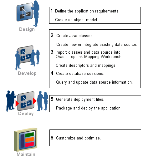

Typical Development Stages
This section describes the general development stages of a TopLink application. Figure 2-1 illustrates the TopLink development process.
Figure 2-1 TopLink Development Process
Description of Figure 2-1 follows
Description of "Figure 2-1 TopLink Development Process"
Design the Application (1)
Define your application requirements, select an architecture, and determine the target platform. See "Designing Your Application With TopLink" for more information. Remember, TopLink works with any architecture and any platform.
When designing the application, you should also create an object model for the application. See "Understanding Object Persistence" for more information. It is important to create the object model before using TopLink to map objects, because defining persistent mappings for an incorrect or rapidly changing model can be very difficult.
Develop the Application (2, 3, 4)
Create the Java classes and decide how the classes should be implemented by the data source. When working with a legacy system, decide how the classes relate to the existing data. If there is no legacy data source to integrate, decide how to store each class in the data source and create the required schema. Alternatively, you may use TopLink to create your initial tables.
Using TopLink Workbench, create descriptors and mappings for the persistent classes. Use TopLink sessions to manipulate the persistent classes, including querying and changing data. See Part II, "Using TopLink Development Tools" for more information.
Avoid building all your model's descriptors in a single iteration. Start with a small subset of your classes. Build and test their descriptors, then gradually add new descriptors and relationships. This lets you catch common problems before they proliferate through your entire design.
Write Java code to use database sessions. Sessions are used to query for database objects and write objects to the database. See Chapter 72, "Understanding TopLink Sessions" for more information.
Deploy the Application (5)
Generate, package, then deploy the necessary files to your application server. The required information will vary, depending on your environment and architecture. See Part III, "Deploying a TopLink Application" for more information.
Maintain the Application (6)
TopLink includes many options that can enhance application performance. You can customize most aspects of TopLink to suit your requirements. Use advanced TopLink features or write custom querying routines to access the database in specific ways, and to optimize performance. See Part IV, "Optimizing and Customizing a TopLink Application" for more information.

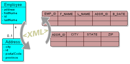

Oracle XML Database (XDB) Usage
You can use TopLink to persist XML documents to an Oracle XML database using TopLink direct-to-XMLType mappings.
For more information, see "Relational Projects" and "Direct-to-XMLType Mapping".

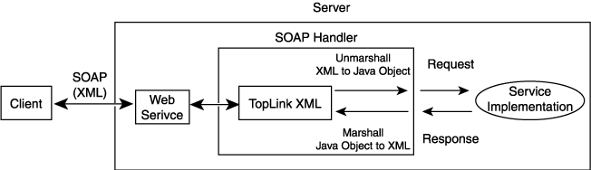

XML Usage
You can use TopLink for in-memory, nonpersistent Java object-to-XML transformation with XML Schema (XSD) based XML documents and JAXB.
You can use the TopLink JAXB compiler with your XSD to generate both JAXB-specific artifacts (such as content and element interfaces, implementation classes, and object factory class) and TopLink-specific artifacts (such as sessions and project XML files and TopLink Workbench project). For more information, see "TopLink Support for Java Architecture for XML Binding (JAXB)".
This usage has many applications, including messaging and Web services.

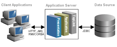

Three Tier
Oracle recommends a three-tier application architecture. With a three-tier architecture, Oracle recommends using TopLink server sessions and client sessions (see "Server and Client Sessions") and the TopLink unit of work (see Chapter 97, "Understanding TopLink Transactions").
For more information, see "Understanding the Three-Tier Architecture".

  • XML/Web service client–With this client type, you can use TopLink XML (see "XML Usage").

    • XML/Web service–Use TopLink XML (see "XML Usage").

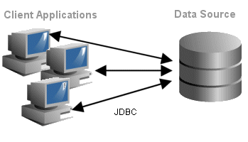

Two Tier
With a two-tier application architecture, Oracle recommends using TopLink database sessions (see "Database Sessions") and the TopLink unit of work (see Chapter 97, "Understanding TopLink Transactions"). The disadvantages of this architecture are that it is not Web-enabled and does not scale well to large deployments.
For more information, see "Understanding the Two-Tier Architecture".

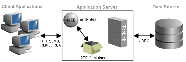

EJB Entity Beans
EJB entity bean architectures are slightly different from other TopLink architectures, because the EJB entity bean interfaces hide TopLink functionality completely from the client application developer.
You can use entity beans in almost any J2EE application. For TopLink, how the application uses the entity beans is not important; how entity beans are mapped and implemented is important to TopLink.
Container-Managed Persistence (CMP)
Oracle recommends using entity beans with container-managed persistence. In this case, you should use the TopLink CMP integration for your application server. You must ensure that you are using a J2EE server that TopLink supports (see "Integrating TopLink With an Application Server ").
For more information, see "Understanding the EJB Entity Beans With CMP Architecture".

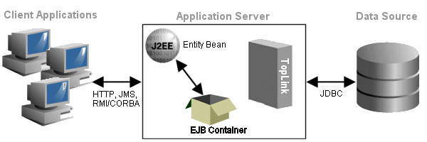

Bean-Managed Persistence (BMP)
If you are using entity beans with bean-managed persistence, you should use the TopLink BMP integration. The disadvantages of this architecture are that the BMP architecture is restrictive and may not provide good performance.
For more information, see "Understanding the EJB Entity Beans With BMP Architecture".

Understanding TopLink Metadata
The TopLink metadata is the bridge between the development of an application and its deployed run-time environment. Capture the metadata using TopLink Workbench (see "Creating Project Metadata" and "Creating Session Metadata"), and pass the metadata to the run-time environment using deployment XML files (such as project.xml and sessions.xml). You could also manually code these files using Java and the TopLink API, but this approach is more labor-intensive.
The metadata, encapsulated in deployment XML files, lets you pass configuration information into the run-time environment. The run-time environment uses the information in conjunction with the persistent entities (Java objects or EJB entity beans) and the code written with the TopLink API, to complete the application.
Figure 2-2 TopLink Metadata
The three-tier Web application architecture generally includes the connection of a server-side Java application to the database through a JDBC connection (see Figure 2-3). In this pattern, TopLink resides within a Java server (a J2EE server or a custom server), with several possible server integration points. The application can support Web clients such as servlets, Java clients, and generic clients using XML or Common Object Request Broker Architecture (CORBA).
The three-tier application is a common architecture in which TopLink resides within a Java server (either a J2EE server or a custom server). In this architecture, the server session provides clients with shared access to JDBC connections and a shared object cache. Because it resides on a single JVM, this architecture is simple and easily scalable. The TopLink persistent entities in this architecture are generally Java objects.
This architecture often supports Web-based applications in which the client application is a Web client, a Java client, or a server component.
Figure 2-3 Three Tier Architecture
Description of Figure 2-3 follows
Description of "Figure 2-3 Three Tier Architecture"
Although not all three-tier applications are Web-based, this architecture is ideally suited to distributed Web applications. In addition, although it is also common to use EJB in a Web application, this TopLink architecture does not.
A two-tier application generally includes a Java client that connects directly to the database through TopLink. The two-tier architecture is most common in complex user interfaces with limited deployment. The database session provides TopLink support for two-tier applications.
For more information, see Chapter 72, "Understanding TopLink Sessions".
Figure 2-4 Two-Tier Architecture
Description of Figure 2-4 follows
Description of "Figure 2-4 Two-Tier Architecture"
Although the two-tier architecture is the simplest TopLink application pattern, it is also the most restrictive, because each client application requires its own session. As a result, two-tier applications do not scale as easily as other architectures.
Two-tier applications are often implemented as user interfaces that directly access the database (see Figure 2-4). They can also be non-interface processing engines. In either case, the two-tier model is not as common as the three-tier model.
CMP is the part of the J2EE component model that provides an object persistence service that an EJB container uses to persist entity beans. CMP provides distributed, transactional, secure access to persistent data, with a guaranteed portable interface.
This architecture is an extension of the three-tier architecture, in which the implementation of persistence methods is handled by the container at runtime. As a bean provider, you only need to specify in a deployment descriptor those persistent fields and relationships for which the container must handle data access and, optionally, an abstract representation of the database schema.
TopLink CMP is an extension of the TopLink persistence framework that provides custom integration to EJB containers of various application servers (see "Application Server Support"). For more information about choosing an application server, see "Understanding Target Platforms". TopLink integrates with the EJB container in this architecture to augment (or, in the case of OC4J, become) the container's persistence manager.
When using OC4J and Java 1.5, TopLink supports a subset of the persistence features anticipated in the final EJB 3.0 specification. For more information on EJB 3.0 support, see Oracle Containers for J2EE Enterprise JavaBeans Developer's Guide.
EJB 3.0 feature support is subject to change and dependent upon the contents of the final specification.
TopLink CMP integration is nonintrusive (see Figure 2-6). Through a combination of run-time integration and code generation, the container uses TopLink internally and the bean user interacts with entity beans with container-managed persistence according to their standard API. This lets you combine the standard interfaces and power of CMP and a container with TopLink flexibility, performance, and productivity.
BMP is the part of the J2EE component model that lets you, the bean provider, implement the entity bean's persistence directly in the entity bean class or in one or more helper classes that you provide.
This architecture is an extension of the three-tier architecture, in which the persistent data is bean managed within an entity bean using code that you implement. The client code accesses the data through the entity bean interface.
TopLink BMP is an extension of the TopLink persistence framework that provides base class BMPEntityBase as a starting point for your BMP development. This class provides an implementation for all methods (except ejbPassivate) required by the EJB specifications prior to 3.0. Subclass BMPEntityBase to create a TopLink-enabled entity bean with bean-managed persistence.To use the BMPEntityBase class, perform the following:
  1. Create a TopLink session (see Chapter 72, "Understanding TopLink Sessions") for your application.
  2. Add a BMPWrapperPolicy to each descriptor that represents an entity bean with bean-managed persistence.
    The BMPWrapperPolicy provides TopLink with the information to create remote objects for entity beans and to extract the data out of a remote object.
  3. Create the home and remote interfaces.
  4. Create deployment descriptors (see "Integrating TopLink With an Application Server " and "Creating TopLink Files for Deployment").
  5. Package your application (see "Packaging a TopLink Application").
  6. Deploy the beans (see "Deploying a TopLink Application").
To make full use of TopLink session and unit of work features, TopLink provides a hook into its functionality through the BMPDataStore class. Use this class to translate EJB-required functionality into simple calls.
The BMPDataStore class provides implementations of LOAD and STORE, multiple finders, and REMOVE functionality. The BMPDataStore class requires a TopLink session. A single instance of BMPDataStore must exist for each bean type deployed within a session. When creating a BMPDataStore, pass in the session name of the session that the BMPDataStore must use to persist the beans and the class of the bean type being persisted. Store the BMPDataStore in a global location so that each instance of a bean type uses the correct store method.
TopLink BMP support (see Figure 2-7) lets you combine the standard interfaces of entity beans with bean-managed persistence with TopLink flexibility, performance, and productivity.

Understanding the Web Services Architecture
A Web services architecture is similar to the three-tier (see "Understanding the Three-Tier Architecture") or session bean (see "Understanding the EJB Session Bean Facade Architecture") architecture, however, in a Web services architecture, you encapsulate business logic (the service) in a Web service instead of (or in addition to) using session beans. In a Web services architecture, clients communicate with your application using SOAP messages (XML over HTTP).
Figure 2-8 Web Services Architecture
Description of Figure 2-8 follows
Description of "Figure 2-8 Web Services Architecture"
As in any architecture, you can use TopLink to persist objects to relational or EIS data sources. However, in a Web services architecture, you can also use TopLink to map your object model to an XML schema for use with the Web service or as the Web service XML serializer.

One debatable disadvantage is this solution's complexity over a simple RMI session bean service.
Technical Challenges
As with any technology, there are technical challenges associated with the use of TopLink in Web services architecture. These technical challenges are mostly related to special-case scenarios, such as when you need to implement a custom serializer because you have both the Java objects and the schema.
For more information, see the following:
