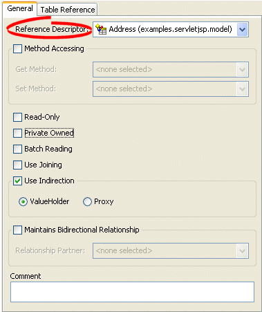

To specify a reference descriptor for an EIS mapping, use this procedure.
Select the mapped attribute in the Navigator. Its properties appear in the Editor.
Click the General tab. The General tab appears.
Figure 54-1 General Tab, Reference Descriptor Field
Use the Reference Descriptor field to select the descriptor referenced by this relationship mapping.
Note: For one-to-one and one-to-many EIS mappings, the reference descriptor must be a root descriptor. See "Configuring an EIS Descriptor as a Root or Composite Type". |
You can specify a reference descriptor that is not in the current TopLink Workbench project. For example, to create a mapping to an Employee
class that does not exist in the current project, do the following:
Add the Employee
class to your current project. See "Working With Projects".
Create the relationship mapping to the Employee
descriptor.
Deactivate the Employee
descriptor. See "Active and Inactive Descriptors".
When you generate the deployment XML for your project, the mapping to the Employee
class will be included, but not the Employee
class itself.

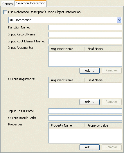

To specify the selection interaction (such as Read Object) for the EIS mapping, use this procedure:
Select the one-to-many EIS mapping in the Navigator. Its properties appear in the Editor.
Click the Selection Interaction tab. The Selection Interaction tab appears.
Use the following information to enter data in each field on the tab:
Field | Description |
Function Name | The name of the EIS function that this call type (Read Object or Read All) invokes on the EIS. |
Input Record Name | The name passed to the J2C adapter when creating the input record. |
Input Root Element Name | The root element name to use for the input DOM. |
Input Arguments | The query argument name to map to the interaction field or XPath nodes in the argument record.
For example, if you are using XML records, use this option to map input argument |
Output Arguments | The result record field or XPath nodes to map to the correct nodes in the record used by the descriptor's mappings.
For example, if you are using XML records, use this option to map the output Output arguments are not required if the interaction returns an XML result that matches the descriptor's mappings. |
Input Result Path | Use this option if the EIS interaction expects the interaction arguments to be nested in the XML record.
For example, specify |
Output Result Path | The name of the EIS function that this call type (Read Object or Read All) invokes on the EIS. |
Properties | Any properties required by your EIS platform. For example, property name operation (from AQPlatform.QUEUE_OPERATION ) and property value enqueue (from AQPlatform.ENQUEUE ). |
