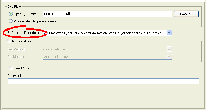

To specify a reference descriptor for an XML mapping that references another descriptor (instead of a schema element), use this procedure.
Select the mapped attribute in the Navigator. Its properties appear in the Editor.
Click the General tab. The General tab appears.
Figure 63-1 General Tab, Reference Descriptor Field
If this XML attribute refers to another descriptor (instead of a schema element), use the Reference Descriptor field to select a descriptor in the project.

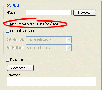

This attribute applies only to TopLink Workbench. Use this option to solve "No XPath specified" problems (see "Using the Problems Window") for an XML mapping that does not need an XPath (see "Configuring XPath") for it maps to a wildcard.
If the XML mapping is owned by an anyType descriptor (see "Configuring for Complex Type of anyType"), it cannot map to a wildcard, and you must specify an XPath.

To specify a map a schema element using the xs:any declaration, use this procedure.
Figure 63-2 Mapping Tab, Maps to Wildcard Option
If the XML mapping is not owned by an anyType descriptor (see "Configuring for Complex Type of anyType") and maps to a wildcard, then you do not need to specify an XPath (see "Configuring XPath"). Select the Maps to Wildcard (uses "any" tag) option to clear the missing XPath neediness message.
If the XML mapping is owned by an anyType descriptor, it cannot map to a wildcard and you must specify an XPath. Deselect the Maps to Wildcard (Uses "any" tag) option and ensure that you specify an XPath.
