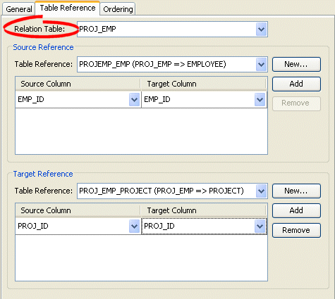

Configuring a Relation Table
The relation table contains the columns for the primary keys of the source table and target table involved in the many-to-many mapping. You must create this table in the database before completing the mapping. See "Working With Databases" for information on creating database tables.
In Figure 33-5, the PROJ_EMP table serves as the relation table between the PROJECT and EMPLOYEE tables.
Using TopLink Workbench
To select a relation table for a mapping, use this procedure:
  1. Select the mapped attribute in the Navigator. Its properties appear in the Editor.
  2. Click the General tab. The General tab appears.
    Figure 40-1 Table Reference Tab, Relation Table Option
    Description of Figure 40-1 follows
    Description of "Figure 40-1 Table Reference Tab, Relation Table Option"
Use the Relation Table field to select a database table to define this mapping.
