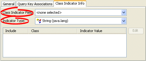

To specify the class indicators for a variable one-to-one mapping, use this procedure:
Select the variable one-to-one mapping in the Navigator. Its attributes appear in the Editor.
Click the Class Indicator Info tab. The Class Indicator Info tab appears.
Use the Class Indicator Field to select the field on the database table (associated with the mapping's descriptor) to use as the indicator for the variable mapping.
Use the Indicator Type to specify the data type of the class indicator field by selecting the data type from the list.
To specify the specific class indicator field values for each (nonabstract) child class, click Edit and enter the appropriate value for each child class.

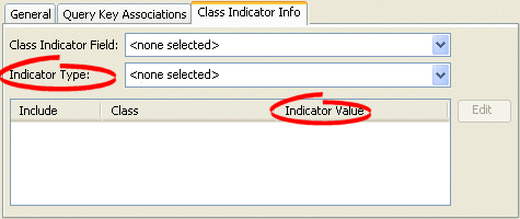

To specify the variable one-to-one mapping with a primary key, use this procedure:
Figure 38-4 Class Indicator Info Tab, Configuring Primary Key
Use the Class Indicator Field to select none.
Use the Indicator Type to select none.
Use the Indicator Value column to specify none.
After choosing the reference descriptor for the mapping, deselect the Include check boxes.

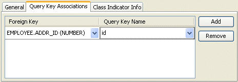

To specify the query keys used for a variable one-to-one mapping, use this procedure:
Click the Query Key Associations tab. The Query Key Associations tab appears
Use the following information to enter data in each field on the tab:
| Field | Description |
| Foreign Key | The field from the database table to use as the foreign key in this relationship. |
| Query Key Name | The name of the query key (from the referenced descriptor) for this association. See "Configuring Query Keys" for more information. |
