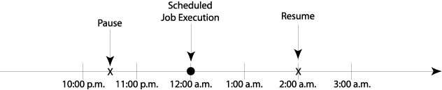

To illustrate more clearly the effect of pausing and resuming a job, consider the following timeline in Figure 5-1.
Figure 5-1 Pausing and Resuming a Job with a Single-Action Schedule
Pause and Resume on a Job with a Single-Action Schedule
Description of "Figure 5-1 Pausing and Resuming a Job with a Single-Action Schedule"
There is a pause implemented for a particular job at around 10:30 p.m., and it is scheduled to resume at 2:00 a.m. However, this job is scheduled to run at 12:00 a.m. Will this job run?
Due to the pause at 10:30 p.m., the job execution scheduled to run at midnight will be skipped. However, if the job is resumed at 2:00 a.m. with replay set to true, then the job execution scheduled to run at midnight will run at 2:00 a.m. If replay is set to false, then the job execution scheduled to run at midnight will not run.

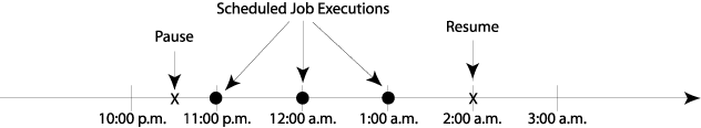

In contrast, consider Figure 5-2, which illustrates the effect of pausing and resuming on a job with a repeating schedule.
Figure 5-2 Pausing and Resuming a Job with a Repeating Schedule
Pause and Resume on a Job with a Repeating Schedule
Description of "Figure 5-2 Pausing and Resuming a Job with a Repeating Schedule"
In this scenario, there is a job with a repeating schedule (multiple job executions scheduled) that falls between pause and resume. If the job is resumed at 2:00 a.m. with replay set to true, then only the first job execution (the one at 11:00 p.m.) will run. The job executions at midnight and 1:00 a.m. will be skipped.
