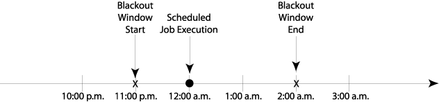

4.2 Jobs Scheduled in Blackout Windows
If a job execution occurs when a blackout window is in effect, the job execution is suppressed. If the job was submitted with a retry period enabled, then the job execution will be retried at the period specified.
Figure 4-1 Jobs Scheduled in a Blackout Window with Retry Period Enabled
Job Execution in a Blackout Window
Description of "Figure 4-1 Jobs Scheduled in a Blackout Window with Retry Period Enabled"
In Figure 4-1, a job execution is scheduled to occur at midnight, which falls in a blackout window starting at 11:00 p.m. and ending at 2:00 a.m. If this job had a retry period enabled, the job execution would be retried at 2:00 a.m., when the blackout window ends. Without the retry period enabled, the jobs execution would be suppressed and no attempt to run the job would be made.
