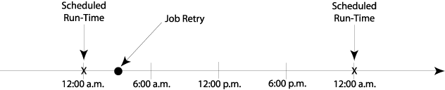

3.2.1 Retry Period
A job execution that fails may be retried after a time period. This time period is called the retry period and is specified in milliseconds. If this period is not set as part of the job definition, the job's executions will not be retried. For example, consider Figure 3-1:
This illustration depicts a repeating schedule, where the job should run each night at midnight. The retry period is three hours, meaning that if the initial job execution fails, the job will be retried again three hours later, at 3:00a.m. If the job execution fails again at 3:00a.m., the job execution for this particular instance is discarded, and another attempt will not be made until the next scheduled run-time (in this case, midnight the following night).

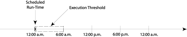

3.2.2 Execution Threshold
If a job's scheduled execution is delayed beyond a specified time threshold, then the job execution will be discarded. This time threshold is called the execution threshold and is specified in milliseconds. If an execution threshold is not specified as part of job's definition, resultant job executions will not be constrained by an execution threshold. For example, consider Figure 3-2:
Figure 3-2 Execution Threshold
Execution Threshold
Description of "Figure 3-2 Execution Threshold"
The job execution is scheduled to run at midnight on Monday, and the execution threshold is 6 hours. The job execution would be discarded if it did not run by 6:00a.m. Monday.
