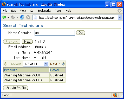

You'll examine the steps involved in building a simple JSF page like the one you see in Figure 1-5 that allows the end user to browse for users by name, scroll through the results, and for each user found, see their areas of technical expertise.
Figure 1-5 Simple Browse Users Page with Search and Master/Detail Data
Simple browse users page with search and master/detail data

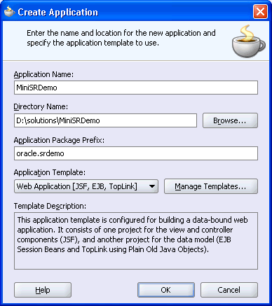

1.2.1.1 Starting by Creating a New Application
The first step in building a new application is to assign it a name and to specify the directory where its source files will be saved. Selecting Application from the JDeveloper New Gallery launches the Create Application dialog shown in Figure 1-6. Here you give the application a name, set a working directory, and provide a package prefix for the classes you'll create in the application. Suppose that you enter a package prefix of oracle.srdemo so that, by default, all of the classes will be created in packages whose names will begin with oracle.srdemo.*. Since you will be building a web application using JSF, EJB, and TopLink, Figure 1-6 shows the corresponding application template selected from the list. This application template is set up to create separate projects named Model and ViewController with appropriate technologies selected to build the respective layers of the application.

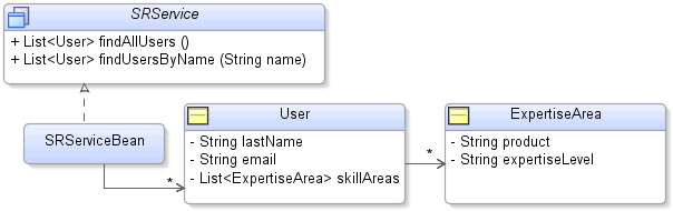

Based on the requirements, suppose the business service needs to support finding users by name. For this purpose, you can use the EJB Session Bean wizard to create a stateless EJB 3.0 session bean using a container-managed transaction. Next you can add a method called findUsersByName() to its local interface that accepts the matching pattern as a parameter called name. To clearly communicate the type of the result and obtain the best compile-time type checking possible, it is best practice to declare the return type of the method to be List<User>, a strongly typed list of User beans. Finally, you can write the method in the SRServiceBean class that implements the service interface. Figure 1-7 shows what the service and its classes look like in the Java class diagram in JDeveloper. You can see that the class also contains the useful findAllUsers() method to return all users if needed.
Figure 1-7 SRService Session Bean Facade and Supporting Domain Classes
SRService Session Bean Façade and supporting domain classes

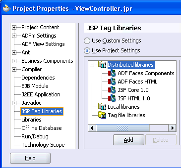

With the data control created, you can begin doing drag-and-drop data binding to create your page. Since you'll be using ADF Faces components in your page, you first ensure that the project's tag libraries are configured to use them. Double-clicking the ViewController project in the Application Navigator brings up the Project Properties dialog where you can see what libraries are configured on the JSP Tag Libraries page. If the ADF Faces Components and ADF Faces HTML libraries are missing, you can add them from here. Figure 1-10 shows the Project Properties dialog with the correction libraries for the ViewController project.
Figure 1-10 Configuring ViewController Project Tag Libraries to Use ADF Faces
configure ViewController project tag libraries for ADF Faces

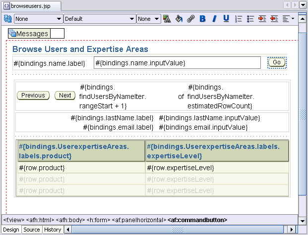

When the Create JSF JSP wizard completes, JDeveloper opens the new page in the visual editor. From there, creating the databound page shown in Figure 1-11 is a completely drag-and-drop experience. As you drop elements from the Data Control Palette onto the page, a popup menu appears to show the sensible options for UI elements you can create for that element.
Figure 1-11 Browse Users JSF Page in the Visual Designer
browse users JSF page in the visual designer
The basic steps to create this page are:
  1. Drop a panelForm component from the ADF Faces Core page of the Component Palette onto the page and set its text attribute in the Property Inspector to "Browse Users and Expertise Areas".
  2. Drop the findUsersByName() method from the Data Control Palette to create an ADF parameter form. This operation creates a panelForm component containing the label, field, and button to collect the value of the name parameter for passing to the method when the button is clicked.
  3. Drop the User return value of the findUsersByName() node from the Data Control Palette to create an ADF read-only form. This operation creates a panelForm component containing the label and fields for the properties of the User bean.
  4. Expand the Operations folder child of the User return value in the Data Control Palette and drop the built-in Previous operation to the page as a command button. Repeat to drop a Next button to the right of it.
  5. Drop the expertiseAreas property nested inside the User return value in the Data Control Palette as an ADF read-only table. Select Enable Sorting in the Edit Table Columns dialog that appears to enable sorting the data by clicking on the column headers.

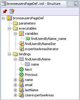

The first time you drop a databound component from the Data Control Palette on a page, JDeveloper will create the page definition file for it. Figure 1-12 shows the contents of the browseusersPageDef.xml file in the Structure window. You can see that an action binding named findUsersByName will be created to invoke the service method of the same name. Iterator bindings named findUsersByNameIter and expertiseAreasIterator will be created to handle the collection of User beans returned from the service method and to handle the nested collection of ExpertiseArea beans. Action bindings named Next and Previous will be created to support the buttons that were dropped. And finally, attribute bindings of appropriate names will be created to support the read-only outputText fields and the table.
Figure 1-12 Page Definition XML File for browseusers.jsp
page definition XML file for browseusers.jsp.

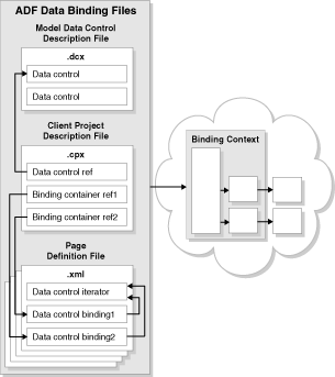

The very first time you perform Oracle ADF Model data binding in a project, JDeveloper creates one additional XML file called DataBindings.cpx that stores information about the mapping between page names and page definition names and lists the data controls that are in use in the project. Figure 1-13 shows what the DataBindings.cpx file looks like in the Structure window. At runtime, this file is used to create the overall Oracle ADF Model binding context. In addition, page map and page definition information from this file are used to instantiate the binding containers for pages as they are needed by the pages the user visits in your application.
Figure 1-13 Structure of DataBindings.cpx
structure of DataBindings.cpx.
For complete details on the structure and contents of the DataControls.dcx, DataBindings.cpx, and PageDef.xml metadata files, see Appendix A, "Reference ADF XML Files".

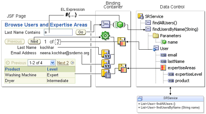

1.2.1.6 Understanding How Components Reference Bindings via EL
As you perform drag-and-drop data binding operations, JDeveloper creates the required ADF Model binding metadata in the page definition and creates the JSF components you've requested. Importantly it also ties the two together by configuring various properties on the components to have EL expression values that reference the bindings. Figure 1-14 summarizes how the components on the page reference the bindings from the page's binding container at runtime.
Figure 1-14 EL Expressions Related Page Components to Bindings
EL expressions related page components to bindings
As a simple example, take the Previous button. When you drop this built-in operation as a button, an action binding named Previous is created in the page definition file, and two properties of the commandButton component are set:
  • actionListener="#{bindings.Previous.execute}"
  • disabled="#{!bindings.Previous.enabled}"
These two EL expressions "wire" the button to invoke the built-in Previous operation and to automatically disable the button when the Previous operation does not make sense, such as when the user has navigated to the first row in the collection.
Studying another example in the page, like the read-only outputText field that displays the user's email, you would see that JDeveloper sets up the following properties on the component to refer to its binding:
  • value="#{bindings.email.inputValue}"
  • label="#{bindings.email.label}"
The combination of these two binding attribute settings tells the component to pull its value from the email binding, and to use the email binding's label property as a display label. Suppose you had configured custom prompts for the User and ExpertiseArea beans in the Model project, the bindings can then expose this information at runtime allowing the prompts to be referenced in a generic way by components on the page.
The drag-and-drop data binding steps above did not account for how the current record display (for example "N of M") appeared on the page. Since information about the current range of visible rows, the starting row in the range, and the total number of rows in the collection are useful properties available for reference on the iterator binding, to create this display, just drop three outputText components from the Component Palette and set each's value attribute to an appropriate expression. The first one needs to show the current row number in the range of results from the findUsersByName method, so it is necessary to set its value attribute to an EL expression that references the (zero-based!) rangeStart property on the findUsersByNameIter binding.
#{bindings.findUsersByNameIter.rangeStart + 1}
The second outputText component just needs to show the word "of", so setting its value property to the constant string "of" will suffice. The third outputText component needs to show the total number of rows in the collection. Here, just a reference to an attribute on the iterator binding called estimatedRowCount is needed.

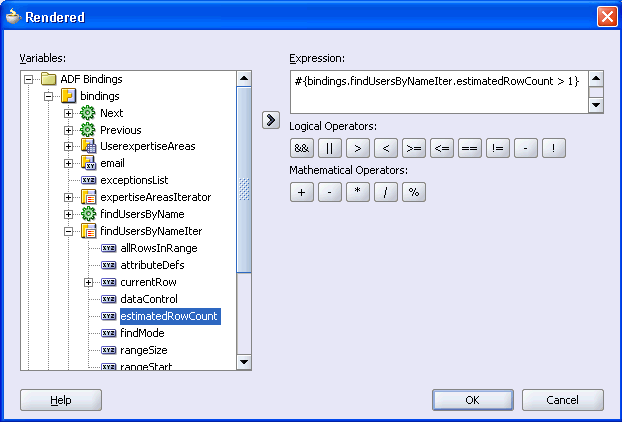

Luckily, this is easy to accomplish. You start by organizing the navigation buttons and the record counter display into a containing panel component like panelHorizontal. After creating the panel to contain them, you can drag and drop in the visual editor, or drag and drop in the Structure window to place the existing controls inside another container. Then, to hide or show all the components in the panel, you just need to set the value of the panel's rendered attribute to a data-driven EL expression.
Recall that the number of rows in an iterator binding's collection can be obtained using its estimatedRowCount property. Figure 1-17 shows the EL picker dialog that appears when you select the panelHorizontal component, click in the Property Inspector on its rendered attribute, and click the ... button. If you expand the bindings for the current page you will see the findUsersByNameIter iterator binding. You can then expand it further to see the most common properties that developers reference in EL. By picking estimatedRowCount and clicking the > button, you can then change the expression to a boolean expression by introducing a comparison operator to compare the row count to see if it is greater than one. When you set such an expression, the panel will be rendered at runtime only when there are two or more rows in the result.
Figure 1-17 Setting a Panel's Rendered Attribute Based on Binding Properties
setting panel rendered attribute based on binding properties

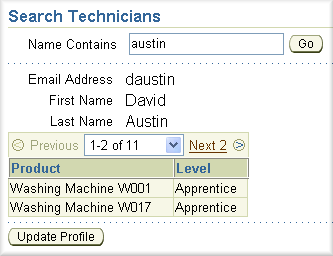

Consider another situation in the sample page. When no rows are returned, by default the read-only form would display its prompts next to empty space where the data values would normally be, and the table of experience areas would display the column headings and a blank row containing the words "No rows yet". To add a little more polish to the application, you might decide to display something different when no rows are returned in the iterator binding's result collection. For example, you might simply display a "No matches. Try again" message as shown in Figure 1-18.
Figure 1-18 Alternative Display If Search Produces Empty Collection
alternative display if search produces empty collection

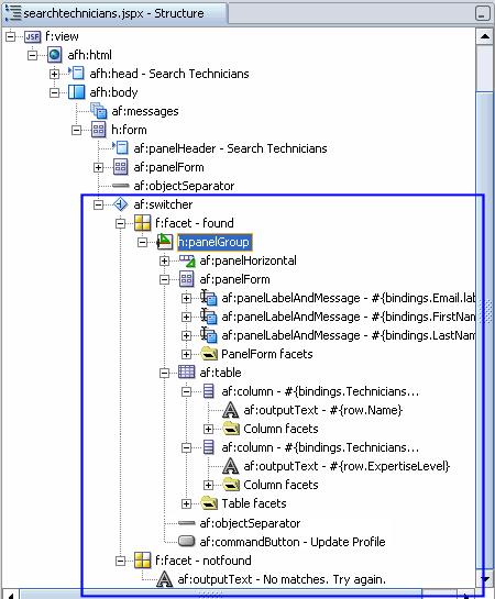

JSF provides a basic feature called a "facet" that allows a UI component to contain one or more named, logical groups of other components that become rendered in a specific way at runtime. ADF Faces supplies a handy switcher component that can evaluate an EL expression in its FacetName attribute to determine which of its facets becomes rendered at runtime. Using this component effectively lets you switch between any groups of components in a dynamic and declarative way. If you group the components that present the user information and experience area table into a panel, then you can use the switcher component to switch between showing that panel and a simple message depending on the number of rows returned.
Figure 1-19 shows the Structure window for the browseusers.jsp page reflecting the hierarchical containership of JSF components after the switcher component is introduced. First, you would set up two JSF facets and give them meaningful names like found and notfound. Then you can organize the existing components into the appropriate facet using drag and drop in the Structure window. In the found facet, you want a panel containing all of the components that show the user and experience area information. In the notfound facet, you want just an outputText component that displays the "No matches. Try again" message.
Figure 1-19 Structure Window View of browseusers.jsp
structure window view of browseusers.jsp.
By setting the facetName attribute of switcher to the EL expression, the found facet will be used when the row count is greater than zero, and the notfound facet will be used when the row count equals zero:
#{bindings.findUsersByNameIter.estimatedRowCount > 0 ?'found':'notfound'}
