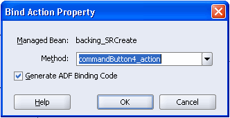

    • If auto-binding has been enabled on the page, the backing bean is already selected for you, as shown in Figure 10-5.
      Figure 10-5 Bind Action Property Dialog for a Page with Auto-Binding Enabled
      Bind Actin Property Dialog for a Page Using Auto-binding
      • To create a new method, enter a name for the method in the Method field, which initially displays a default name.
        OR
      • To use an existing method, select a method from the dropdown list in the Method field.
      • Select Generate ADF Binding Code.

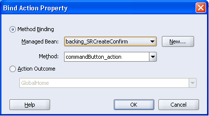

    • If the page is not using auto-binding, you can select from an existing backing bean or create a new one, as shown in Figure 10-6. For more information about auto-binding, see Section 4.5.4, "How to Use the Automatic Component Binding Feature".
      Figure 10-6 Bind Action Property Dialog for a Page with Auto-Binding Disabled
      Bind Action Property dialog for page not using auto-binding
      • Click New to create a new backing bean. The Create Managed Bean dialog is displayed. Use this dialog to name the bean and the class, and set the bean's scope.
        OR
      • Select an existing backing bean and method from the dropdown lists.
