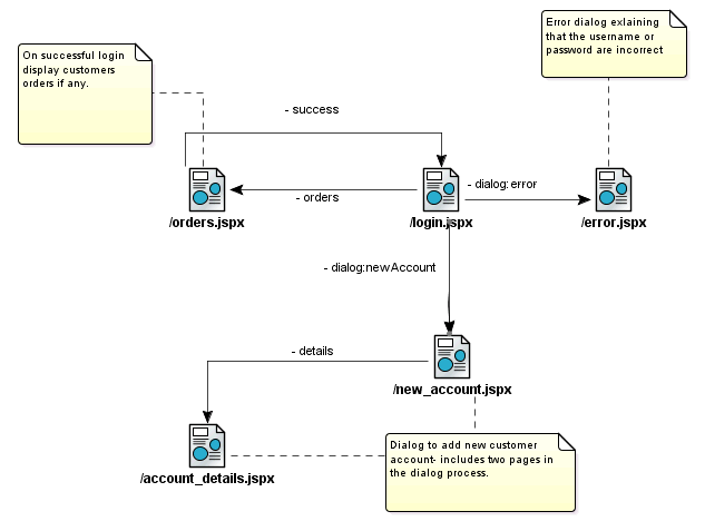

Consider a simple application that requires users to log in to see their orders. Figure 11-3 shows the page flow for the application, which consists of five pages—login.jspx
, orders.jspx
, new_account.jspx
, account_details.jspx
, and error.jspx

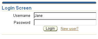

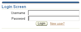

When an existing user logs in successfully, the application displays the Orders page, which shows the user's orders, if there are any. When a user does not log in successfully, the Error page displays in a popup dialog, as shown in Figure 11-4.

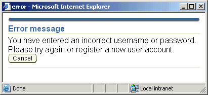

On the Error page there is a Cancel button. When the user clicks Cancel, the popup dialog closes and the application returns to the Login page, as shown in Figure 11-5.

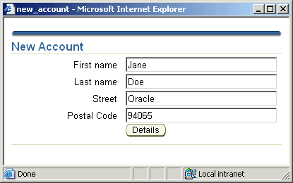

When a new user clicks the New User link on the Login page, the New Account page displays in a popup dialog, as shown in Figure 11-6.

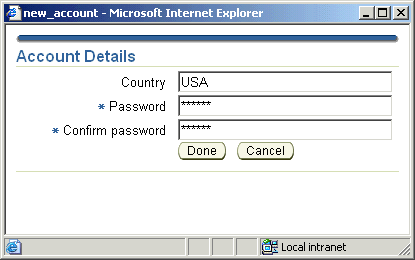

After entering information such as first name and last name, the user then clicks the Details button to display the Account Details page in the same popup dialog, as shown in Figure 11-7. In the Account Details page, the user enters other information and confirms a password for the new login account. There are two buttons on the Account Details page—Cancel and Done.
If the new user decides not to proceed with creating a new login account and clicks Cancel, the popup dialog closes and the application returns to the Login page. If the new user clicks Done, the popup dialog closes and the application returns to the Login page where the Username field is now populated with the user's first name, as shown in Figure 11-8. The new user can then proceed to enter the new password and log in successfully.

You manage the navigation into a popup dialog by defining a standard JSF navigation rule with a special dialog:
outcome. Using the dialog sample application shown in Figure 11-3, three navigation outcomes are possible from the Login page:
Show the Orders page in the same window (successful login)
Show the Error dialog page in a popup dialog (login failure)
Show the New Account dialog page in a popup dialog (new user)
Example 11-16 shows the navigation rule for the three navigation cases from the Login page (login.jspx

The dialog pages in our sample application are the Error page, the New Account page, and the Account Details page. The dialog process for a new user actually contains two pages: the New Account page and the Account Details page. The dialog process for a user login failure contains just the Error page.
A dialog page is just like any other JSF page, with one exception. In a dialog page you must provide a way to tell ADF Faces when the dialog process finishes, that is, when the user dismisses the dialog. Generally, you do this programmatically or declaratively via a command component. Example 11-20 shows how to accomplish this programmatically via a Cancel button on the Error page.
Example 11-20 Cancel Button on the Error Page
<af:commandButton text="Cancel" actionListener="#{backing_error.cancel}" />

The New Account page and Account Details page belong in the same dialog process. A dialog process can have as many pages as you desire, but you only need to call AdfFacesContext.returnFromDialog()
once.

The first page in the new user dialog process is the New Account page. When the Details button on the New Account page is clicked, the application shows the Account Details dialog page in the same popup dialog (because useWindow="false"
), after preserving the state of the New Account page.

In the sample application, a new user can enter a name in the Username field on the Login page, and then click the New User link. When the New Account dialog page displays in a popup dialog, the First Name input field is automatically populated with the name that was entered in the Login page. To accomplish this, you register a launch listener on the command component that launched the dialog (which would be commandLink
). Example 11-27 shows the code for the commandLink
component.
Example 11-27 Input Field and New User Command Link on the Login Page
<af:inputText label="Username" value="#{backing_login.username}"/>
<af:commandLink id="cmdLink" text="New User?"
action="dialog:newAccount"
useWindow="true" partialSubmit="true"
launchListener="#{backing_login.handleLaunch}"
returnListener="#{backing_login.handleReturn}"
windowHeight="200" windowWidth="500" />
The LaunchListener
attribute on commandLink
specifies a reference to a launch listener method in the page's backing bean, Login.java
. In the launch listener method you use the getDialogParameters()
method to add a parameter to a Map
using a key-value pair. Example 11-28 shows the code for the launch listener method.
Example 11-28 Launch Listener Method for the New User Command Link in a Backing Bean
public void handleLaunch(LaunchEvent event)
//Pass the current value of the field into the dialog
Object usr = username;
event.getDialogParameters().put("firstname", usr);
// Use by inputText value binding
public String username;
public String getUsername()
return username;
public void setUsername(String username)
this.username = username;
To show the parameter value in the New Account dialog page, use the ADF Faces processScope
to retrieve the key and value via a special EL expression in the format #{processScope.someKey}
, as shown in Example 11-29.
Example 11-29 Input Field on the New Account Page
<af:inputText label="First name" value="#{processScope.firstname}"/>
Note: You can useprocessScope with all JSF components, not only with ADF Faces components. |
When a command component is about to launch a dialog (assuming all conditions have been met), ADF Faces queues a launch event. This event stores information about the component that is responsible for launching a dialog, and the root of the component tree to display when the dialog process starts. Associated with a launch event is a launch listener, which takes the launch event as a single argument and processes the event as needed.
In the sample application, when ADF Faces delivers the launch event to the launch listener registered on the commandLink
component, the handleLaunch()
method is called and the event processed accordingly.

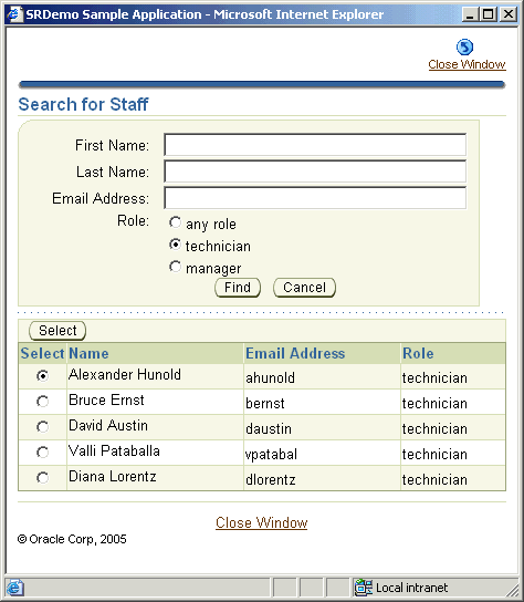

The SRDemo application uses a popup dialog to:
Display a list of frequently asked questions (FAQ).
Select and assign a technician to an open service request.

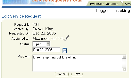

In the Create New Service Request page (see Figure 11-13), when the user clicks the Frequently Asked Questions link, the application displays a popup dialog showing the FAQ list.
In the Edit Service Request page, when the user clicks the flashlight icon next to the Assigned to label (see Figure 11-12), the application displays the Search for Staff popup dialog. In the dialog (as shown in Figure 11-9), the user first makes a search based on user role. Then in the results section, the user clicks the radio button next to a name and clicks Select.
After making a selection, the popup dialog closes and the application returns to the Edit Service Request page where the Assigned to display-only fields are now updated with the selected technician's first name and last name, as shown in Figure 11-10.
To reiterate, the tasks for supporting a popup dialog are (not listed in any particular order):
Create the JSF navigation rules with dialog:
outcomes.
Create the page that launches the dialog via a dialog:
action outcome.
Create the dialog page and return a value.
Handle the return value.
Firstly, the JSF navigation rules for launching dialogs are shown in Example 11-30. The navigation case for showing the dialog page SRStaffSearch.jspx
is defined by the dialog:StaffSearch
outcome; the navigation case for showing the SRFaq.jspx
dialog page is defined by the dialog:FAQ
outcome.
Example 11-30 Dialog Navigation Rules in the faces-config.xml File
<navigation-rule> <from-view-id>/app/staff/SREdit.jspx</from-view-id> ... <navigation-case> <from-outcome>dialog:StaffSearch</from-outcome> <to-view-id>/app/staff/SRStaffSearch.jspx</to-view-id> </navigation-case> </navigation-rule> <navigation-rule> <from-view-id>/app/SRCreate.jspx</from-view-id> <navigation-case> <from-outcome>dialog:FAQ</from-outcome> <to-view-id>/app/SRFaq.jspx</to-view-id> </navigation-case> ... </navigation-rule>
Secondly, the pages that launch popup dialogs are SREdit.jspx
and SRCreate.jspx
. In both pages the useWindow
attribute on the commandLink
component is set to true
, which is a precondition for ADF Faces to know that it has to launch a popup dialog.
Example 11-31 shows the commandLink
component on the page that launches the SRStaffSearch.jspx
dialog page. The commandLink
component has the static action outcome dialog:StaffSearch
Example 11-31 CommandLink Component for Launching the SRStaffSearch Dialog Page
<af:commandLink id="staffLOVLink" action="dialog:StaffSearch"
useWindow="true" immediate="true"
returnListener="#{backing_SREdit.handleStaffLOVReturn}"..>
<af:objectImage height="24" width="24"
source="/images/searchicon_enabled.gif"/>
</af:commandLink>
Example 11-32 shows the commandLink
component on the page that launches the SRFaq.jspx
component has the static action outcome dialog:SRFaq
Example 11-32 CommandLink Component for Launching the SRFaq Dialog Page
<af:commandLink action="dialog:FAQ"
text="#{res['srcreate.faqLink']}"
useWindow="true"
immediate="true"
partialSubmit="true"/>
Thirdly, the dialog pages SRStaffSearch.jspx
and SRFaq.jspx
have to call the AdfFacesContext.returnFromDialog()
method to let ADF Faces know when the user dismisses the dialogs. In SRStaffSearch.jspx
, which uses a table
component with a tableSelectOne
component to display the names for selection, the AdfFacesContext.returnFromDialog()
method is called when the user clicks the Select commandButton
component after selecting the radio button for a technician in the table. The action
attribute on commandButton
is bound to the selectButton_action
action method in the page's backing bean (SRStaffSearch.java
); the action method retrieves the selected row data from the table, extracts the User object, and then returns the object via the AdfFacesContext.returnFromDialog()
method. Example 11-33 shows the code snippets for the Select button component and its action method.
Example 11-33 Action Method for the Select Command Button
<af:tableSelectOne> <af:commandButton text="#{res['srstaffsearch.button.select']}" action="#{backing_SRStaffSearch.selectButton_action}"/> </af:tableSelectOne> ... ... public String selectButton_action() { //get row data from table JUCtrlValueBindingRef selectedRowData = (JUCtrlValueBindingRef)this.getResultsTable().getSelectedRowData(); RowImpl row = (RowImpl)selectedRowData.getRow(); User staffMember = (User)row.getDataProvider(); // And return it AdfFacesContext.getCurrentInstance().returnFromDialog(staffMember, null); // no navigation to another page and thus null is returned return null; }
Similarly in SRFaq.jspx
, a commandLink
component is used to close the dialog and call the AdfFacesContext.returnFromDialog()
method. The af:returnActionListener
tag calls the returnFromDialog
method on the AdfFacesContext
—backing bean code is not needed. Example 11-34 shows the code snippet for the commandLink
. When the user dismisses the SRFaq.jspx
popup dialog, ADF Faces simply closes the dialog. No dialog return value is sent, so there's no need to handle a return value.
Example 11-34 CommandLink Component for Closing the SRFaq Popup Dialog
<af:commandLink text="#{res['srdemo.close']}"> <af:returnActionListener/> </af:commandLink>
When the SRStaffSearch.jspx
popup dialog is dismissed, a dialog return value (that is, the selected row data) is sent as a property of the return event (ReturnEvent
). The return event is delivered to the return listener registered on the commandLink
component of the originating page SREdit.jspx
, as shown in Example 11-35. The returnListener
is bound to the handleStaffLOVReturn
listener method in the page's backing bean (SREdit.java
). The return listener method handles the return value from the dismissed dialog. Example 11-35 also shows the code snippet for the handleStaffLOVReturn
listener method.
Example 11-35 Return Listener Method for Handling the Return Value
<af:commandLink id="staffLOVLink" action="dialog:StaffSearch" useWindow="true" immediate="true" partialSubmit="true" returnListener="#{backing_SREdit.handleStaffLOVReturn}"..> <af:objectImage height="24" width="24" source="/images/searchicon_enabled.gif"/> </af:commandLink> ... ... public void handleStaffLOVReturn(ReturnEvent event) { //Get the return value from the pop up User returnedStaffMember = (User)event.getReturnValue(); if (returnedStaffMember != null) { DCBindingContainer bc = (DCBindingContainer)getBindings(); // Get the handle to the Service Request we are editing DCControlBinding thisSRId = (DCControlBinding)bc.getControlBinding("svrId"); RowImpl srRowImpl = (RowImpl)thisSRId.getCurrentRow(); ServiceRequest thisSR = (ServiceRequest)srRowImpl.getDataProvider(); //See if a different user has been selected? User oldUser = thisSR.getAssignedTo(); if ((oldUser == null) || (!oldUser.equals(returnedStaffMember))) { //Set the returned Staff member from the LOV thisSR.setAssignedTo(returnedStaffMember); //now re-execute the iterator to refresh the screen DCControlBinding accessorData = (DCControlBinding)bc.getControlBinding("assignedToFirstName"); accessorData.getDCIteratorBinding().executeQuery(); //Now reset the Assigned date ADFUtils.setPageBoundAttributeValue(getBindings(), "assignedDate", new Timestamp(System.currentTimeMillis())); //And get the data field to update with the new bound value this.getAssignedDate().resetValue(); } } }
