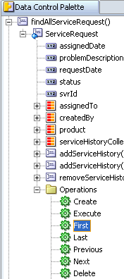

From the Data Control Palette, select the operation associated with the collection of objects on which you wish the operation to execute, and drag it onto the JSF page.
For example, if you want to navigate through service requests, you would drag the Next operation associated with the ServiceRequest collection of the findAllServiceRequest() method. Figure 6-7 shows the navigation operations associated with a collection.
