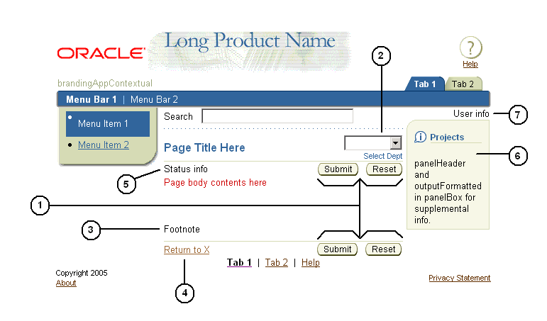

Most of the SRDemo pages use the ADF Faces panelPage component to lay out the entire page. The panelPage component lets you define specific areas on the page for branding images, navigation menus and buttons, and page-level or application-level text, ensuring that all web pages in the application will have a consistent look and feel. Figure 4-5 shows an example of a page created by using a panelPage component.

Figure 4-8 shows panelPage facets (numbered 1 to 7) for laying out page-level actions and text.
Table 4-4 shows the panelPage facets (as numbered in Figure 4-8), and the preferred children components that you could use in them.
Table 4-4 PanelPage Facets for Page-Level Actions and Informational Text
| No. | Facet | Description |
1 |
For page-level actions that operate on the page content. Typically use with a |
2 |
A context switcher lets the user change the contents of the page based on the context. For example, when a user is viewing company assets for a department, the user can use the context switcher to switch to the assets of another department. All the pages will then change to the selected context. Typically use with a |
3 |
For page-level information that is ancillary to the task at hand. Typically use with an |
4 |
For a "Return to X" link using |
5 |
For page-level status information about the task at hand. Could also use to provide a key notation. A key notation is a legend used to define icons, elements, or terms used within the page contents. Typically use with an |
6 |
For any other additional information. Typically use with a |
7 |
For presenting user login and connection information. Typically use with an |
Tip: LikepanelPage, the page component also lets you lay out an entire page with specific content areas. Unlike panelPage, you can bind the value of page to a menu model object to create the page's hierarchical menus—you don't have to bind individual menu components to a menu model object. |
