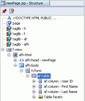

  1. With your page displayed in the Design page of the visual editor, open the Structure window.
    Tip:
    You can drop the data control object on the component displayed in the Design page of the visual editor, but using the Structure window provides greater accuracy and precision. For example, if you try dropping a data control object on a component in the visual editor and do not get the Bind Existing <component name> option in the context menu, this means you did not drop the data control on the correct tag in the visual editor. In this case, try using the Structure window where each tag is clearly delineated.
  2. In the Design page of the visual editor, select the UI component to which you want to add ADF bindings.
    The component must be one of the tags listed in Table 13-1. When you select a component in the visual editor, JDeveloper simultaneously selects that component tag in the Structure window, as shown in Figure 13-1. Use the Structure window to verify that you have selected the correct component. If the incorrect component is selected, make the adjustment in the Structure window.
    Figure 13-1 Structure Window with Tag Selected
    Structure window with tag selected

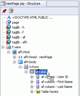

  3. Drag the appropriate data control object from the Data Control Palette to the Structure window and drop it on the selected UI component. (For information about the nodes on the Data Control Palette, see Section 5.2.1, "How to Understand the Items on the Data Control Palette".)
    Tip:
    As you position the data control object over the UI component in the Structure window, a horizontal line with an embedded up or down arrow appears at the top or bottom of the component, as shown in Figure 13-2. Whenever either of these lines appears, you can drop the data control object: in this case, it does not matter which direction the arrow is pointing.
    Figure 13-2 Dropping a Data Control Object on a UI Component in the Structure Window
    Dropping a data control in the Structure window.
