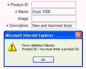

In Example 12-2, the image attribute is not required. However, all other columns are required, as set by the mandatory property. This is denoted in the web page by asterisk icons. Figure 12-2 shows the error message displayed if no data is entered for the product ID, and if client-side validation is enabled.
Figure 12-2 Client-Side Error for a Required Value
Error message displays in a popup dialog
If the submitted value is a non-null value or a string value of at least one character, the validation process continues and all validators on the component are called one at a time. Because the af:validator tag on the component is bound to the validator property on the binding, any validation routines set on the model are also accessed and executed at this time.

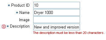

The lifecycle then jumps to the Render Response phase and redisplays the current page. ADF Faces automatically displays an error icon next to the label of any input component that generated an error, and it displays the associated messages below the input field. If there is a tip associated with the field, the error message displays below the tip. Figure 12-3 shows a server-side validation error.
Figure 12-3 Server-Side Validation Error
Error message displays below component
