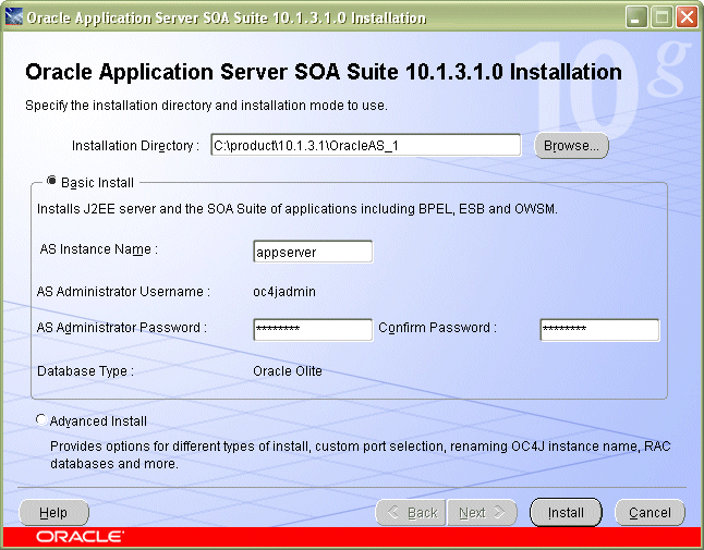

Oracle Application Server SOA Suite 10.1.3.1.0 Installation Screen
Figure 4-1 Oracle Application Server SOA Suite 10.1.3.1.0 Installation Screen
Installation Directory: Enter the directory where you want install Oracle Application Server.
Select Basic Install.
AS Instance Name: The instance name identifies this Oracle Application Server instance. If you have more than one Oracle Application Server instance on the same host, the instances must have unique names.
AS Administration Username: The administration username for Oracle Application Server instances is set to oc4jadmin and cannot be changed. To manage Oracle Application Server instances using Oracle Enterprise Manager 10g, log in as the oc4jadmin user.
AS Administration Password and Confirm Password: Enter the password for the oc4jadmin user.
Database Type: An Oracle Database Lite (Olite) is installed with the basic installation. If you want to use another an existing Oracle Database or a Real Application Clusters database, you must perform an advanced installation.
Click Install.
