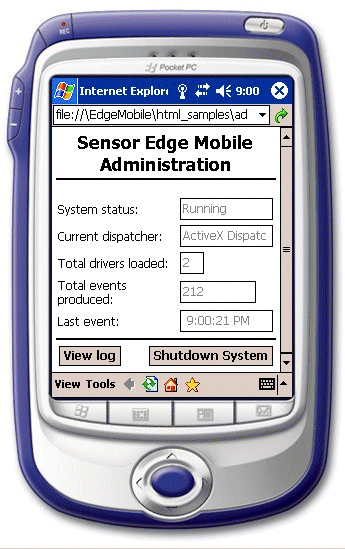

Figure 5-1 Oracle Sensor Edge Mobile Administration Page on a Handheld Device
Description of Figure 5-1 follows
Description of "Figure 5-1 Oracle Sensor Edge Mobile Administration Page on a Handheld Device"

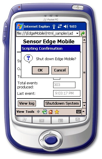

Managing Sensor Edge Mobile
The Administration HTML page (Figure 5-1) enables you to manage Oracle Sensor Edge Mobile. Using this page, you can perform the following tasks:
