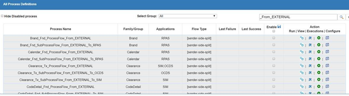

  1. Search for "_From_EXTERNAL" and uncheck the Hide Disabled process checkbox.
    Figure 4-1 View _From_EXTERNAL Processes

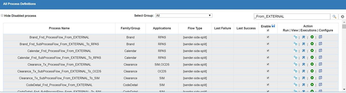

  2. Click the header checkbox to enable/disable. The default is disabled.
  3. Click a second time on the header checkbox to make it enable/disable. Click the Save icon. The flag is updated in the database to "true" or enabled.
    Figure 4-2 Enable _From_EXTERNAL Processes

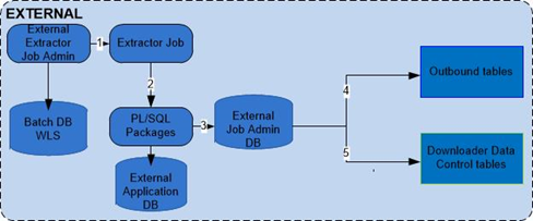

External Extractor Job
The Extractor Job uses a batchlet and PL/SQL stored procedures to move data from transactional tables of source system (for example EXTERNAL, third party system) to outbound tables. A PL/SQL stored procedure calls BDI PL/SQL stored procedure to insert data set information in the outbound data control tables. Extractor jobs are currently implemented to provide full data (not delta) for an interface. Whichever application is acting as Sender those teams have to write business logic to move data from application transaction tables to BDI OUT tables.
Figure 4-3 External Extractor Job

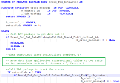

For each required interface, implement the logic in "extract" function of the "<InterfaceModule_Name>_Extractor_Body.sql" file as in the indicated section below. The sql file is located in the <bdi-edge-external-job-home>/setup-data/ddl/ folder.
Surrounding text describes create_replacepackage.png.
BDI Extractor (PL/SQL Application)
  1. The Extractor job is run from the App A (for example EXTERNAL) Extractor Job Admin application through REST or the UI.
  2. The Extractor job invokes the PL/SQL stored procedure in the App A database.
  3. A PL/SQL stored procedure is run in the App A database.
  4. The PL/SQL stored procedure moves data from transactional tables to the outbound tables in the BDI schema.
  5. The PL/SQL stored procedure inserts entries in downloader data control tables to indicate the data set is ready for download.
    The Downloader Data Control Tables act as a handshake between the Extractor and the Downloader. There are two Outbound Data Control Tables:
    • BDI_DWNLDR_IFACE_MOD_DATA_CTL
    • BDI_DWNLDR_IFACE_DATA_CTL
    The Extractor job inserts entries in the downloader data control tables to indicate that data is ready to be downloaded after it completes moving data to outbound interface tables.

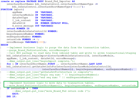

For each required interface, implement the logic in the "import" function of the "<InterfaceModule_Name>_Importer_Body.sql" file as in the indicated section below. The sql file is located in <bdi-edge-external-job-home>/setup-data/ddl/ folder.

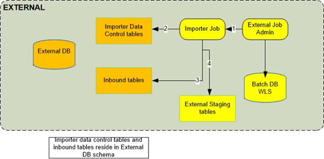

External Importer
  1. Importer job is run from App B EXTERNAL Job Admin application through REST or UI.
  2. Importer job checks for data sets in importer data control tables.
  3. If data set is available for import, importer job downloads data from inbound table.
  4. Importer job loads data to App B EXTERNAL staging tables.

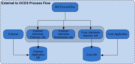

External BDI Process Flow
A process flow is a generic concept and is not limited to BDI. However all the out-of-box process flows are for data transfers from a retail application to one or more retail applications.

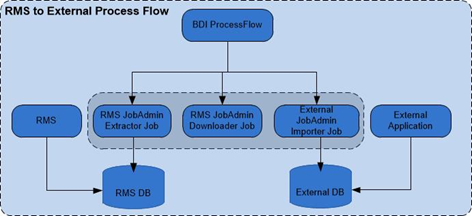

There are process flow dsl files for each interface from RMS to external and External to other applications which have all the activities for the particular interface as depicted in below pictures. Scheduler will trigger the process flow to execute the activities within the dsl file. Process flows are available out of box to move data end to end. Only thing to implement is extractor or importer packages or both.
Figure 4-5 Merchandising to External Process Flow
Figure 4-6 External Application to OCDs Process Flow
