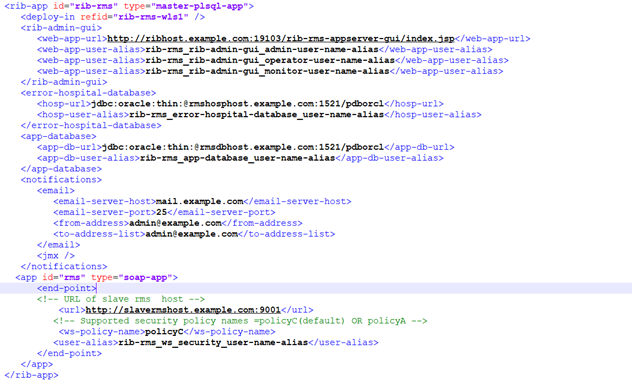

  7. Replace the existing rib-app with copy of commented hybrid cloud installation section for rib-rms.
    Example (this is also available on deployment XML as commented snippet):
    Figure 9-1 Commented Hybrid Cloud Installation XML Snippet
    RMS retail app type is "soap-app". RIB app (rib-rms) type is "master-plsql-app".

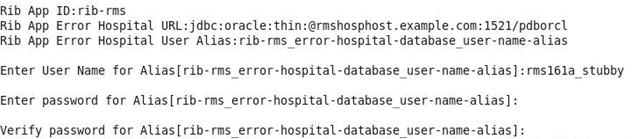

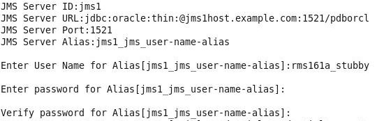

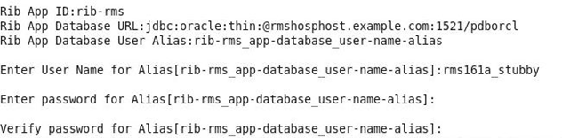

  8. Compile: Run the rib-home/application-assembly-home/bin/rib-app-compiler.sh script with setup-security-credential from rib-home/application-assembly-home/bin directory.
    Example: ./rib-app-compiler.sh -setup-security-credential
    For rib-rms give the same schema details for Error Hospital (EH) and app-DB
    Figure 9-2 Compilation Example - AQ Details
    Figure 9-3 Compilation Example - EH Details
    Figure 9-4 Compilation Example - App DB Details

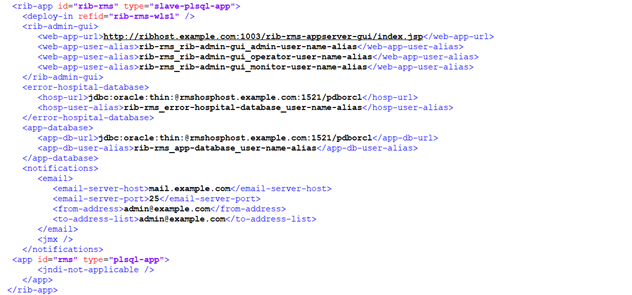

    Make sure following entries are present in the rib-app section of rib-rms slave:
    Figure 9-5 rib-app Section of rib-rms Slave
