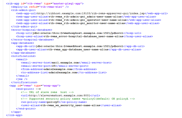

Edit rib-home/deployment-home/conf/rib-deployment-env-info.xml file to specify the deployment environment information.
Under <app-in-scope-for-integration> change RWMS from plsql-app to master-plsql-app:
<app id="rwms" type="master-plsql-app" />
Replace the existing rib-app with copy of commented hybrid cloud installation section for rib-rwms.
Example (this is also available on deployment XML as commented snippet):
Note: RWMS retail app type is "soap-app". RIB app (rib-rwms) type is "master-plsql-app". |

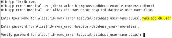

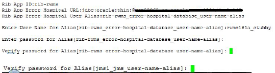

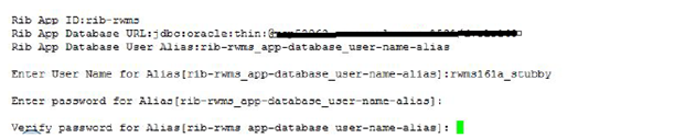

For rib-rwms give the same schema details for Error Hospital (EH) and app-DB as follows:

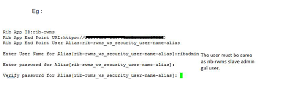

There are two new webservices added in RIB that allow the master to communicate with slaves.
Publication – RemotePlsqlPublisherComponentServiceBeanService
Subscription – PlsqlApplicationMessageInjectorServiceBeanService
RIB supports policyA and poilicyC service provider. By default webservices are secured with policyC (http-or-https-username-token).
The compilation step prompts you to enter the user/password for the alias " rib-rwms_ws_security_user-name-alias" used for service calls. The credential should be the same as for "rib-rwms_rib-admin-gui_admin-user-name-alias" on the slave side.

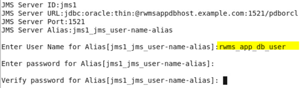

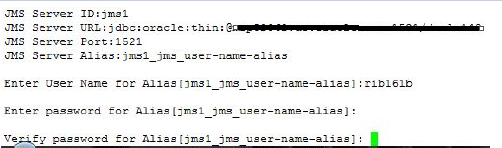

Update rib-jms-servers section to provide the AQ JMS server details. Because the slave app deploys on premise, it will not have access to AQ JMS on cloud. Use RWMS app schema detail for AQ JMS setup. For example:

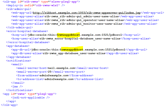

Make sure datasource url (host, port n service) entries are updated in the rib-app section of rib-rwms slave:
Note: As the slave app deploys on premise, it will not have access to AQ JMS and Error hospital. Therefore, all the datasources must connect to the RWMS app schema. |

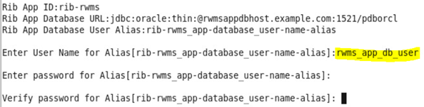

Compile: Run the rib-home/application-assembly-home/bin/rib-app-co mpiler.sh script with setup-security-credential from rib-home/application-assembly-home/bin directory.
Example: ./rib-app-compiler.sh -setup-security-credential
Note: When the slave app deploys on-premise, it will not have access to AQ JMS and Error hospital. Therefore, both datasources must connect to the RWMS app schema. |
