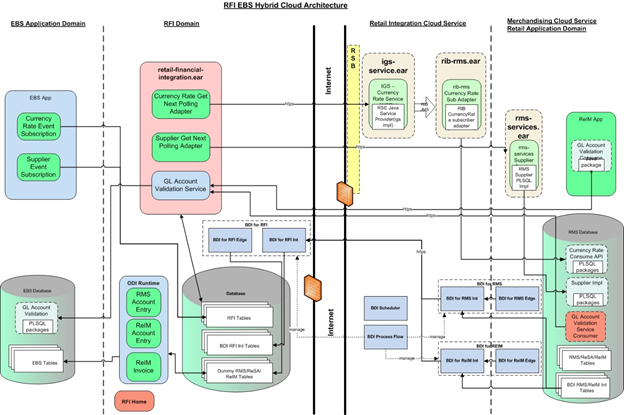

This chapter includes:
As part of hybrid cloud integration between retail apps and EBS, the retail applications are on cloud setup and EBS is on-premise. The Oracle Retail Financial Integration (RFI) layer serves as an intermediate thin layer of application between the financial application (EBS) and Oracle Retail. This integration remains synchronized with the new releases of the edge applications.
The integration mainly depends on the participating application whether it's an on-prem or cloud solution that decides which deployment topology to be followed.
There are two different types' of integration deployment topologies.
On-Premise Deployment Topology
Hybrid Cloud Deployment Topology
This section mainly talks about Hybrid cloud architecture and its implementation in detail.
On-Premises Deployment Topology
On-premises solutions (on-prem) are deployed in the traditional manner. Servers are acquired, operating systems are installed, other hardware may be involved, but all of that lives within the walls of datacenter.
Both Retail Applications and Financial Applications (EBS/PeopleSoft) should be on premise solutions.
Data flow is bidirectional.
Both Service-based integration and ETL-based integration works fine
Hybrid cloud deployment provides computing environment which uses a mix of on- premises and cloud services with orchestration between the two platforms. By allowing workloads to move between two platforms as computing needs and costs change, hybrid cloud gives businesses greater flexibility and more data deployment options.
Retail Applications (i.e. RMS/ReIM) are on cloud and Financial Applications (EBS/PeopleSoft) are on premise.
Only Service-based integration works fine and there is a little modification in existing ETL-based integration to work in hybrid cloud.
