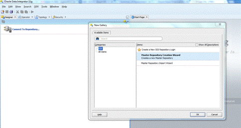

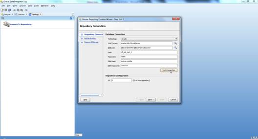

  1. Launch Oracle Data Integrator (ODI) Studio to create a Master Repository:
    Click File->New and select "Master Repository Creation Wizard" and click OK.
    Figure 10-1 Master Repository Creation Wizard
    Surrounding text describes Figure 10-1 .

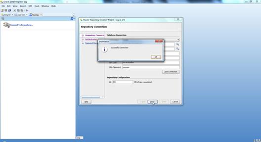

  2. Enter the Master Repository Database connection details and click Next.
    • Database Connection - Enter valid Master Repository schema details.
      In JDBC url field, use the OdiMasterDataSource/ jdbcUrl entered in rfi-deployment-env-info.json file. You have to enter sysdba credentials in DBA User and DBA Password fields.
    • Repository Configuration - Enter any ID other than 804 or 805 in the Id field.
      Figure 10-2 Repository Configuration
      Surrounding text describes Figure 10-2 .

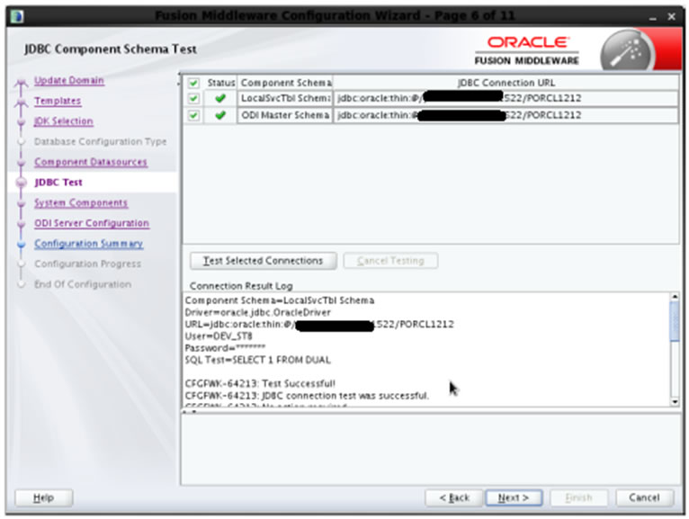

  3. Test your credentials information using the Test Connection button. If you are successful, click OK in the Information popup and then click Next.
    Figure 10-3 Test Connection
    Surrounding text describes Figure 10-3 .

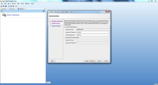

  4. Enter <supervisor password> and click Next.
    This password will be used in further installation steps, so keep a record of it.
    Figure 10-4 Authentication
    Surrounding text describes Figure 10-4 .

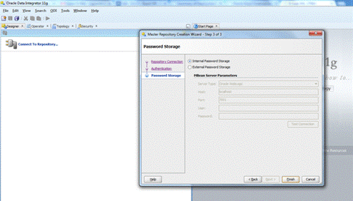

  5. Click Finish.
    Figure 10-5 Password Storage
    Surrounding text describes Figure 10-5 .

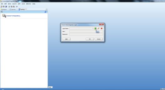

  1. Select the ODI Menu->Connect option to log in to the Master Repository in Oracle Data Integrator (ODI) Studio to create a Work Repository.
  2. Create Master Repository login credentials by selecting the + button from the Oracle Data Integrator Login dialog.
    Figure 10-6 Oracle Data Integrator Login
    Surrounding text describes Figure 10-6 .

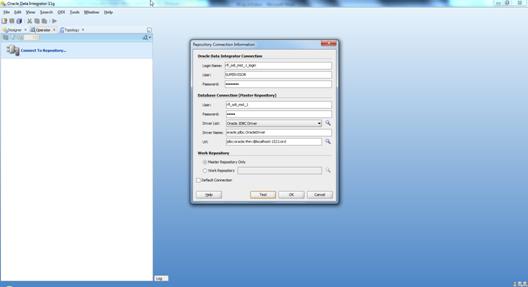

  3. Update the Repository Connection Information as below:
    1. Oracle Data Integrator Connection:
      • Login Name: <Login Name>
      • User: <Enter "SUPERVISOR" in this field>
      • Password: <supervisor password>
      See ODI documentation for information on users with the correct (supervisor level) permissions. The SUPERVISOR user is created by ODI and has the correct permissions by default.
    2. Database Connection (Master Repository):
      • Enter Master Repository database credentials for User and Password fields.
      • Select "Oracle JDBC Driver" from the drop-down list for Driver List field.
      • Enter Url (use the OdiMasterDataSource/ jdbcUrl entered in rfi-deployment-env-info.json file) field as shown below:
        jdbc:oracle:thin:@<host>:<port>:<sid>
    3. Work Repository:
      • Select the Master Repository Only option.
        Figure 10-7 Repository Connection Information
        Surrounding text describes Figure 10-7 .

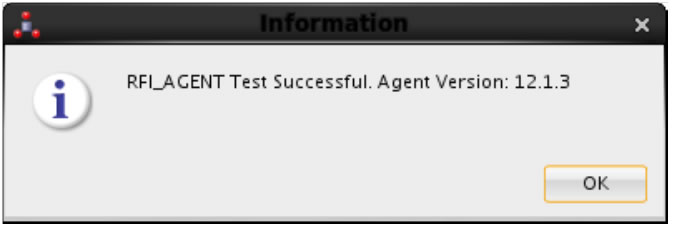

  4. Test your credentials information using the Test button. If you are successful then click OK.
    Figure 10-8 Test
    Surrounding text describes Figure 10-8 .

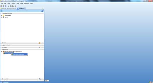

  6. From the Topology tab, select Repositories and then right-click on the Work Repositories. Select the New Work Repository option.
    Figure 10-10 Repositories
    Surrounding text describes Figure 10-10 .

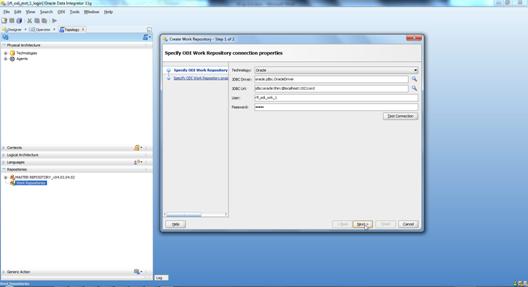

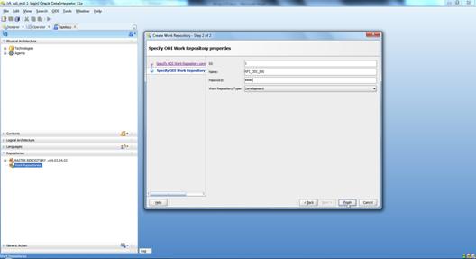

  7. Enter the work repository database credentials details.
  8. Test your credentials information using the Test button. If you are successful then click Next.
    Figure 10-11 Test
    Surrounding text describes Figure 10-11 .
  9. Update ODI Work Repository properties:
    1. Enter any ID other than 804 or 805 (For EBS integration) / 501 or 502 (For PeopleSoft Integration) in the Id field.
    2. Enter Name and Password (should be SUPERVISOR user and <supervisor password>) for work repository and click Finish.
      Figure 10-12 ODI Work Repository
      Surrounding text describes Figure 10-12 .

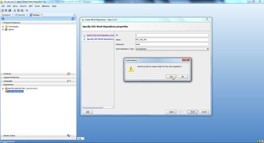

  10. Click Yes to create an ODI login for the work repository.
    Figure 10-13 Confirmation
    Surrounding text describes Figure 10-13 .

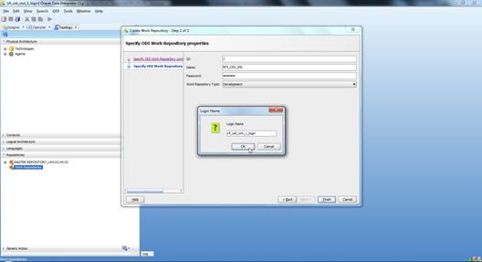

  11. Enter the ODI work repository login name in the dialog.
    Figure 10-14 Login Name
    Surrounding text describes Figure 10-14 .

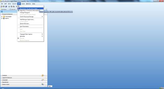

  12. Select the ODI Menu->Disconnect option to connect to the Work Repository.
    Figure 10-15 Disconnect
    Surrounding text describes Figure 10-15 .

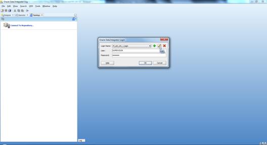

  13. Select the ODI Menu->Connect option.
    1. From the ODI Login popup, select Login Name from dropdown list (select the name you created in step7).
    2. Enter user as "SUPERVISOR".
    3. Enter <supervisor password>.
    4. Select the Edit option.
      Figure 10-16 Connect
      Surrounding text describes Figure 10-16 .

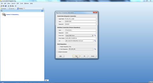

  14. Validate the Repository Connection Information:
      • Login Name: <work repository login name>
      • User: <"SUPERVISOR">
      • Validate the Master Repository database details.
    3. Work Repository
      • Select the Work Repository option and select the repository you just created.
        Figure 10-17 Repository Connection Information
        Surrounding text describes Figure 10-17 .
  15. Test your credentials information using the Test button. If you are successful then click OK.
    Figure 10-18 Test
    Surrounding text describes Figure 10-18 .

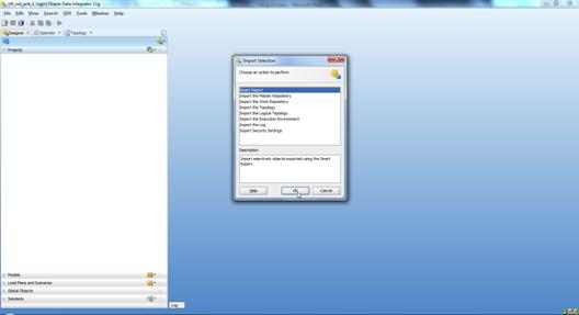

  2. Select the Import option from the Designer tab.
    Figure 10-20 Import
    Surrounding text describes Figure 10-20 .
  3. Select the Smart Import option on the Import Selection dialog and click OK.

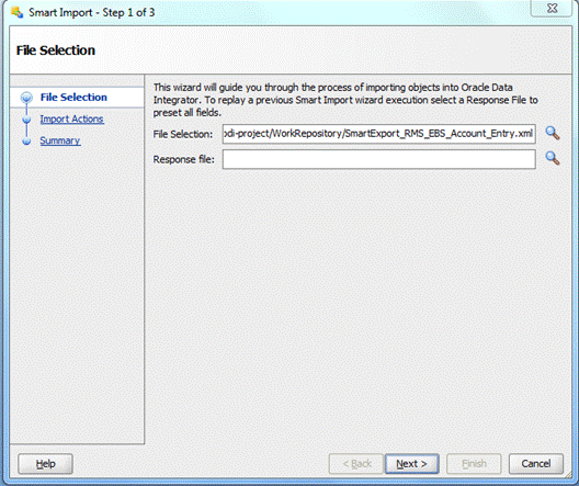

  4. If integration is with EBS, then
    Select SmartExport_RMS_EBS_Account_Entry.xml file in the File Selection Field and click Next. This file can be found in $INSTALL_DIR/retail-financial-integration-solution/etl-based-integration/retail-to-ebsfin-etl-flows/retail-to-ebsfin-odi-project/WorkRepository/.
    If integration is with PeopleSoft, then
    • Select SmartExport_RMS_PSFT_Account_Entry.xml file in the File Selection Field and click Next. This file can be found in $INSTALL_DIR/retail-financial-integration-solution/etl-based-integration/retail-to-psftfin-etl-flows/retail-to-psftfin-odi-project/WorkRepository/.
      Figure 10-22 Smart Import - Step 1 of 3
      Surrounding text describes Figure 10-22 .

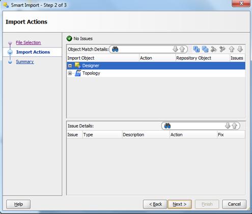

  5. Click Next.
    Figure 10-23 Smart Import - Step 2 of 3
    Surrounding text describes Figure 10-23 .

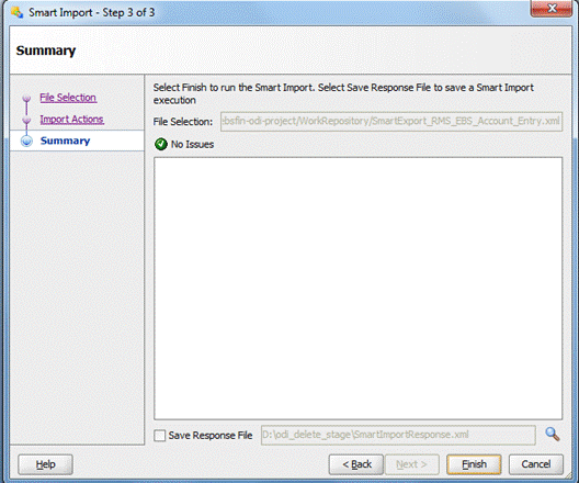

  6. Click Finish.
    Figure 10-24 Smart Import - Step 3 of 3
    Surrounding text describes Figure 10-24 .

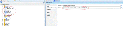

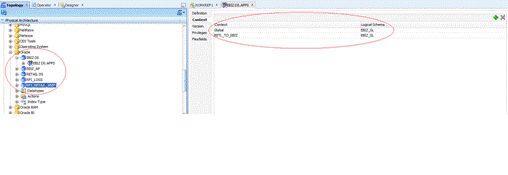

Update Connection Information
For EBS Integration:
In Topology, under Physical Architecture, Technologies -> Oracle, update the Database Connection details in the Physical Server and Physical schema as shown in the table below.
Figure 10-25 Database Connection Details
Surrounding text describes Figure 10-25 .
Table 10-1 Database Connection Details - Physical Server and Physical Schema
Physical Server (Data Server) Physical Schema
Name
Definition > Connection
JDBC
Schema (Schema)
Schema (Work Schema)
EBIZ DS
User: <APPS Schema Name>
Password: <APPS Schema Password>

Update ORFI JDBCUrl
ORFI Schema
ORFI Schema
  1. For EBIZ DS, EBIZ_AP, provide the E-Business Suite database connection.
  2. For RETAIL DS, provide the Retail database connection.
  3. For RFI_LOGS, RFI_RETAIL_XREF provide the ORFI Infrastructure database connection.
  4. Click Test Connection on the physical server to verify that the connection information is correct.
  5. In the physical schema, verify that the context (Global and RETL_TO_EBIZ) is mapped to the logical schemas as shown in the table below. If the mapping is missing, map the logical schemas as shown in the table below.
    Figure 10-26 Verify
    Surrounding text describes Figure 10-26 .
Table 10-2 Logical Schema Mapping
Physical Schema Logical Schema
EBIZ DS.APPS
EBIZ_GL
EBIZ_AP.AP
EBIZ_AP
RETAIL DS.RMS Or BDI_RFI_EDGE_SCHEMA (On Hybrid Cloud)
Retail
RFI_LOGS.RFI
RFI_LOGS
RFI_RETAIL_XREF.RFI
RFI_RETAIL_XREF
For PeopleSoft Integration:-
Table 10-3 Database Connection Details - Physical Server and Physical Schema
Name
JDBC
Schema (Schema)
PEOPLESOFT DS
Update PeopleSoft JDBCUrl
SYADM Schema
RFI_ODI_TEMP Schema
RETAIL DS
User: <RMS User Schema Name>
Password: <RMS User Schema Password>
Update RMS JDBCUrl
RMS Schema Owner
RMS Schema Owner
RFI_LOGS
User: <ORFI Schema Name>
Password: <ORFI Schema Password>
Update ORFI JDBCUrl
ORFI Schema
ORFI Schema
RFI_RETAIL_XREF
Update ORFI JDBCUrl
ORFI Schema
ORFI Schema
  1. For PEOPLESOFT DS, provide the PeopleSoft Suite database connection.
  5. In the physical schema, verify that the context (Global and RETL_TO_PSFT) is mapped to the logical schemas as shown in the table below. If the mapping is missing, map the logical schemas as shown in the table below.
Table 10-4 Logical Schema Mapping
PEPOPLESOFT DS.SYSADM
PeopleSoft
RETAIL DS.RMS01
Retail
RFI_LOGS.RFI01
RFI_LOGS
RFI_RETAIL_XREF.RFI01
RFI_RETAIL_XREF

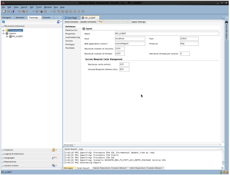

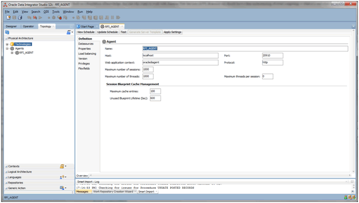

In ODI Topology, navigate to Physical Architecture -> Agents.
Make sure the RFI_AGENT is available and default to port 20910
Figure 10-27 Agents
Surrounding text describes Figure 10-27 .

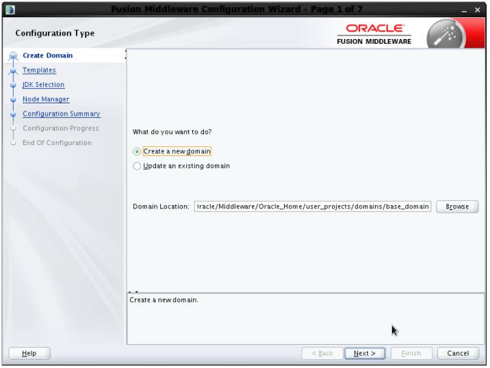

Run Agent Scheduler
The following steps are provided as guidance and can be found in ODI documentation.
These graphical UI steps will guide you for standalone ODI agent configuration, starting and testing the agent. ODI 12c agent configuration is now graphical wizard tool. The domain is similar to WLS domain.
  1. Navigate to <odi install directory>Oracle/Middleware/Oracle_Home/odi/common/bin.
    In Unix:
    ./config.sh
    For Windows:
    The configuration wizard pops up. Select the "Create a new domain" option.
    Figure 10-28 Configuration Type Window
    Surrounding text describes Figure 10-28 .
  2. After providing/choosing the domain location, Click Next.

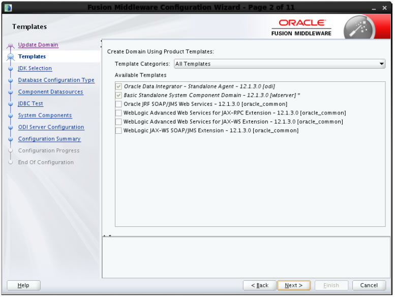

    Figure 10-29 Templates Window
    Surrounding text describes Figure 10-29 .
  3. Chose the first checkbox, Oracle Data Integrator-Standalone Agent -12.2.1.4.

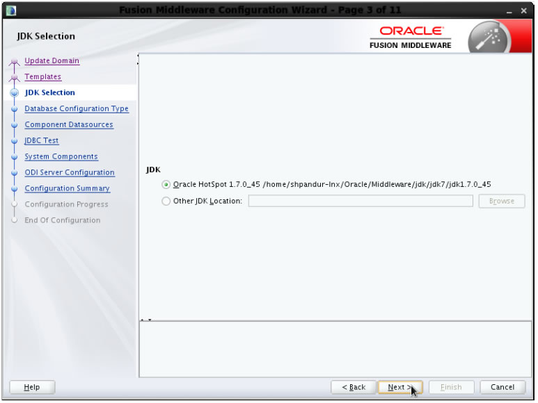

    Figure 10-30 JDK Selection Window
    Surrounding text describes Figure 10-30 .
  4. Chose the JDK path.

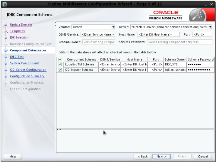

  5. Enter DBMS/Service information (not a database instance) example orcl.example.com and enter DB host name, port information.
    Figure 10-31 JDBC Component Schema Window
    Surrounding text describes Figure 10-31 .
  6. Enter dev_stb schema hostname, service and port information and also password, this is the services related table that would be been created using RCU. Enter similar information for ODI master schema.
    Figure 10-32 JDBC Component Schema Test Window
    Surrounding text describes Figure 10-32 .

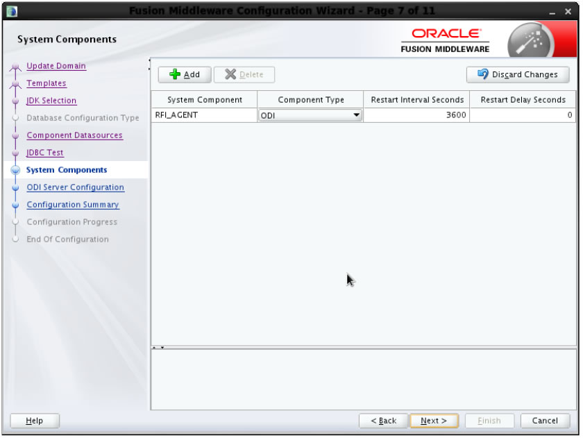

    Figure 10-33 System Components Window
    Surrounding text describes Figure 10-33 .

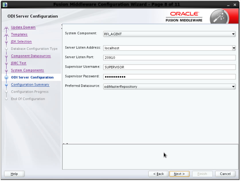

    Figure 10-34 ODI Server Configuration Window
    Surrounding text describes Figure 10-34 .

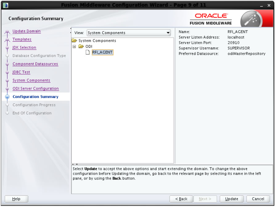

    Figure 10-35 Configuration Summary Window
    Surrounding text describes Figure 10-35 .
To start the RFI_AGENT agent
Navigate to location where you created the odi base domain, refer to first step.<Domain home>Oracle/Middleware/Oracle_Home/user_projects/domains/base_domain/bin and type.
agent.sh -NAME=RFI_AGENT -PORT=20910
You should see:
<date and time> NOTIFICATION ODI-1111 Agent RFI_AGENT started. Agent version: 12.2.1.4 - date. Port: 20910. JMX Port: 21910.
Do not close the window.
To test if the agent is successfully running:
Log into ODI with appropriate credentials and navigate to Topology tab. On the physical agent section, expand Agents, and click on RFI_AGENT. On the right pallet, click on 'Test' tab.
Figure 10-36 Test Tab
Surrounding text describes Figure 10-36 .
You should see this message.
Figure 10-37 Test Message
Surrounding text describes Figure 10-37 .
