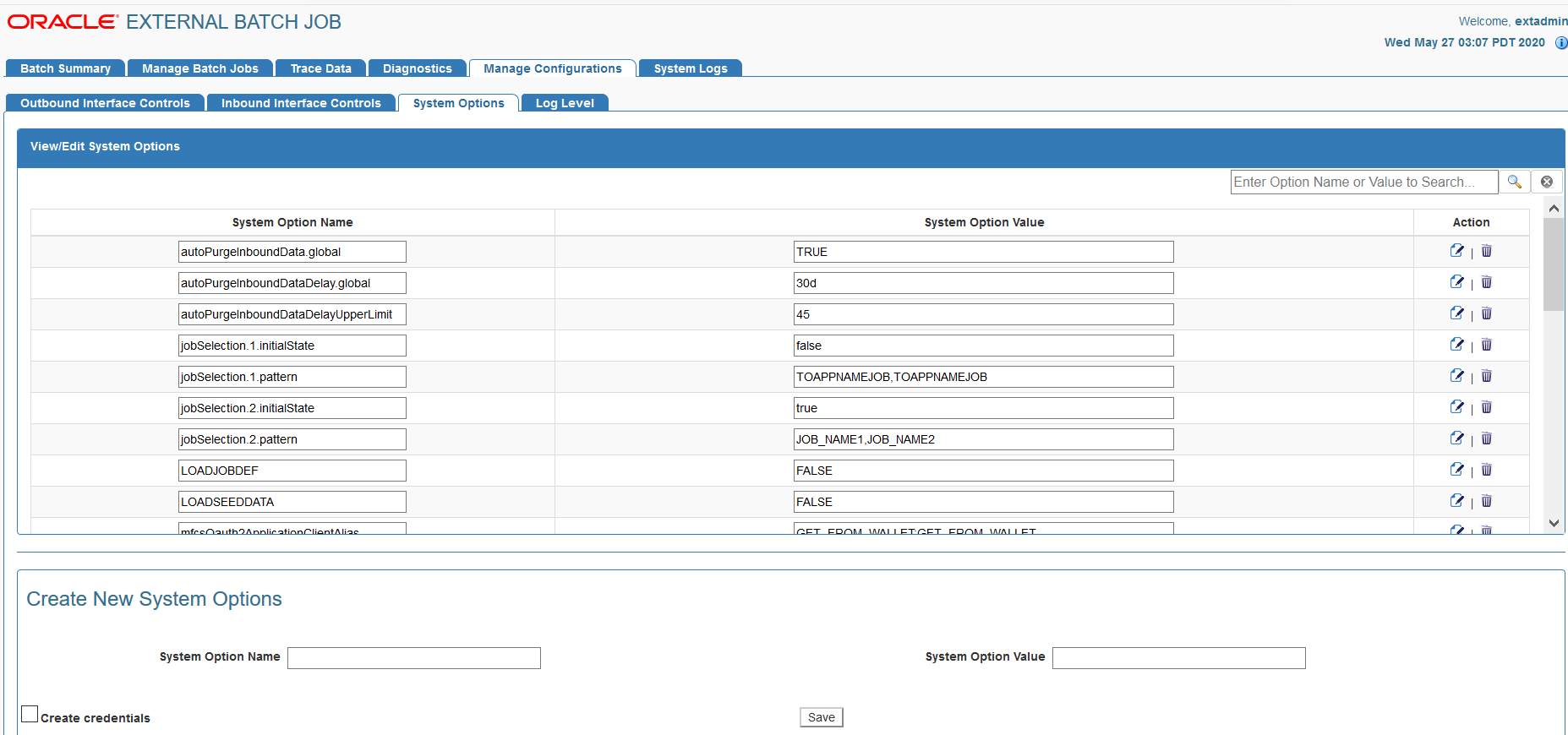

Auto Purge Inbound Data
A thread runs every hour to identify data sets to be purged based on flags in system options table and purges the data from inbound tables.
Eligible data sets are purged every hour from inbound table. Data set is said to be eligible for purge, if either transaction completion date has crossed predefined time interval or data set ready time has crossed predefined time interval.
Below are steps followed to identify data sets to be purged and purge records from inbound data tables automatically.
  • Auto purge delay can be allowed/restricted for any specific interface by adding autoPurgeInboundData.{interface_ModuleName} flag in SYSTEM_OPTIONS table with value TRUE/FALSE respetively.
    Example: autoPurgeInboundData.Diff_Fnd
    If interface level entry is missing in SYSTEM_OPTIONS table, then value of global flag autoPurgeInboundData.global is used to decide whether to purge data for interface module or not.
  • For each ACTIVE interface modules, check if auto purge flag is set at global level (autoPurgeInboundData.global) or interface module level (autoPurgeInboundData.{interface_ModuleName}) from SYSTEM_OPTIONS table. If flag is TRUE either at global level or at any interface module level, continue with the next steps.
    If an entry for auto purge flag is missing in SYSTEM_OPTIONS table, then value of flag at global level (autoPurgeInboundData.global) is defaulted to TRUE.
  • Prepare a list with interface module names that are eligible to be purged based on value of above flags and get list of datasets that already processed for the interface module list.
  • Get delay duration for each eligible transaction from SYSTEM_OPTIONS table. Check for entry "autoPurgeInboundDataDelay.{interface_name}" in SYSTEM_OPTIONS table to get delay duration for each eligible transaction.
    If no entry is available for interface module, then get global delay duration using entry "autoPurgeInboundDataDelay.global" of SYSTEM_OPTIONS table.
    Use default delay duration(30 days) if SYSTEM_OPTIONS table does not contain any entries for auto purge delay. Delay duration can specified either in hours or days. Refer table below for possible values for delay. Check if data is ready to be purged based on delay obtained. Data is ready to be purged if duration between transaction begin time and current time is greater than or equal to delay
  • If list from above step is not empty, then use the below query to get list of data sets that are already processed and ready to be purged. If there are data sets eligible to be purged, proceed with next step, exit otherwise.
    Query Template: select tr from ImporterExecutionDataSet dataset, ImporterTransaction tr, ImporterInterfaceModuleDataControl dmc
    where dataset.importerTransactionId = tr.id AND tr.interfaceModule IN :interfaceNameList
    AND (tr.importerTransactionStatus = IMPORTER_COMPLETED)
    AND dataset.importerInterfaceModuleDataControlId = dmc.importerInterfaceModuleDataControlId AND dmc.dataSetDeleteTime IS NULL
  • Check if there are any data sets that was ready to be consumed before predifined number of days. Data set is considered for purging, if data is set is older than AUTO_PURGE_DELAY_UPPER_LIMIT entry of SYSTEM_OPTIONS table.
    Query Template:
    select modctl
    FROM ImporterInterfaceModuleDataControl modctl, ImporterInterfaceDataControl ctl
    WHERE modctl.dataSetDeleteTime IS NULL
    AND ctl.importerInterfaceModuleDataControl.importerInterfaceModuleDataControlId = modctl.importerInterfaceModuleDataControlId
    AND modctl.dataSetDeleteTime IS NULL
    AND modctl.dataSetReadyTime < :autoDelayLimit
    Note : autoDelayLimit is the date obtained by subtracting number of days specified in AUTO_PURGE_DELAY_UPPER_LIMIT option of System Options table with current date.
  • For all the data sets that are ready to be purged, get importer data control details(like begin sequence number, end sequence number, dataset id etc) using transaction ids
    Query Template:
    SELECT modctl FROM ImporterExecutionDataSet dataset, ImporterInterfaceModuleDataControl modctl
    WHERE modctl.importerInterfaceModuleDataControlId = dataset.importerInterfaceModuleDataControlId
    AND dataset.importerTransactionId IN :transactionIdList
  • If there are data sets eligible to be purged from previous steps, then prepare a consolidated list of data sets to purge them and proceed with next steps, exit otherwise.
    Purge records from Inbound tables using details fetched from last step.
    Query Template:
    delete from {InterfaceShortName} where (bdi_seq_id between ? and ?)
  • Update DATA_SET_DELETE_TIME column of BDI_IMPRTR_IFACE_MOD_DATA_CTL table with current time stamp for the datasets whose inbound data are purged.
Table 3-7 BDI Auto Purge Inbound data
Name Allowed Values Comments
autoPurgeInboundDataDelayUpperLimit
45
This flag is used to specify maximum number of days a data set that is unconsumed, can be persisted.
After exceeding maximum number of days, data is purged even if it is unconsumed.
Ensure that value of this field is a numeric value
TRUE
FALSE
This flag is used to enable/disable purging of records if flag is missing at interface level
TRUE
FALSE
Replace {interface_ModuleName} with name of interface module to restrict/enable purging of records for given interface
30d
20h
20
This flag is used to fetch delay duration if flag is missing at interface level
h: Numeric value followed by h indicates duration in hours.
d: Numeric value followed by d indicates duration in days.
If neither d nor h follows numeric value or numeric value followed by non numeric value other than d or h, delay is considered to be in days.
Example: 20
20a
Ensure that value of this field is a numeric value followed by d or h
30d
20h
20
Replace {interface_ModuleName} with name of interface module to specify delay duration specific to interface.
h: Numeric value followed by h indicates duration in hours. Example: 20h
d: Numeric value followed by d indicates duration in days. Example:30d
Example: 20
20a

Approach 1: Update via UI
  1. Login to the job admin web page with valid credentials.
  2. Click the Manage Configurations tab.
  3. Click the System options tab.
    system options tab
  4. Search for the system option to update. Example: autoPurgeInboundData.global, autoPurgeInboundDataDelay.global, autoPurgeInboundDataDelayUpperLimit etc.
  5. Click the Edit icon to update the value and click the Save icon to save changes.
