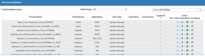

If you want to view the disabled jobs, search for "ToExternalJob" and uncheck the Hide Disabled jobs checkbox.
If you want to view the disabled flows, search for "_From_EXTERNAL" and uncheck the Hide Disabled process checkbox as shown below.

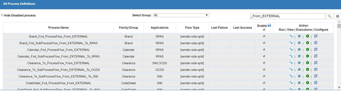

  1. Search for "_From_EXTERNAL" and uncheck the Hide Disabled process checkbox.
    Figure 4-1 View _From_EXTERNAL Processes

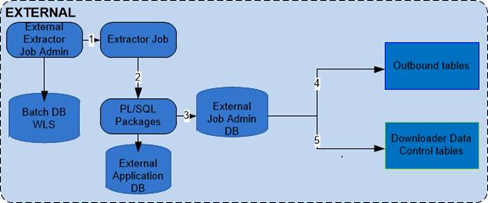

External Extractor Job
The Extractor Job uses a batchlet and PL/SQL stored procedures to move data from transactional tables of source system (for example EXTERNAL, third party system) to outbound tables. A PL/SQL stored procedure calls BDI PL/SQL stored procedure to insert data set information in the outbound data control tables. Extractor jobs are currently implemented to provide full data (not delta) for an interface. Whichever application is acting as Sender those teams have to write business logic to move data from application transaction tables to BDI OUT tables.
Figure 4-3 External Extractor Job

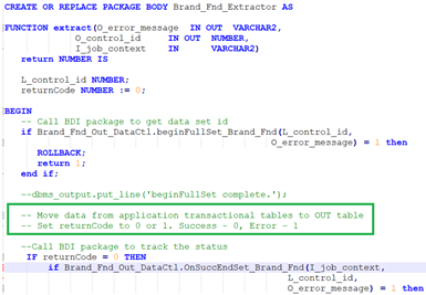

For each required interface, implement the logic in "extract" function of the "<InterfaceModule_Name>_Extractor_Body.sql" file as in the indicated section below. The sql file is located in the <bdi-edge-external-job-home>/setup-data/ddl/ folder.
Surrounding text describes create_replacepackage.png.
BDI Extractor (PL/SQL Application)
  1. The Extractor job is run from the App A (for example EXTERNAL) Extractor Job Admin application through REST or the UI.
  2. The Extractor job invokes the PL/SQL stored procedure in the App A database.
  3. A PL/SQL stored procedure is run in the App A database.
  4. The PL/SQL stored procedure moves data from transactional tables to the outbound tables in the BDI schema.
  5. The PL/SQL stored procedure inserts entries in downloader data control tables to indicate the data set is ready for download.

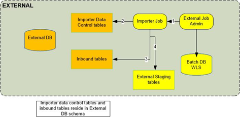

External Importer Job
The tables BDI_IMPRTR_IFACE_MOD_DATA_CTL and BDI_IMPORTER_IFACE_DATA_CTL act as a handshake between the receiver service and importer jobs. When the Receiver Service completes processing a data set successfully, it creates an entry in these tables.
An entry in the table BDI_IMPRTR_IFACE_MOD_DATA_CTL indicates to the Importer Job that a data set is ready to be imported.
The Importer job imports a data set for an Interface Module from inbound tables into application specific transactional tables. Importer jobs are application (for example SIM/RPAS/EXTERNAL) specific jobs. It uses the Importer Data Control Tables to identify whether a data set is ready for import or not.
Figure 4-4 External importer Job

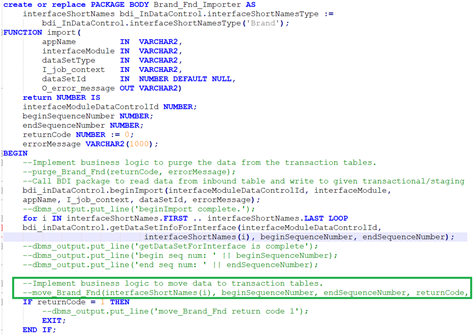

For each required interface, implement the logic in the "import" function of the "<InterfaceModule_Name>_Importer_Body.sql" file as in the indicated section below. The sql file is located in <bdi-edge-external-job-home>/setup-data/ddl/ folder.
external importer job logic
External Importer
  1. Importer job is run from App B EXTERNAL Job Admin application through REST or UI.
  2. Importer job checks for data sets in importer data control tables.
  3. If data set is available for import, importer job downloads data from inbound table.
  4. Importer job loads data to App B EXTERNAL staging tables.

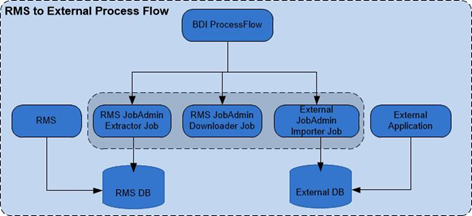

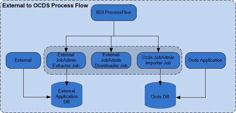

There are process flow dsl files for each interface from RMS to external and External to other applications which have all the activities for the particular interface as depicted in below pictures. Scheduler will trigger the process flow to execute the activities within the dsl file. Process flows are available out of box to move data end to end. Only thing to implement is extractor or importer packages or both.
Figure 4-5 Merchandising to External Process Flow
Figure 4-6 External Application to OCDs Process Flow
