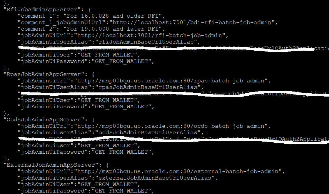

RpasJobAdminAppServer -> jobAdminUiUrl |
Job Admin URL of BDI RPAS http://<host>:<rpas managed server port>/rpas-batch-job-admin |
SimJobAdminAppServer -> jobAdminUiUrl |
Job Admin URL of BDI SIM http://<host>:<sim managed server port>/sim-batch-job-admin |
RfiJobAdminAppServer-> jobAdminUiUrl |
Job Admin URL of BDI RFI http://<host>:<sim managed server port>/bdi-rfi-batch-job-admin |
OcdsJobAdminAppServer -> jobAdminUiUrl |
Job Admin URL of BDI RFI http://<host>:<ocds managed server port>/ocds-batch-job-admin |
ExternalJobAdminAppServer -> jobAdminUiUrl |
Job Admin URL of BDI RFI http://<host>:<external managed server port>/external-batch-job-admin |

jobAdminUiOAuth2ApplicationClientAliasRef |
ICDS Client secret ID and password "name":"simJobAdminBaseUrlOAuth2ApplicationClientAlias", "value": "*simOauth2ApplicationClientAlias" |
"name":"rfiJobAdminBaseUrlOAuth2ApplicationClientAlias", "value": "*ricsOauth2ApplicationClientAlias" |
"name":"rpasJobAdminBaseUrlOAuth2ApplicationClientAlias", "value": "*rpasOauth2ApplicationClientAlias" |
ICDS Client secret ID and password "name":"ocdsJobAdminBaseUrlOAuth2ApplicationClientAlias", "value": "*ricsOauth2ApplicationClientAlias" |

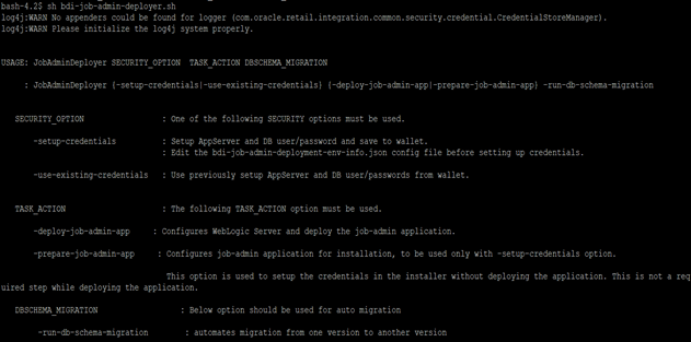

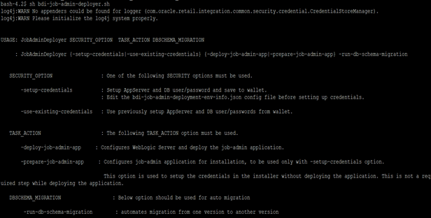

Run the deployer script to create the data sources and deploy BDI RMS Batch Job Admin. While deploying, the user needs to provide the IDCS client secret ID & password for ricsOauth2ApplicationClientAlias, mfcsOauth2ApplicationClientAlias, rpasOauth2ApplicationClientAlias
cd bdi-edge-rms-job-home/bin bdi-job-admin-deployer.sh -setup-credentials -deploy-job-admin-app
Enter the values prompted by the script for following credentials aliases. JobAdmin user has more privileges (e.g change configuration and run jobs from JobAdmin UI) than JobOperator user. JobOperator can run batch jobs where as JobMonitor has just read privileges.

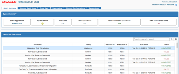

After you deploy to the server successfully, BDI RMS Batch Job Admin can be accessed using the following URL:
http://<server>:<port>/rms-batch-job-admin
Log in using credentials provided during the installation and verify that jobs are displayed in the Manage Batch Jobs tab and configuration is displayed in the Manage Configurations tab.

Run the deployer script to create the data sources and deploy BDI SIM Batch Job Admin.
cd bdi-edge-sim-job-home/bin bdi-job-admin-deployer.sh -setup-credentials -deploy-job-admin-app
Enter the values prompted by the script for the following credential aliases. JobAdmin user has more privileges (e.g change configuration and run jobs from JobAdmin UI) than JobOperator user. JobOperator can run batch jobs where as JobMonitor has just read privileges.

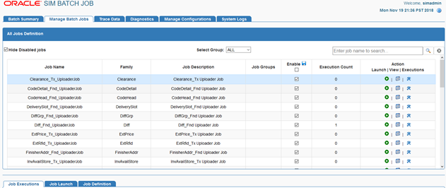

After you deploy to the server successfully, the BDI SIM Batch Job Admin can be accessed using the following URL:
http://<server>:<port>/sim-batch-job-admin

Deploy the BDI Edge job app using -setup-credential option (Follow BDI Installation Guide). -use-existing-credential option will not work the first time, since there is a new entry (IDCS client credentials) now. While deploying user needs to provide the IDCS client secret ID & password for ricsOauth2ApplicationClientAlias, mfcsOauth2ApplicationClientAlias, rpasOauth2ApplicationClientAlias. Cd to <appName>-job-home/bin and run the below command to upgrade and deploy the bdi job app.
sh bdi-job-admin-deployer.sh -use-existing-credentials } -run-db-schema-migration -deploy-job-admin-app

How to Install BDI without IDCS
To deploy without OAuth, we need to rename or remove the OAuth2 aliases for example:- jobAdminUiOAuth2ApplicationClientAliasRef from bdi-job-admin-deployment-env-info.json, and then deploy. No other extra steps needed for deployment.
"SimJobAdminAppServer": {
"jobAdminUiUrl":"http://localhost:7001/sim-batch-job-admin",
"jobAdminUiUserAlias":"simJobAdminBaseUrlUserAlias",
"jobAdminUiUser":"GET_FROM_WALLET",
"jobAdminUiPassword":"GET_FROM_WALLET",
"RfiJobAdminAppServer": {
"comment_1": "For 16.0.028 and older RFI",
"comment_1_jobAdminUiUrl":"http://localhost:7001/bdi-rfi-batch-job-admin",
"comment_2": "For 19.0.000 and later RFI",
"jobAdminUiUrl":"http://localhost:7001/rfi-batch-job-admin",
"jobAdminUiUserAlias":"rfiJobAdminBaseUrlUserAlias",
"RpasJobAdminAppServer": {
"jobAdminUiUrl":"http://localhost:7001/rpas-batch-job-admin",
"jobAdminUiUserAlias":"rpasJobAdminBaseUrlUserAlias",
"OcdsJobAdminAppServer": {
"jobAdminUiUrl":"http:// localhost:7001/ocds-batch-job-admin",
"jobAdminUiUserAlias":"ocdsJobAdminBaseUrlUserAlias",
"ExternalJobAdminAppServer": {
"jobAdminUiUrl":"http://localhost:7001/external-batch-job-admin",
"jobAdminUiUserAlias":"externalJobAdminBaseUrlUserAlias",
