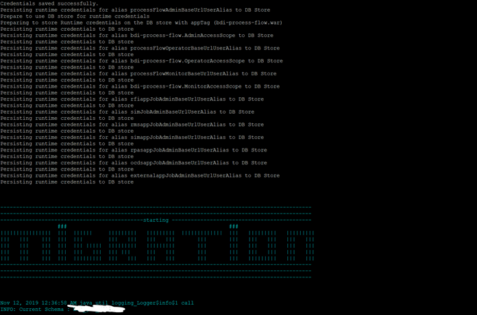

Run the deployer. Make sure that the WebLogic server is running before issuing the following command.
cd bin bdi-process-flow-admin-deployer.sh -setup-credentials -deploy-process-flow-admin-app
The process flow deployer will prompt for username and password for the following credential aliases:

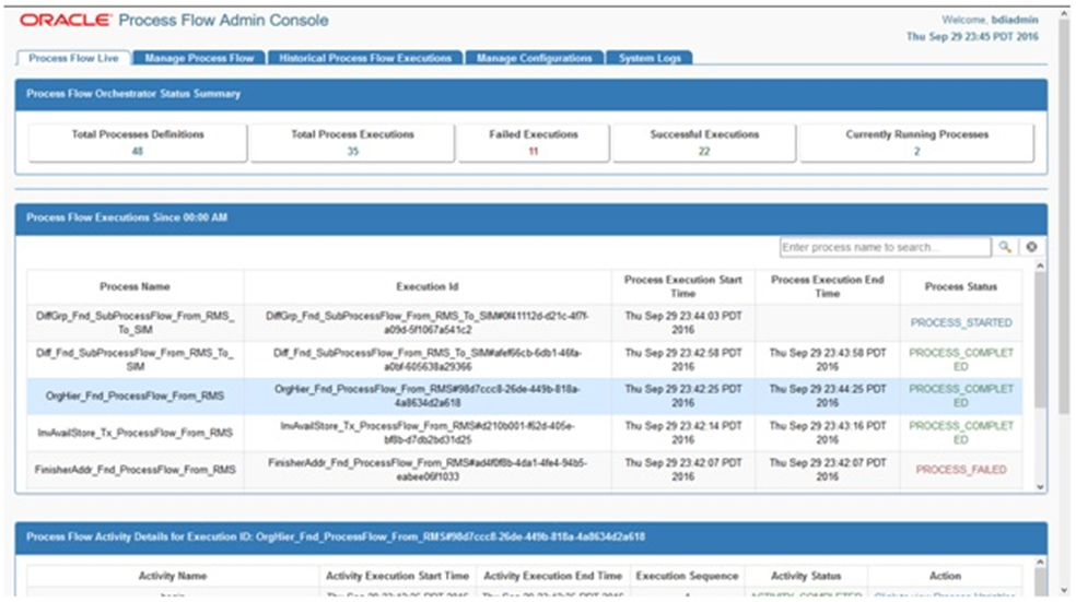

If the process flow app is successfully deployed, you should be able to access the application at the URL http://<host>:<port>/bdi-process-flow/. The following is a sample screenshot of the process flow application. Make sure all the tabs of the application are properly displayed.
See the Oracle Retail Bulk Data Integration Implementation Guide for the operation details of the Process Flow application.

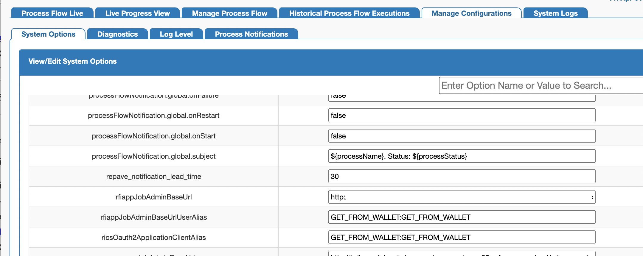

Login to the existing deployed process flow app.
Go to Manage Configurations -> System Options and make following changes: LOADPROCESSDEF = TRUE and LOADSEEDDATA = TRUE
Delete the existing process flow app.
Run the below command to upgrade and deploy the process-flow-app.
Cd bin sh bdi-process-flow-admin-deployer.sh -use-existing-credentials -run-db-schema-migration -deploy-process-flow-admin-app
BDI process flow installer copies all the enterprise flows from process-home/setup-data/dsl/available_process_flow_options/rms_enterprise-sender_side_split_flows/ to process-home/setup-data/dsl/flows-in-scope while deployment.
After successful deployment, bounce the managed server.
