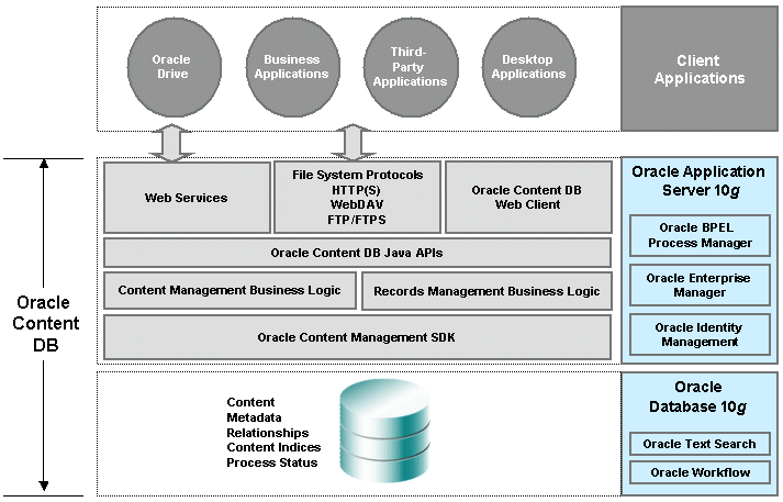

A Java API layer provides a uniform interface that encompasses both content management business logic and records management business logic. This layer is the foundation for the Oracle Content DB Web application, protocol servers, and Web services. The Java API layer ensures that all components interfacing to Oracle Content DB do so at an abstraction level that respects the application business logic.
Figure 1-1 Oracle Content DB Application Architecture

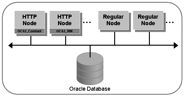

An Oracle Content DB domain is a logical grouping of Oracle Content DB node and an Oracle Database instance that contains the Oracle Content DB data. The nodes run on Oracle Application Server. The Oracle Content DB node processes and the database can be physically configured on a single computer or across several, separate computers.
The Oracle Content DB schema is created in the Oracle Content DB database during the configuration process. The schema owns all database objects, including metadata about Oracle Content DB and configuration information.
Figure 1-2 shows the Oracle Content DB domain.

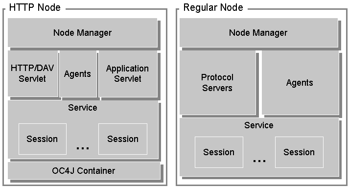

An Oracle Content DB node is the application software that comprises the product, along with the underlying Java Virtual Machine (JVM) required to support the software at run time.
Important concepts to understand about nodes include:
After installation, each Oracle Content DB middle tier includes two nodes by default: one regular node and one HTTP node. (See Figure 1-3.) An additional HTTP node to support the Oracle Records DB application is also included on each middle tier, but this HTTP node and its OC4J instance are disabled by default after installation.
The regular node supports protocol servers, such as FTP, and agents, such as the Garbage Collection Agent.
Each regular node is monitored by OPMN, which automatically restarts the node when it is stopped unexpectedly.
The HTTP nodes support the Oracle Content DB and Oracle Records DB applications, WebDAV, and the Web services using servlets that are configured to work with OC4J.
The OC4J process for each HTTP node is guarded by OPMN, which restarts the OC4J process if it is stopped unexpectedly.
The node manager is a process that is started when the node is started. It is responsible for starting the default services and servers for the node. It also provides an administrative API for the node that lets you find information about node log levels, locale information, available free memory, and the Oracle home for the node.
Figure 1-3 shows the Oracle Content DB nodes.
