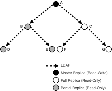

6.1.1 Fan-Out Replication (LDAP Replication)
In fan-out replication, one Oracle Internet Directory is the master, and the other Oracle Internet Directory instances are called the Oracle Internet Directory replicas.
In one-way fan-out replication, clients modify the data in the master Oracle Internet Directory only. The master then propagates the changes to the replicas. These replicas, in turn, can update other Oracle Internet Directory replicas.
In two-way fan-out replication, clients modify the data in the master Oracle Internet Directory and the replicas. Changes made to any node are propagated to the other nodes.
Figure 6-1 Example of One-Way Fan-Out Replication (LDAP Replication)
Description of Figure 6-1 follows
Description of "Figure 6-1 Example of One-Way Fan-Out Replication (LDAP Replication)"
In fan-out replication, Oracle Internet Directory instances use the LDAP protocol to communicate with each other. The Select Oracle Internet Directory Replication Mode screen in the installer uses the term LDAP Replication to refer to fan-out replication.

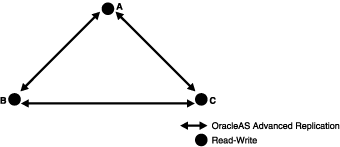

6.1.2 Multimaster Replication (Advanced Replication)
In multimaster replication, you have one or more master Oracle Internet Directory instances. You can also have other Oracle Internet Directory instances that are replicas. Clients can update data in any Oracle Internet Directory (master or replica). The Oracle Internet Directory instances propagate the changes among themselves.
Figure 6-2 Example of Multimaster Replication (Advanced Replication)
Description of Figure 6-2 follows
Description of "Figure 6-2 Example of Multimaster Replication (Advanced Replication)"
In multimaster replication, Oracle Internet Directory instances use the Oracle Database Advanced Replication protocol to communicate with each other. The Select Oracle Internet Directory Replication Mode screen in the installer uses the term Advanced Replication to refer to multimaster replication.
