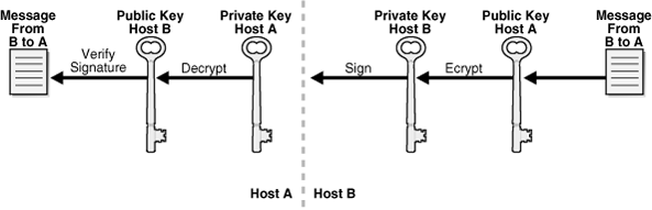

Every host in the domain, including the administrative server, has a private key known only to that host that is stored with the host's identity certificate. This private key corresponds to a public key that is made available to other hosts in the administrative domain.
Any host in the domain can use a public key to send an encrypted message to another host. But only the host with the corresponding private key can decrypt the message. A host can use its private key to attach a digital signature to the message. The host creates a digital signature by submitting the message as input to a cryptographic hash function and then encrypting the output hash with a private key.
The receiving host authenticates the digital signature by decrypting it with the sending host's public key. Afterwards, the receiving host decrypts the encrypted message with its private key, inputs the decrypted message to the same hash function used to create the signature, and then compares the output hash to the decrypted signature. If the two hashes match, then the message has not been tampered with.
Figure 6-3 illustrates how host B can encrypt and sign a message to host A, which can in turn decrypt the message and verify the signature.
Figure 6-3 Using Public and Private Keys to Encrypt and Sign Messages

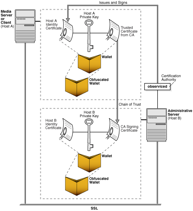

Oracle Secure Backup stores every certificate in an Oracle wallet. The wallet is represented on the operating system as a password-protected, encrypted file. Each host in the administrative domain has its own wallet in which it stores its identity certificate, private key, and at least one trusted certificate. Oracle Secure Backup does not share its wallets with other Oracle products.
Besides maintaining its password-protected wallet, each host in the domain maintains an obfuscated wallet. This version of the wallet does not require a password. The obfuscated wallet, which is scrambled but not encrypted, enables the Oracle Secure Backup software to run without requiring a password during system startup.
To reduce risk of unauthorized access to obfuscated wallets, Oracle Secure Backup does not back them up. The obfuscated version of a wallet is named cwallet.sso. By default, the wallet is located in /usr/etc/ob/wallet on Linux and UNIX and C:\Program Files\Oracle\Backup\db\wallet on Windows.The password for the password-protected wallet is generated by Oracle Secure Backup and not made available to the user. The password-protected wallet is not usually used after the security credentials for the host have been established, because the Oracle Secure Backup daemons use the obfuscated wallet.
Figure 6-4 illustrates the relationship between the certificate authority and other hosts in the domain.

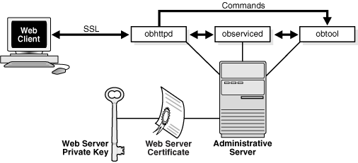

The Web server requires a signed X.509 certificate and associated public key/private key pair to establish an Secure Sockets Layer (SSL) connection with a client Web browser. The X.509 certificate for the Web server is self-signed by the installob program when you install Oracle Secure Backup on the administrative server. Figure 6-5 shows the interaction between Web server and client.
The Web server X.509 certificate and keys are not stored in the wallet used for host authentication in the Oracle Secure Backup administrative domain, but are stored in files in the /apache/conf subdirectory of the Oracle Secure Backup home. A single password protects the certificates and keys. This password is stored in encrypted form in the daemons file located in /admin/config/default. When the Web server starts, it obtains the password by using a mechanism specified in the Web server configuration file. This password is never transmitted over the network.

Secure Sockets Layer (SSL) is used for host authentication and message integrity.
The CA signs and issues the identity certificate for each domain host in automated certificate provisioning mode.
The size of the public key and private key for every host in the domain is 1024 bits.
Host communications within the domain are encrypted by SSL.
When you add hosts to the administrative domain, Oracle Secure Backup creates the wallet, keys, and certificates for each host when you create the hosts in obtool or the Oracle Secure Backup Web tool. No additional intervention or configuration is required.
