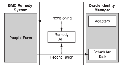

The architecture of the connector is the blueprint for the functionality of the connector.
In Oracle Identity Manager release 11.1.1, a scheduled job is an instance of a scheduled task. In this guide, the term scheduled task used in the context of Oracle Identity Manager release 9.1.0.x is the same as the term scheduled job in the context of Oracle Identity Manager release 11.1.1.
See Oracle Fusion Middleware System Administrator's Guide for Oracle Identity Manager for more information about scheduled tasks and scheduled jobs.
The primary function of a connector is to create Users on the target system through Oracle Identity Manager. The BMC Remedy System (target system) can be configured to run in either the identity reconciliation (trusted source) mode or the provisioning (target resource) mode.
In the identity reconciliation mode, BMC Remedy System is used as the trusted source and users are directly created and modified on it. During reconciliation from the trusted source, the user management connector fetches data (using scheduled task) about these target system users into Oracle Identity Manager. This data is used to create or update the corresponding OIM Users.
In the account management or provisioning mode, BMC Remedy System is used as a target resource. During reconciliation, the user management connector fetches data (using scheduled tasks) about users created or modified directly on the target system into Oracle Identity Manager. This data is used to add or modify resources allocated to OIM Users. In addition, the connector enables provisioning operations through which user data changes are propagated from Oracle Identity Manager to BMC Remedy System.
Figure 1-1 provides the architecture of the BMC Remedy User Management connector.
Figure 1-1 Architecture of the BMC Remedy User Management Connector
Users are created during provisioning in the People form of the BMC Remedy target system. The connector makes use of the Remedy APIs to connect to the Remedy Server, and in turn provision the account.
During reconciliation, scheduled tasks retrieve user records from the People form.
