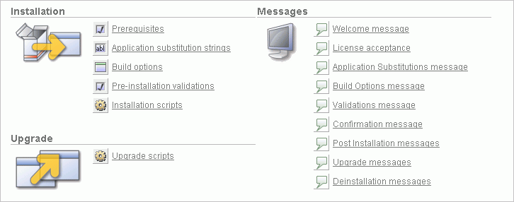

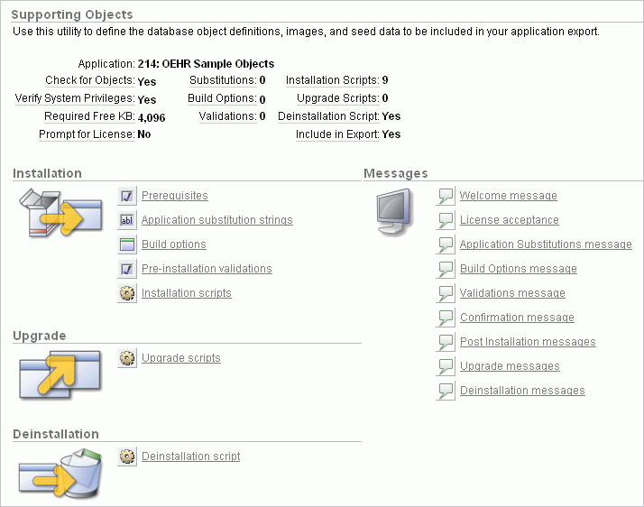

You access the Supporting Object Utility on the Supporting Objects page.
To go to the Supporting Objects page:
On the Workspace home page, click Application Builder.
Click OEHR Sample Objects.
On the Application home page, click Supporting Objects.
The Supporting Objects page appears.
The top of the Supporting Objects page displays a detailed report about the currently selected application, including the number of scripts and the amount of required free space. After that, the page is divided into these sections:
Installation
Upgrade
Deinstallation
Messages
During the installation of supporting objects, a sequence of scripts and validations are run. If a validation fails, the installation process stops. At certain points in the process, messages also display for users to review.
This section describes the Installation and Messages sections of the Supporting Objects page. Depending upon the needs of your application, you may use all or only some of the functionality.
In order to give context, this section describes the supporting objects in the sequence that they would appear to a user who is performing the installation.

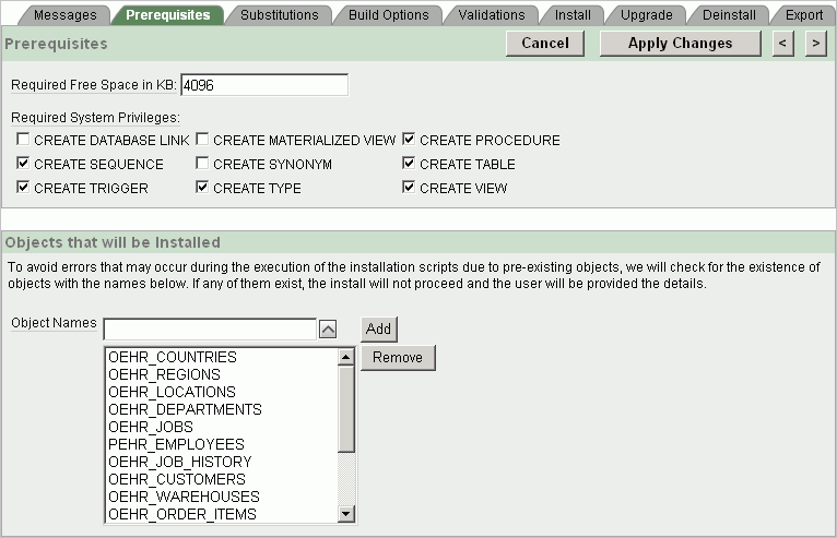

Prerequisites include anything that must be valid for the installation process to continue.
To review the prerequisites:
On the Supporting Object Messages page, click the Prerequisites tab.
The Prerequisites page displays the following sections:
Required Free Space in KB
Required System Privileges
Objects that will be Installed
If you are creating tables and loading data during the installation, you should specify the amount of required free space. If there is not enough free space available, specifying this prerequisite prevents an error during the installation of supporting objects. For the OEHR Sample Objects application, the required free space is 4800 kilobytes (KB).
To determine the space that your objects require:

The Required System Privileges section contains a list of system privileges. If you are creating objects through installation scripts, you need to select the appropriate system privileges. Selecting these privileges runs a pre-installation check to determine if the user has the appropriate privileges. This prevents the user from creating some objects but not others due to a lack of privileges.
For the OEHR Sample Objects application, required system privileges include: CREATE SEQUENCE, CREATE TRIGGER, CREATE TYPE, CREATE PROCEDURE, CREATE TABLE, and CREATE VIEW.
The Objects that will be Installed section lists all objects that your installation script creates. If the target schema contains an object with the same name, an error displays to the user. This prerequisite prevents the user from getting errors during installation that result in some objects being created while others are not created because an object of the same name exists.
This prerequisite is important because of the deinstallation implications. If a user installs and already has an object with the same name, the deinstallation script might drop the previously existing object.
For example, if a PROJECTS table already exists and the installation script creates a table with the same name, you would want to alert users before they start the installation process. This warning provides them with the opportunity to rename their table or decide to not install supporting objects.

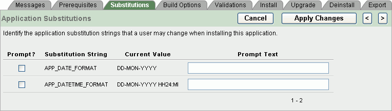

Each application can include substitution strings defined within the Application Definition. You can use substitution strings to include phrases or labels occurring in many places within an application that might need to be changed for specific installations.
When you define substitution strings for your application, they display within the Supporting Object Utility. You can then decide which substitution strings you want to display during the installation process.
For substitution strings that display during the installation process, you can provide a custom prompt to explain what each string is used for to assist the user in determining the proper value. You can also define a custom header message if you are including substitution strings.
Since the OEHR Sample Objects application does not contain any substitution strings, in the next section you add two substitution strings and then view them the Supporting Object Utility.

To view the substitution strings in Supporting Object Utility:
Go to the Supporting Objects page:
Click the Application breadcrumb.
Click Supporting Objects.
In the Installation section, click Application Substitution strings.
The Edit Substitutions page appears, showing the two substitution strings that you defined. If have a prompt appear during installation, select it and enter text in the Prompt Text field.

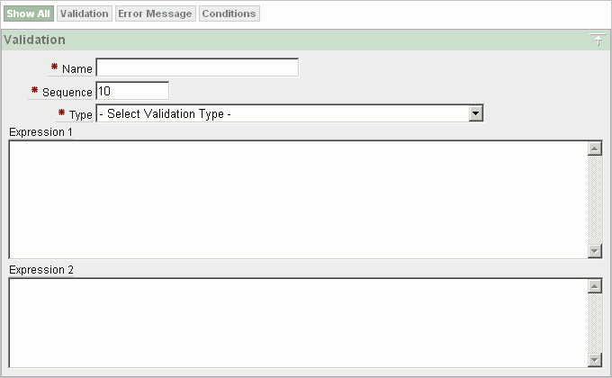

Click the Validations tab.
Click Create.
The Validation page appears.
For this exercise, click Cancel.

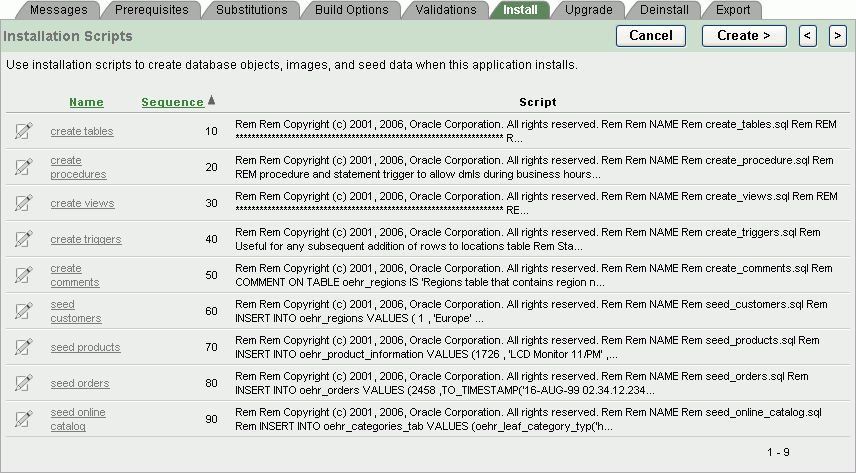

Installation scripts are the core of a supporting object installation. Each application can have several installation scripts.
The OEHR Sample Objects application contains nine installation scripts. These scripts create objects and load data.
Tip:
You can also create a custom installation script that loads files. See "About Creating Scripts to Install Files".Topics in this section include:
To review the installation scripts in the OEHR Sample Objects application:
On the Supporting Object Messages page, click the Install tab.
The Installation Scripts page shows the list of scripts.
Notice that each script has a name and a sequence. It is very important to order your installation scripts so that dependent objects are created or compiled correctly.

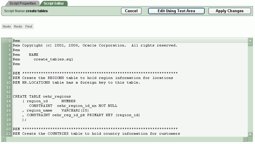

To review or update an existing script:
Click the Edit icon adjacent to the script name.
The Script Editor page displays the script for you to edit or review.
Figure 12-1 Supporting Object Script Editor
Tip:
You can toggle between this page and a text page, where you can also edit the script, by clicking the Edit Using Text Area button.To view and edit the properties of the script, click the Script Properties tab.

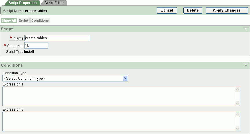

Use the Script Properties page to change the script name or sequence. You can also specify if it should be conditionally executed.

To review the success or fail messages:
On the Installation Scripts page, click the Messages tab.
Scroll down to the Post Installation section to review the messages.

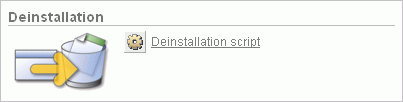

The final part of Supporting Object Utility is the deinstallation process. Deinstalling enables a user who has installed your application to cleanly remove all objects created during the installation process.
On the Supporting Objects page, the Deinstallation section includes a Deinstallation script link.
When a user initiates the deinstallation process, a deinstallation message appears.
To review the deinstallation confirmation message section:
On the Supporting Object Messages page, scroll down to Deinstallation.
Scroll down to the Deinstallation section.
For the OEHR Sample Objects application, no deinstallation message is defined.
