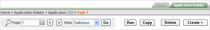

A navigation bar appears directly beneath the breadcrumb trail.
Available controls on the page navigation bar include:
Page. Displays the current page number. To view another page, enter the page number in the Page field and click Go.
Previous and Next. These buttons resemble less than (<) and greater than (>) signs. Click these buttons to move to the previous or next page.
View. Controls the current page view. To view alternative reports, make a selection from the list and click Go. See "Using the View List on the Page Definition".
The following buttons appear to the right of the navigation bar:
Run. Submits the current page to the Application Express engine to render viewable HTML. See "Running a Page or Application".
Copy. Creates a copy of the current page. You specify a new page number and page name.
Create. Links to a wizard for creating a new page. See "Creating a Page from the Page Definition".

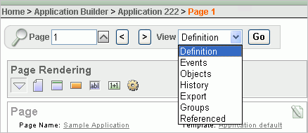

You can use the View list to quickly switch from a Page Definition to the Page Events, Database Object Dependencies, History, Export, Groups, and Referenced Components pages.
Topics in this section include:
See Also:
"Understanding the Page Definition"To access other pages using the View list:
Navigate to the Workspace home page.
Click the Application Builder icon.
Select an application.
Select a page.
The Page Definition appears.
From the View list, select one of the following:
Definition. See "Editing a Page Definition".
Events. See "About Page Events".
History. See "About History".
Export. See "About Export".
Groups. See "About Groups".
Referenced. See "About Referenced".

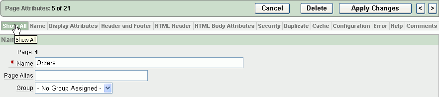

You can edit all controls, components, or logic within a given subsection by clicking the Edit All icon that displays to the right of the subsection title. The Edit All icon resembles a small grid with a pencil on top of it.
Clicking the Edit All icon displays pages that enable you to edit or delete multiple controls, components, or application logic simultaneously or view a history of recent changes.
For example, selecting the Edit All icon under Regions displays a summary report of all currently defined regions on the current page. You can use this summary view to:
Edit the multiple attributes at once by making new selections from the available fields and select lists.

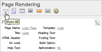

Page rendering is the process of generating a page from the database. Use the Page Rendering section to modify controls that impact the rendering of a page, including page attributes, regions, buttons, items, page rendering computations, and page processes.
You can quickly navigate to a specific subsection by clicking the icons beneath the heading. When you select one of these icons, the subsection appears and all other subsections are temporarily hidden. To restore the view, click Show All. The Show All icon resembles an inverted triangle.
See Also:
"About the Page Definition", "About the Edit All Icon" and "About the Copy or Create Icons"Page attributes control specific characteristics of a page such as the page name, display attributes such as the page title and the associated page template, header text, and the selected authorization scheme to name just a few. You access page attributes from the Page Definition.
See Also:
"Editing Page Attributes"A region is a area on a page that serves as a container for content. Each page can have any number of regions. The content of a region is determined by the region source. For example, a region may contain a report based on a SQL query you define, or it may contain static HTML.

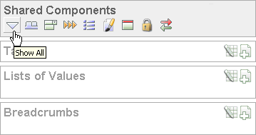

"Understanding Page Processes"The Shared Components section of the Page Definition contains common elements that can display or be applied on any page within an application.
See Also:
"Working with Shared Components"Topics in this section include:

To edit page attributes:
Navigate to the Page Definition. See "Accessing a Page Definition".
Under Page Rendering, locate the Page section.
The Page Attributes page is divided into categories that control specific page attributes such as the Page Name, Title, HTML Header, HTML Body, Help Text, Templates, and so on.
To edit page attributes you can either:
Click the Edit page attributes icon to access the entire Page Attributes page. This icon resembles a small page with a pencil on top of it.
Click a specific link. The specific information appears.
Tip:
Clicking the Edit page attributes icon is the only way to view all page attributes at once.The Page Attributes page appears. Required values are marked with a red asterisk (*).
The Page Attribute page is divided into the following sections: Name, Display Attributes, Header and Footer, HTML Header, HTML Body Attributes, Security, Duplicate, Cache, Configuration, Error, Help, and Comments.
You can access these sections by scrolling down the page, or by clicking a navigation button at the top of the page. When you select a button at the top of the page, the selected section appears and all other sections are temporarily hidden. To view all sections of the page, click Show All.
The topics that follow describe the specific sections of the Page Attributes page.

Shared components are common elements that can display or be applied on any page within an application. You can use the tools and wizards on the Shared Components page either at the application-level or on specific pages.
To access the Shared Components page:
On the Application home page, click Shared Components.
The Shared Components page appears.
To create a shared component, select the appropriate link.
You can also access the Shared Components page by clicking the Shared Components icon on the Action bar. The Action bar resembles a small mechanical gear and displays beneath the Utilities tab in the upper right corner of most pages in Application Builder.
