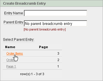

During the wizard, a Breadcrumb list appears. The actual page on which this list displays depends upon the type of page you are creating.
From the Breadcrumb list, select Breadcrumb.
The Create Breadcrumb Entry form appears.
In Entry Name, enter a name for the breadcrumb.
For Parent Entry:
To specify a parent, select a parent page from the Select Parent Entry list.
If this breadcrumb does not have a parent, select No parent breadcrumb entry.
Follow the on-screen instructions.

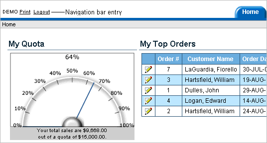

Navigation bar entries offer an easy way to move users between pages in an application. For example, a navigation entry enables you to display a link from an image or text. The associated page template determines the location of a navigation bar.
Topics in this section include:
See Also:
"Customizing Templates"A navigation bar entry can be an image, text, or an image with text beneath it. You must supply the images and text to use in the navigation bar entries.
Navigation bars are different from other shared components in that you do not need to reference them on a page-by-page basis. If your page template includes the #NAVIGATION_BAR#
substitution string, the Application Express engine automatically includes any defined navigation bars when it renders the page.
Before adding a navigation bar, you must create entries for the navigation bar. To do so, access the Navigation Bar page from either the Page Definition or from the Shared Components page.
See Also:
"Working with Shared Components",To create a navigation bar entry:
