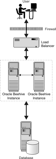

The following diagram illustrates multiple Oracle Beehive instances and a load balancer in a high availability environment:
Figure 29-1 Multiple Instances in High Availability Environment
Follow these steps to install and configure more than one Oracle Beehive instance with a load balancer:

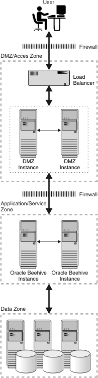

The following diagram illustrates multiple DMZ instances and a load balancer in a high availability environment:
Figure 29-2 Multiple DMZ Instances in High Availability Environment
Follow these steps to configure a high availability environment with a load balancer and multiple Oracle Beehive DMZ instances:
