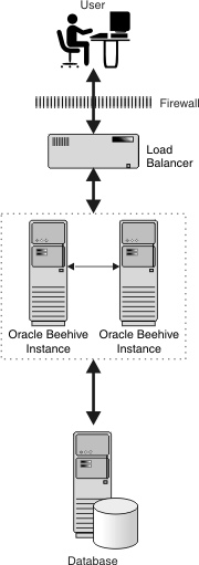

The following diagram illustrates multiple Oracle Beehive instances and a load balancer in a high availability environment:
Figure 27-1 Multiple Instances in High Availability Environment
Follow these steps to install and configure more than one Oracle Beehive instance with a load balancer:
Install an Oracle Beehive instance.
Change the ServerName property of the Oracle Beehive virtual server to the load balancer server name. In the following example, load-balancer.example.com
is the server name of the load balancer:
beectl modify_property --component _VIRTUAL_SERVER --name ServerName --value load-balancer.example.com
If the HttpPort property value of the Oracle Beehive virtual server and the HTTP port of the load balancer are different, then change the HttpPort property value of the virtual server to the HTTP port of the load balancer. In the following example, the HTTP port of the load balancer is 80:
beectl list_properties --component _VIRTUAL_SERVER ----------------------------------------------- | Property Name | Property Value | ----------------------------------------------- | ServerName | example.com | | ImapPort | 143 | | SmtpPort | 25 | | XmppPort | 5222 | | IPAddress | | | HttpPort | 7777 | | HttpSslPort | 4443 | | HttpSslEnabled | true | | FtpPort | 2121 | | BtiClientPort | 21401 | | BtiSecureClientPort | 21451 | | Alias | _VIRTUAL_SERVER | ----------------------------------------------- beectl modify_property --component _VIRTUAL_SERVER --name HttpPort --value 80
Commit configuration changes:
beectl activate_configuration beectl modify_local_configuration_files
Thebeectl modify_local_configuration_files
command will ask you to run this command on all your other Oracle Beehive instances. Do not run this command on all your other instances at this time.Ensure that the changes you made in steps 2 and 3 appear in the file <Oracle home>
/Apache/Apache/conf/httpd.conf
Install another Oracle Beehive instance.
Oracle Beehive will apply these changes to any subsequent Oracle Beehive installation, so you do not have to run beectl modify_local_configuration_files
on these new instances.
If you are making these changes after installing two or more Oracle Beehive instances, then follow steps 1-5 on the first instance. Afterwards, only runbeectl modify_local_configuration_files

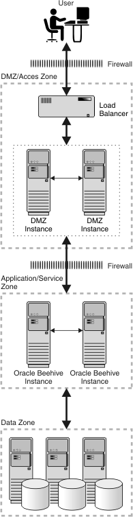

You may have a high availability environment with both a load balancer and DMZ instances. In this case, your Oracle Beehive instances will be load balanced on multiple levels.
The following diagram illustrates multiple DMZ instances and a load balancer in a high availability environment:
Figure 27-2 Multiple DMZ Instances in High Availability Environment
Follow these steps to configure a high availability environment with a load balancer and multiple Oracle Beehive DMZ instances:
Perform the steps described in "Configuring High Availability Environment with Load Balancer" for your Oracle Beehive (non-DMZ) instances. This involves configuring the virtual server with the load balancer for each Oracle Beehive instance.
Note that if you are performing these steps after you have installed all your Oracle Beehive instances, run beectl modify_local_configuration_files
only after configuring the virtual server for all your Oracle Beehive instances.
Edit the following directives in the file <Oracle Beehive DMZ home>
ServerName <Domain name server (DNS) of the load balancer> Port <HTTP port of the load balancer>
For example, if load-balancer.example.com
is the load balancer's DNS, and 80 is its HTTP port number, then edit the httpd.conf
file as follows:
ServerName load-balancer.example.com Port 80
Perform this step only if you need to configure your DMZ instance with SSL.
Retrieve the location of the file ssl.conf
from the file <Oracle home>
. Edit the following directives in the ssl.conf
file:
ServerName <Domain name server (DNS) of the load balancer> Port <HTTPS port of the load balancer>
is the load balancer's DNS, and 4443 is its HTTP port number, then edit the ssl.conf
file as follows:
ServerName load-balancer.example.com Port 4443
Restart the Oracle Beehive DMZ instance.
Repeat steps 1-3 for each of your Oracle Beehive DMZ instances.
