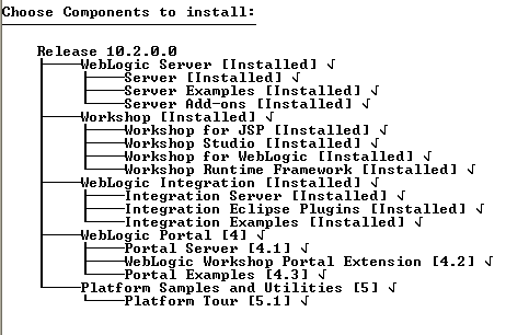

  7. Select the components you want to install. The available components are displayed as follows:
  8. Note: If you are using the BEA Products installation program for WebLogic Server, Workshop for WebLogic, the following components are displayed
    Figure 4-1 Product Components
    Product Components
    Enter number exactly as it appears in brackets to toggle selection OR
    [Exit][Previous][Next]>
    The word Installed is shown in brackets for any components you have already installed on your system.
    When you are finished selecting components, press Enter or type next (or n for short).
    Note: When you select or deselect components to install, the installation program checks for dependencies between components and automatically modifies the list of selected components. For example, if you deselect the WebLogic Server component, the remaining components are also deselected, since they require WebLogic Server to run.

    Choose BEA Home Directory:
    ->1¦ Yes, Use this BEA home directory [/home/bea]
      2¦ No, return to BEA home directory selection
    Enter index number to select OR [Exit][Previous][Next]>
    Type 1 or press Enter to accept your selection. Otherwise, type 2 to return to the Choose BEA Home Directory panel where you can modify your entry.
    After you select the appropriate BEA Home directory and confirm your selection, the Confirm Product Directory panel is displayed.
  7. The Confirm Product Directory panel indicates the folder in which the WebLogic Platform software will be updated. For example:
  8. Confirm Product Directory:
    Product Installation Directory: [home/bea/weblogic92]
    Files in /home/bea/weblogic92 will now be upgraded to the 9.2.x.0 maintenance level.
    Enter [Exit][Previous][Next]>Press Enter or type next to continue. The following text is displayed:
  9. After you confirm the product directory, the installation program makes a backup copy of specific files from the previous installation and then installs new versions of those files.
  10. When the installation is complete, the following prompt is displayed:
    Install Complete Congratulations! WebLogic Platform 9.2.x.0 has been successfully installed to/home/bea/weblogic92
    Press any key to continue OR [Exit]>
  11. Press any key to exit the installation program.
