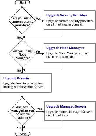

The following provides a roadmap that identifies the steps required to upgrade your application environment.
The following table summarizes the steps for updating an application environment. Some steps are mandatory, others are optional. Each step that is performed must be done on every machine in the domain.
If are using custom security providers in your current application environment and you wish to continue using them in the new environment, upgrade them:
Upgrade the WebLogic domain on every machine that hosts any Managed Servers. Be sure to copy the appropriate files to the Managed Servers before performing the upgrade, as described in Step 5: Prepare the Remote Managed Server Domain Directories.
Once you have used the WebLogic Upgrade Wizard to upgrade the application environment, you may need to perform the following steps:
