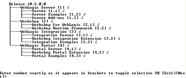

The Choose Components to uninstall panel is displayed.
Select the components you want to uninstall.
For example, the available components to uninstall in WebLogic Platform are displayed as shown in Figure 8-1.
Figure 8-1 Product Components
By default, all installed components are selected, indicating that they will be removed.
If you installed your software using the BEA Products installation program for BEA WebLogic Server, only the WebLogic Server components are displayed.
To leave a component installed on your system, type the numeric code for that component on the command line, exactly as it appears within the brackets. For example, to uninstall only the Server Examples and keep the Server installed on your system, enter 1.2 on the command line. The check mark (Windows systems) or x (UNIX systems) beside the entry for Server is cleared, indicating that it will not be uninstalled. The Server Examples will be uninstalled.
Dependency checking is performed to ensure that you do not uninstall a component that is required by another component.
