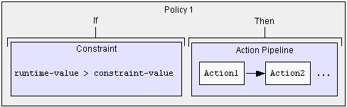

Each WLOC policy consists of a constraint and an action or action pipeline. The constraint defines some deployment or runtime requirement of a service, while the action or action pipeline defines one more actions to take if the service runtime-value is outside the constraint-value range.
For example, a policy could consist of a constraint that defines a runtime requirement of at least two running processes and an action that starts a process if only one is found to be running.
Figure 6-1 illustrates the basic constraint/action relationship.
The assignment of a constraint and action to a policy is referred to as the ‘constraint/action binding’.
