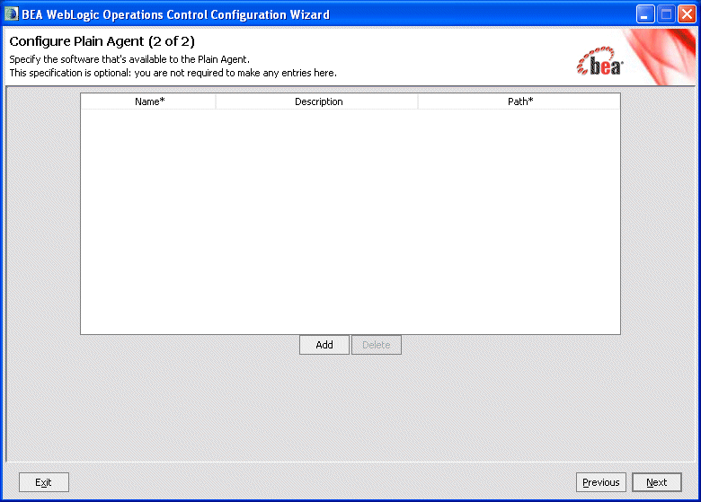

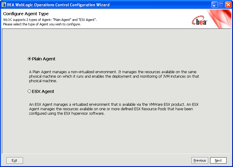

A Plain Agent manages the computing resources for the physical machine on which the Agent is installed. You can configure a Plain Agent to allocate all or a subset of the available machine resources to WLOC services.

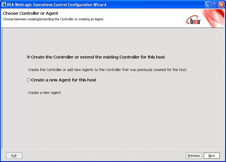

After you install the agent, you create it using the WLOC Configuration Wizard.
Use the following steps to install and create the Plain Agent.
The Plain Agent is installed as part of a complete WLOC installation, or can be selected individually using the Custom installation option. For details about installing WLOC, see the WLOC Installation Guide.

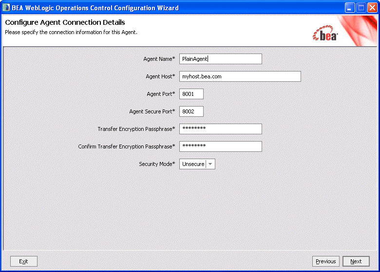

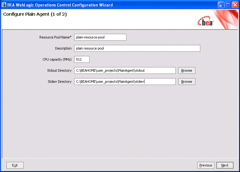

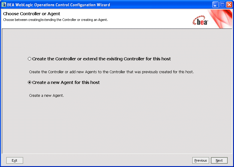

To create the Plain Agent, use the WLOC Configuration Wizard and complete the following steps:

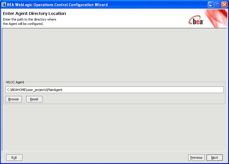

By default, this directory is created in BEA_HOME\user_projects\agent1, but you can specify any name and directory location you choose.
Note that we used C:\BEAHOME as the BEA_HOME directory when we installed the WLOC software, therefore that BEA_HOME value is displayed as the default.
For this example, we accept the default C:\BEAHOME\user_projects location, and change the name of the directory to PlainAgent.

<?xml version="1.0" encoding="UTF-8"?><loc-agent xmlns="bea.com/loc/agent" xmlns:loc="http://bea.com/loc">
<name>PlainAgent</name>
<description>PlainAgent</description>
<network>
<loc:host>myhost.bea.com</loc:host>
<loc:components>
<loc:component>
<loc:name>ListenPorts</loc:name>
<loc:description>ListenPorts</loc:description>
<loc:port>8001</loc:port>
<loc:secure-port>8002</loc:secure-port>
</loc:component>
</loc:components>
</network>
<use-secure-connections>false</use-secure-connections>

<resource-pools>
<plain-resource-pool>
<name>plain-resource-pool</name>
<description>plain resource pool</description>
<cpu-capacity>512</cpu-capacity>
<stdout-dir>C:\BEAHOME\user_projects\PlainAgent\stdout</stdout-dir>
<stderr-dir>C:\BEAHOME\user_projects\PlainAgent\stderr</stderr-dir>
</plain-resource-pool>
</resource-pools>

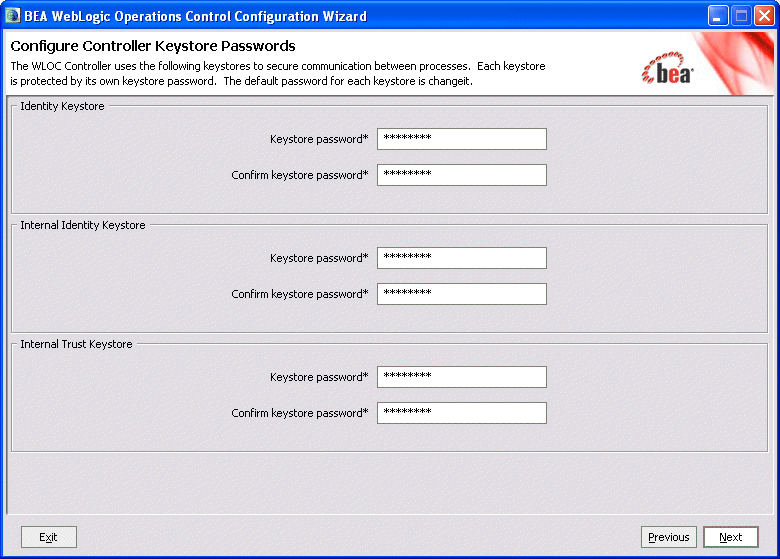

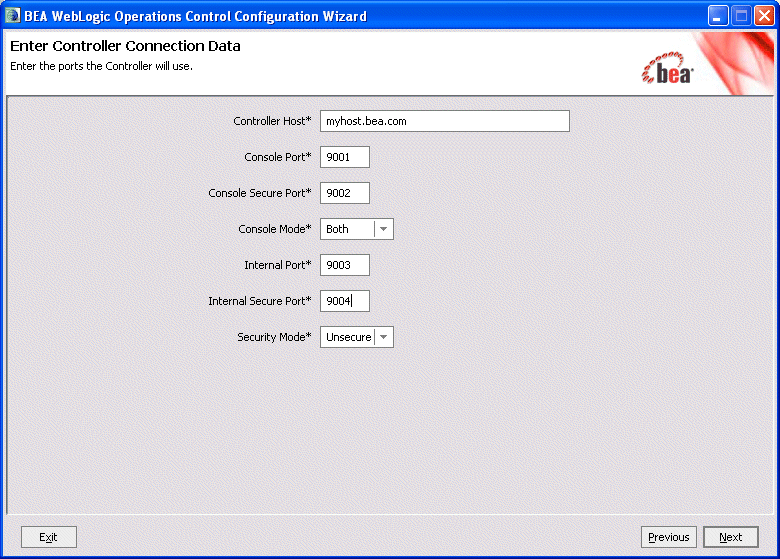

After you install the Controller, you configure it using the WLOC Configuration Wizard.
Although you can install the Agent and the Controller on different physical machines, in this example, the Controller is installed on the same machine as the Plain Agent.
Use the following steps to install and configure the controller.
The Controller is installed as part of a complete WLOC installation, or can be selected individually using the Custom installation option. For details about installing WLOC, see the WLOC Installation Guide.

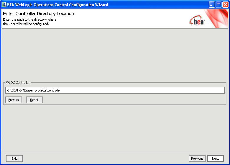

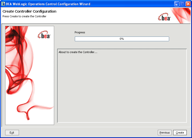

To create the Controller, use the WLOC Configuration Wizard and complete the following steps:

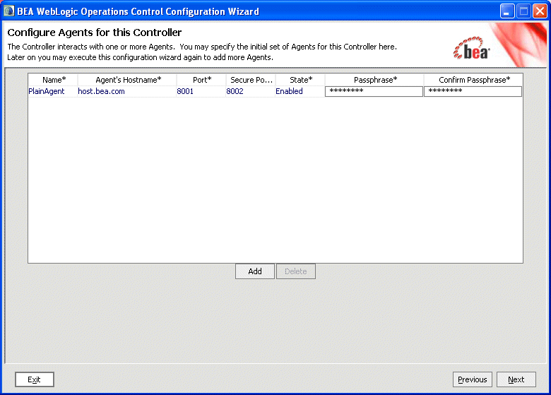

The fields are populated with the default data for your machine. Enter the name PlainAgent name in the Name field, accept the defaults for the remaining fields and click Next.
After completing the Controller installation and creation, the following directory structure is created in the C:\BEAHOME\user_projects\controller directory.
Table 2-2 describes the contents of these directories.
When you create a Controller using the WLOC Configuration Wizard, the configuration is persisted in an XML file named loc-controller-config.xml. In this example, the file is created in the following directory:
BEAHOME/user_projects/controller/config/loc-controller-config.xml
BEAHOME is the BEA Home directory containing the WLOC installation, and controller is the name that we specified for the Controller Directory location in the Configuration Wizard.
After you have created the Controller using the Configuration Wizard, it can be modified using the Administration Console or by directly editing its configuration file.

<?xml version="1.0" encoding="UTF-8"?><loc-controller xmlns="bea.com/loc/controller" xmlns:loc="http://bea.com/loc">
<network>
<loc:host>host.bea.com</loc:host>
<loc:components>
<loc:component>
<loc:name>Console</loc:name>
<loc:description>Console</loc:description>
<loc:port>9001</loc:port>
<loc:secure-port>9002</loc:secure-port>
</loc:component>
<loc:component>
<loc:name>InternalCommunication</loc:name>
<loc:description>InternalCommunication</loc:description>
<loc:port>9003</loc:port>
<loc:secure-port>9004</loc:secure-port>
</loc:component>
</loc:components>
</network>
<console-mode>BOTH</console-mode>

<agents>
<agent>
<host>host.bea.com</host>
<port>8001</port>
<secure-port>8002</secure-port>
<state>Enabled</state>
<password>{Salted-3DES}8kenEcTMhnFzQI/LXLZeMQ==</password>
</agent>
</agents>
